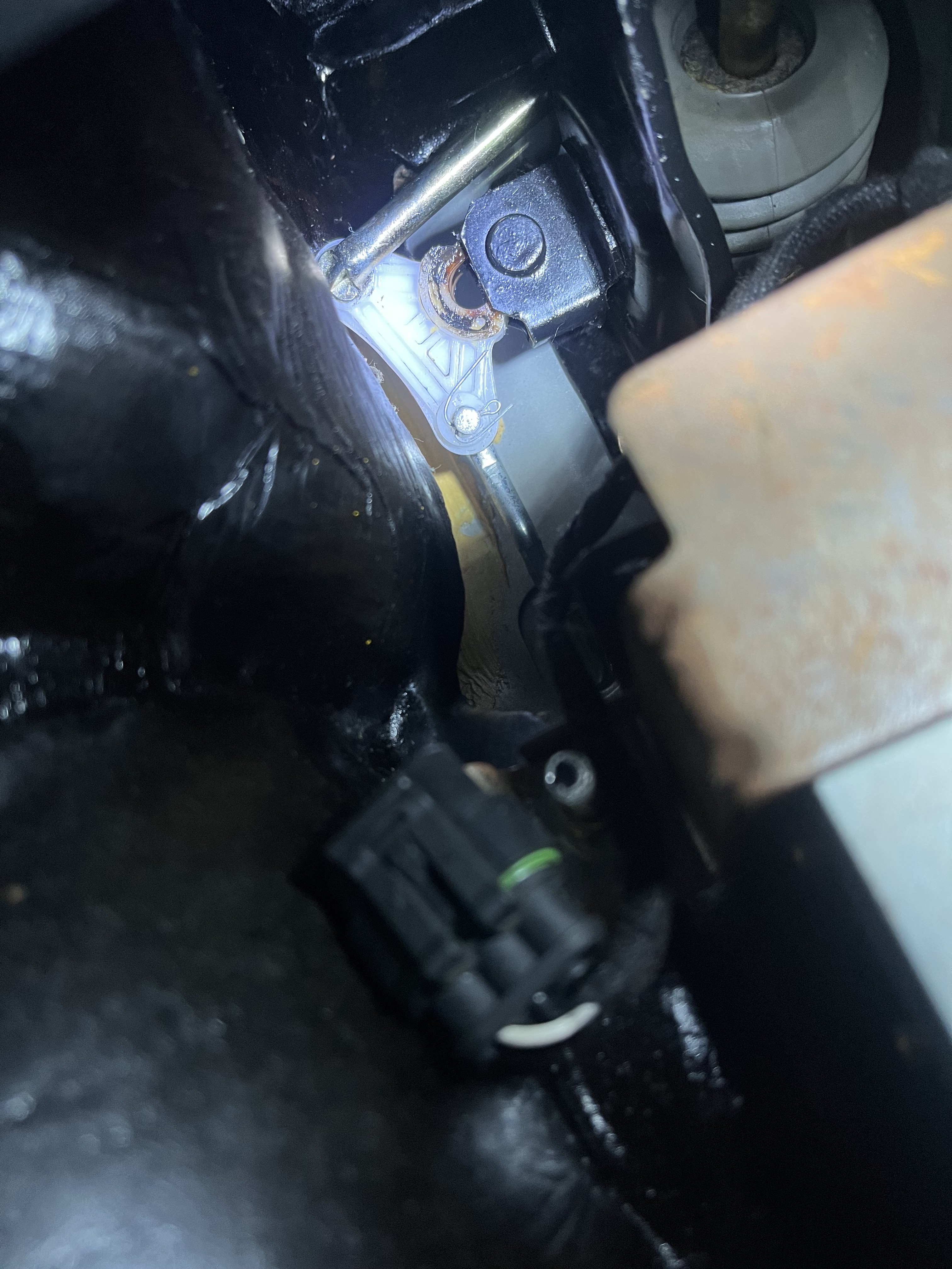

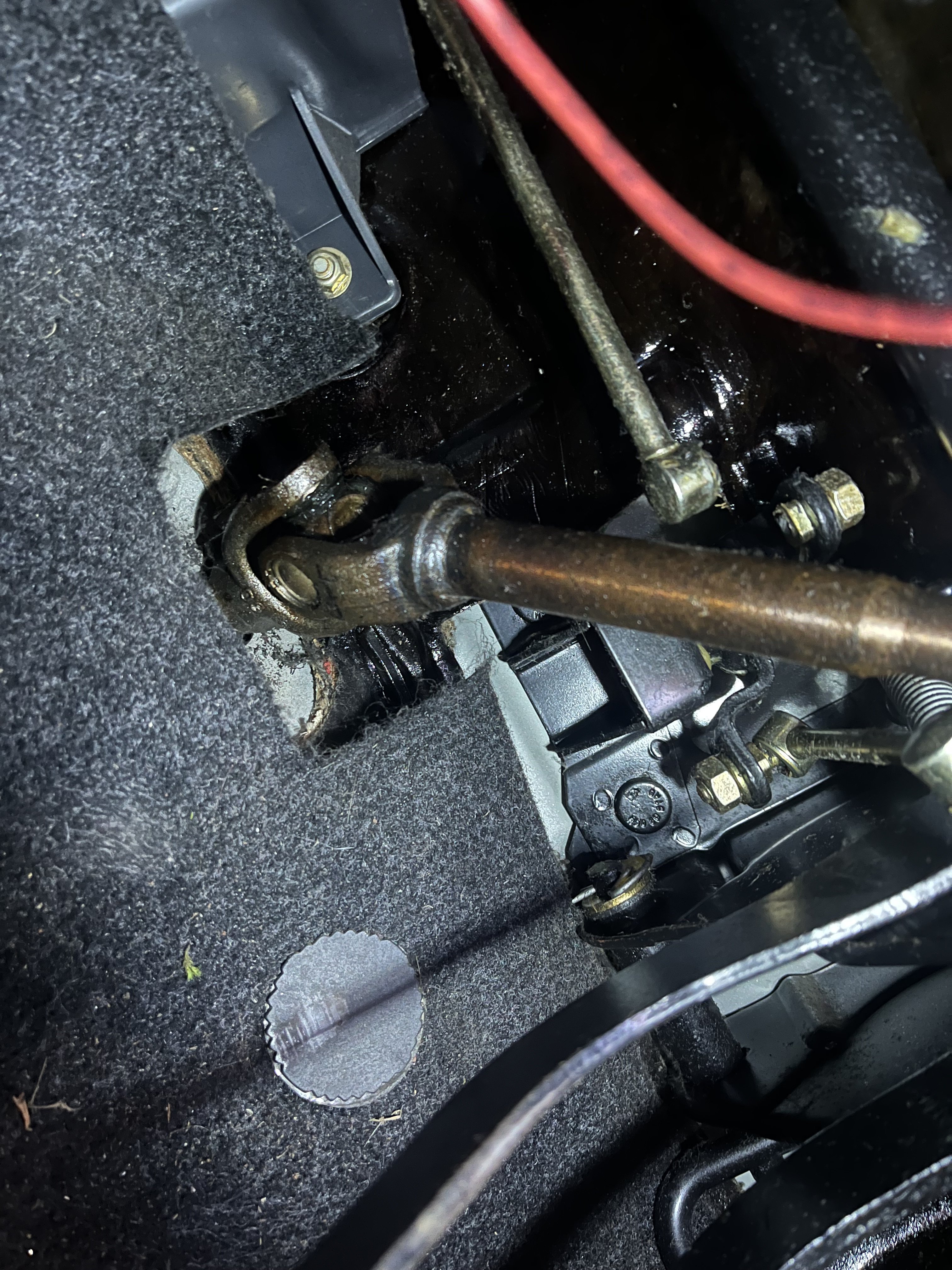

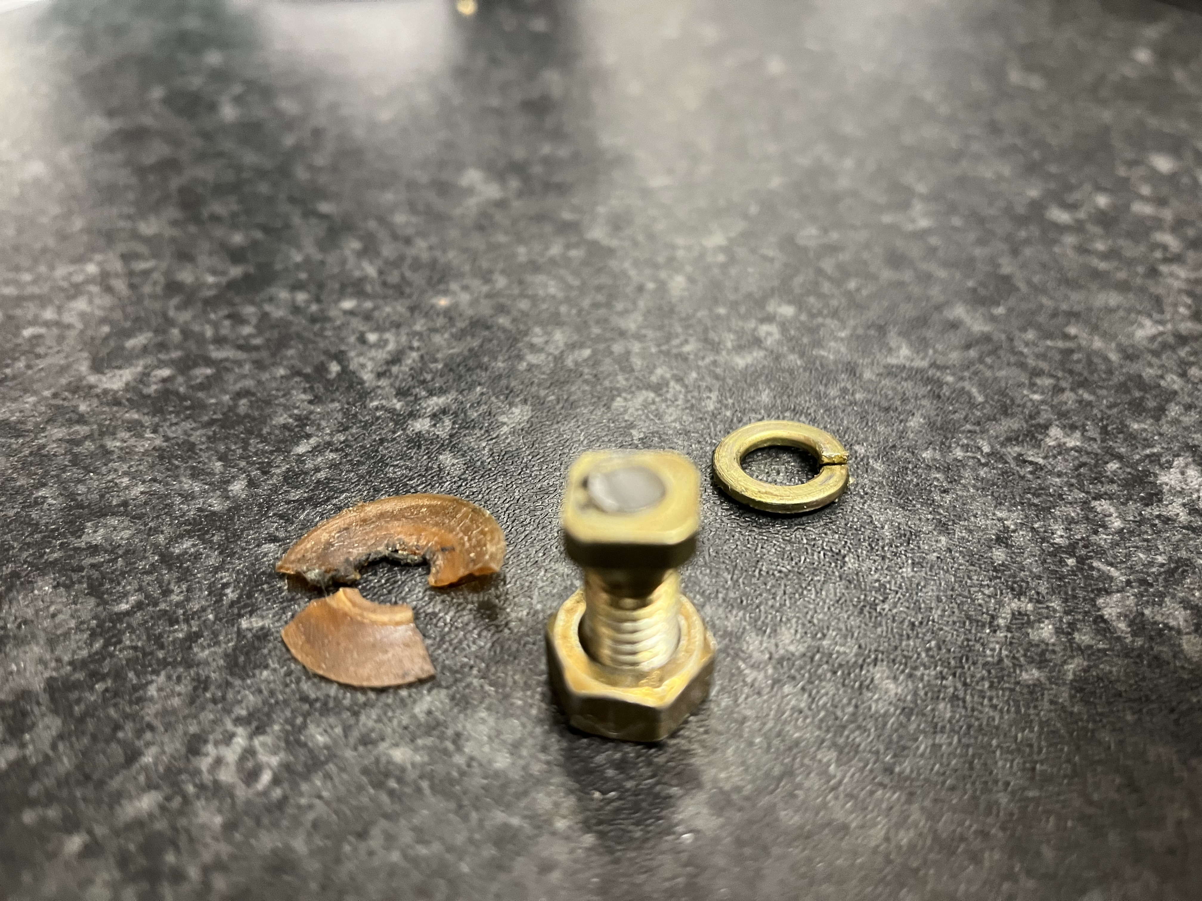

Coolant temp sensor was mentioned in the first post and has been changed. Turns out, after investigating this morning, the “clutch cable” that just snapped on me is not the clutch cable. It’s the joint on the rod behind the pedal that runs along the bulkhead. Why do I feel like this car is trying to test me this year? 🤪

I didn't see that in the first post until I looked just now 😂, I've never seen them break there before usually it's the quadrant snapping or the cable snapping on the hook end
