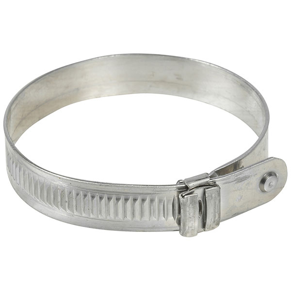

No, not Ezyclik as I can find pictures of. It's this design.
Various instructions (including some found on here) advise removal by levering up the two side tabs, followed by the same action on the open end of the underlying tab. It worked, though as said there was restricted clearance for such leverage, especially as the clip had been mounted with the tabs nowhere near the top..
Thanks for photo. I understand the problem. In a similar vein, earlier ths year in preparation for other work, I replaced four difficult to remove clips in the vicinity of the intercooler. Replacements were stainless steel, worm drive type. The heads are now positined for easy access.
