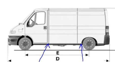

okay... so all points to the sealrubber of the door? Question about the metal construction of the ducato. I've welded shut some rotting spots about 2 years ago (see pic.) and the one under the door is 'sweating' water since I've noticed the leaking that wets my safetybelt. Is the space behind my safetybelt a vertical corridor thats end in a horizontal bar that runs at the length of the car or is it a compartimented space in the bar where water can bottle up at the right endspot of the doorway?
On my vehicle [2014] i had a draught up by my right arm , thought it was the doorseal , but then checked under belt cover and could see daylight straight down [ must be tolerances all being wrong when the robots assemble the shell ] so i sealed with spray foam , result ..!!
I dont think water can seep along the sills from there as the rearward section is blocked off and blind .
