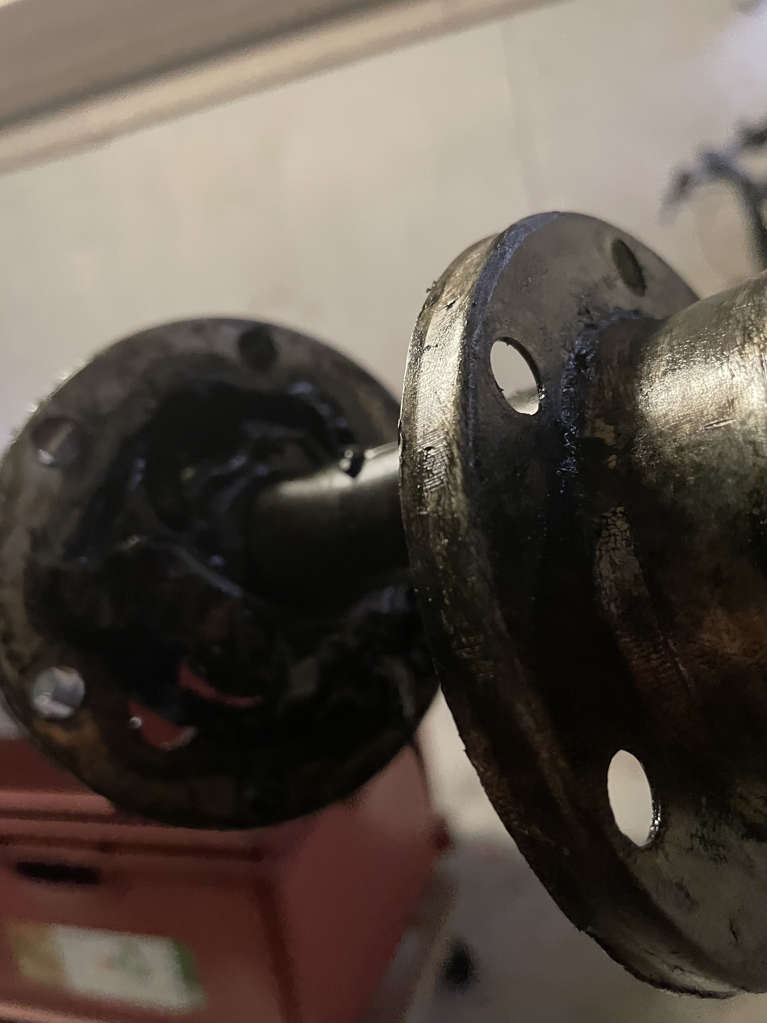

I did think this might be a solution. But there was no lack of grease ;). Definite scoring on the inside runners once everything was cleaned-up.
I'll try to keep this documented.
grtz ER

Thanks ! This was seriously well-greased. No visible sign of metal in the grease. Scoring (blacking on high-grade steel) on the inner-runners. It just fell apart in my hands, which I think only happens when it's worn out ?
grtz
