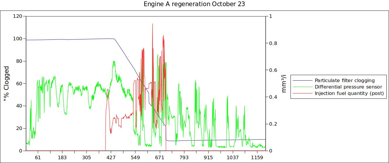

Ive been using Multiecuscan for a while now and along with my monthly blast up and down M1 have been doing health checks. Taking reading of various PIDs under standard conditions. I came across a measurement that tells you when regen is occuring (Injection fuel quantity (post). Additional fuel is injected durring the exhaust cycle. I have never been able to tell when a regen is occuring normaly, this is obvious when you see the step in 1st graph this is 2 data sets stitched together (just pulled off motor way to layby stop recording save and start again (running on laptop battery). I only realised when i looked at data.
I suspect the 100% clogged number is not a real x grams of stuff and theres no more room but the limmit for passive regen. there will be higher clogging limmits that prevent forced regen.
Effect on differential dpf sensor
The temperatures on way up.
I use the same route each time. home to layby near junction (warm up), blast (cruise 60-63) two junctions up and back to layby then home.
