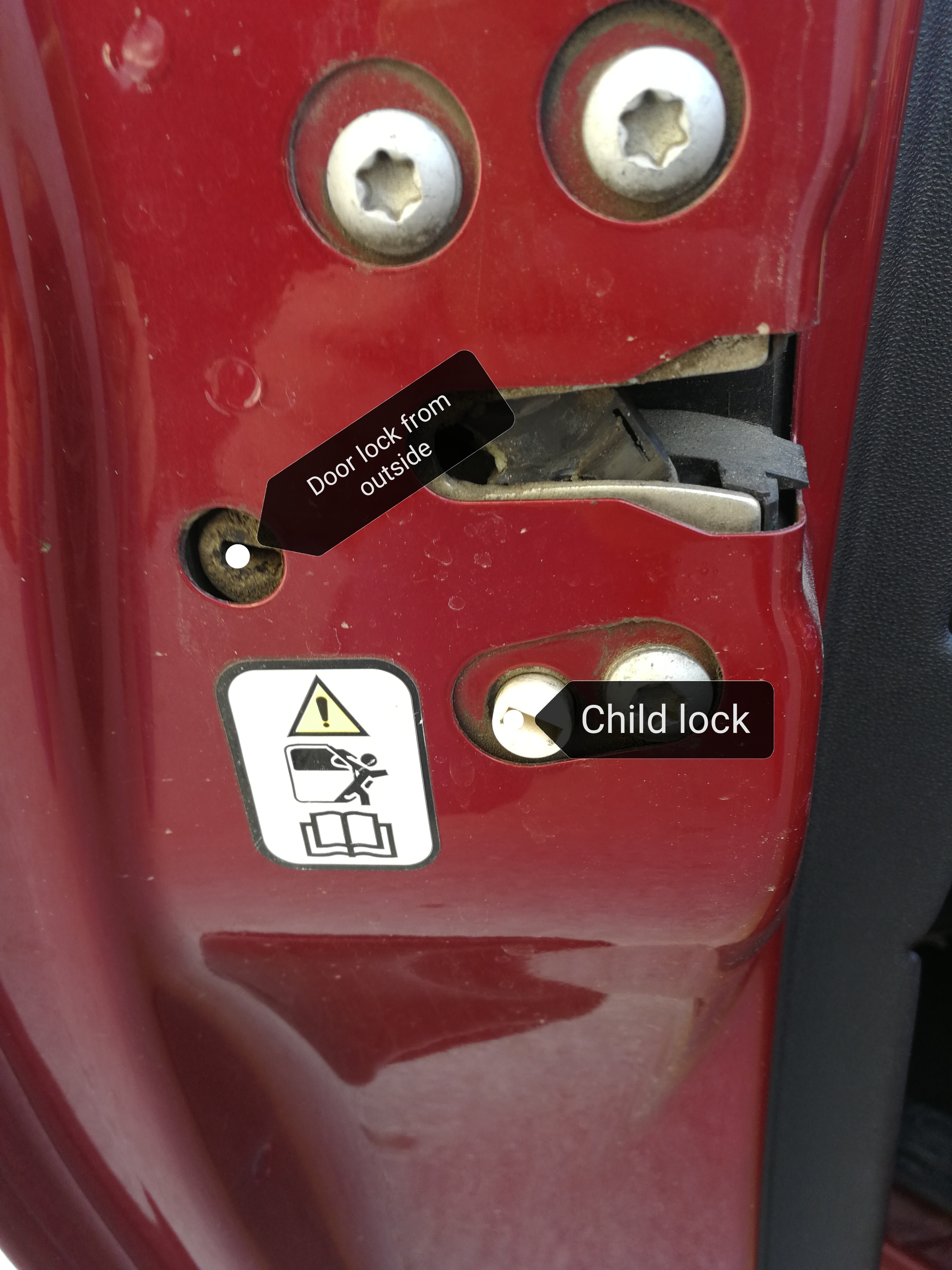

I'm electrician too(Automations and little-known electronics). The Luggage compartment works just fine!! . The doors lock mecanically from here(see foto)and if I lock them I can unlock from anywhere!! the coils work and the doors unlock. I try all with battery and the key nothing.the car electrician here told me that maybe it's ECU problem. No way!! because when the problem starts I was inside the car and the car go to lock automatic at (20-30km)that moment I hear one (door lock-coil) to make noise 2-3sec strangle to close (like as you have a relay and stay in the middle)something like that.and from that moment doesn't lock again.Now,i notice a small click! when I try to lock, at drivers door. So that's, the Luggage compartment and the lock light (when I lock stays on) told me that the order from the ECU it's ok and the car thinks that it's lock. I will open tomorrow the drivers door to see it. I think the drivers door give order to all other doors and the ECU give only to drivers.if I had the Wiring diagram it will be much easier for me.

The picture you sent me is called a child lock, which prevents the doors from being opened from the inside by small children.💡If you don't need it, please see the manual to change the position so that the lock can be operated manually with the door handle.

I watched some videos the fiat 500 have the handle lock. On my bravo the handle have stop and does not go in, and there is no manual lock inside. I'm 95% sure that the problem is on driver's lock.

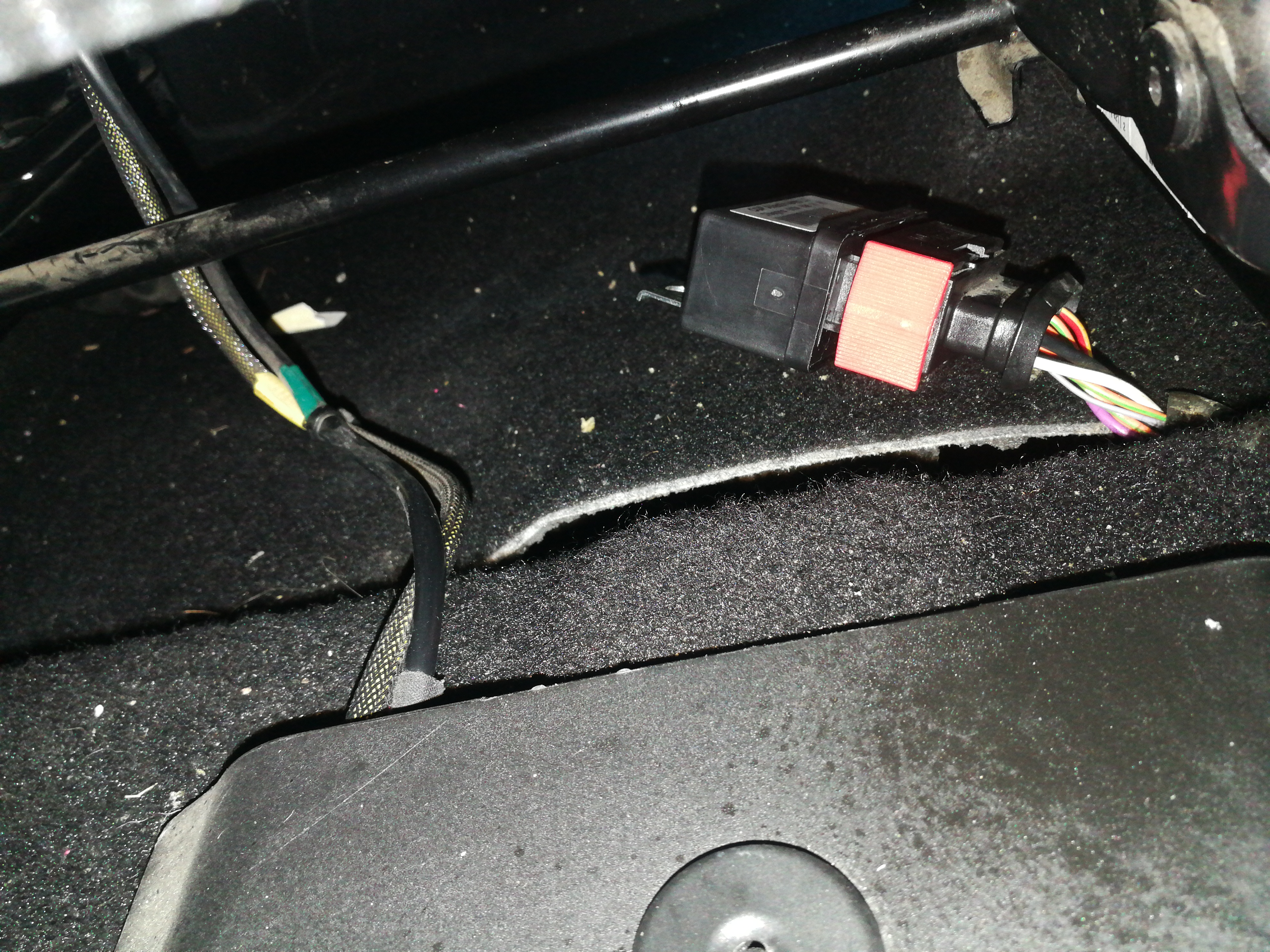

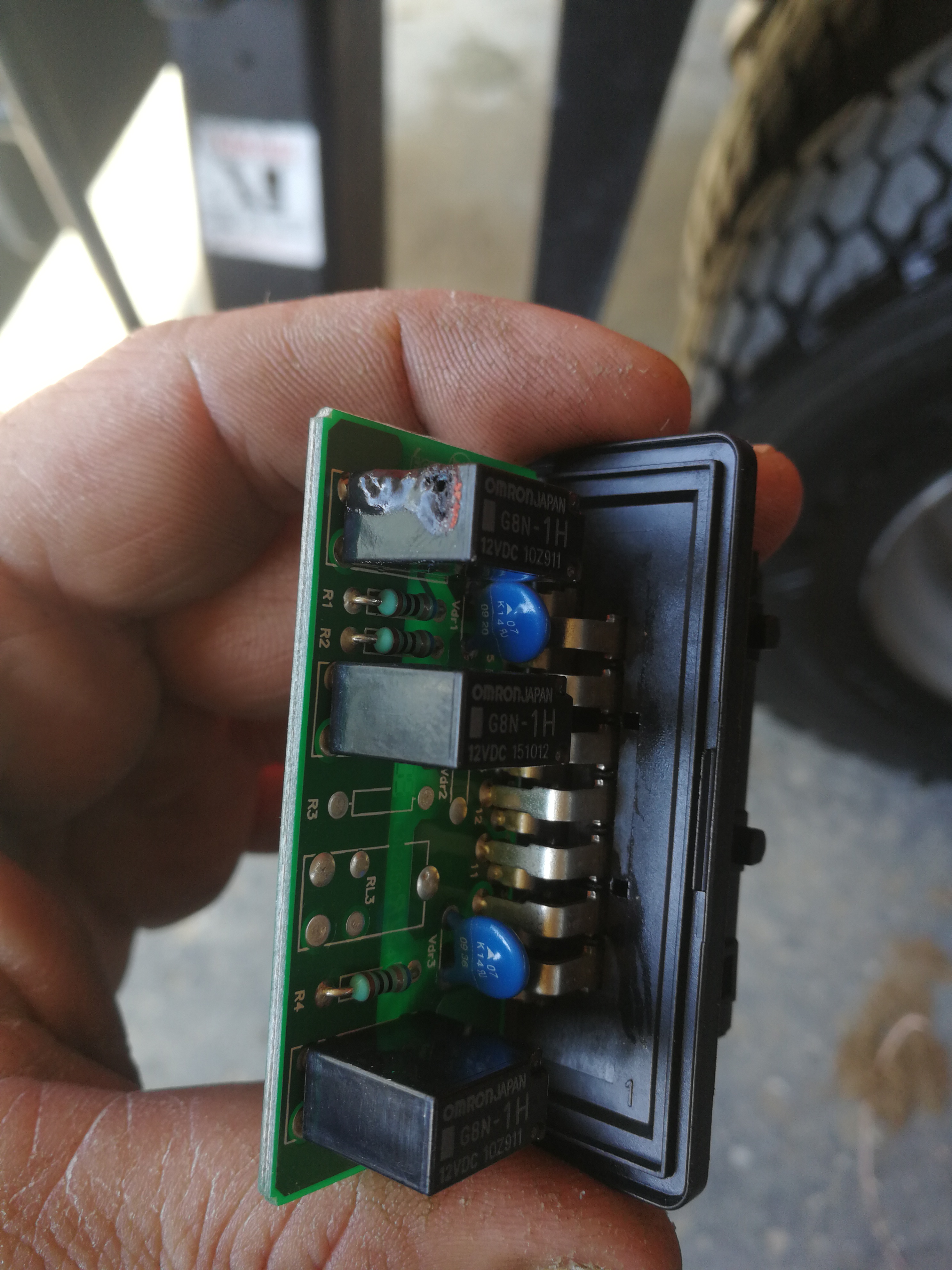

I order new relay( omron g8n-1H) 2€ the piece and I will change it myself. The immobilizer board sent the order to the relays( cgp allestimento l3) . The relays are under driver's sit (see foto, I have it out for change the relay. Normally it's under the carpet.)the 3 black on second foto it's the relays,one for close one for open and one for the Luggage compartment.the relaysboard is very simple have filters, relays, and 3 resistants.

I order it from ebay(1week from China) I'm electrician so for me it was very simple.
You can see how you can change a relay on YouTube but I will told you not to try something like that for first time!!
I say this because if you heat the pins too mutch you probably will damage the circuit board
better go to someone who have the tools and he have done it before to change it.
for someone who have done it before it's not more than 5 minutes job.
Hi Marios, how can I reach the cpg allestimento l3? Do you have something to check how to remove the carpet? Do I have to remove the seat before? Thanks!
