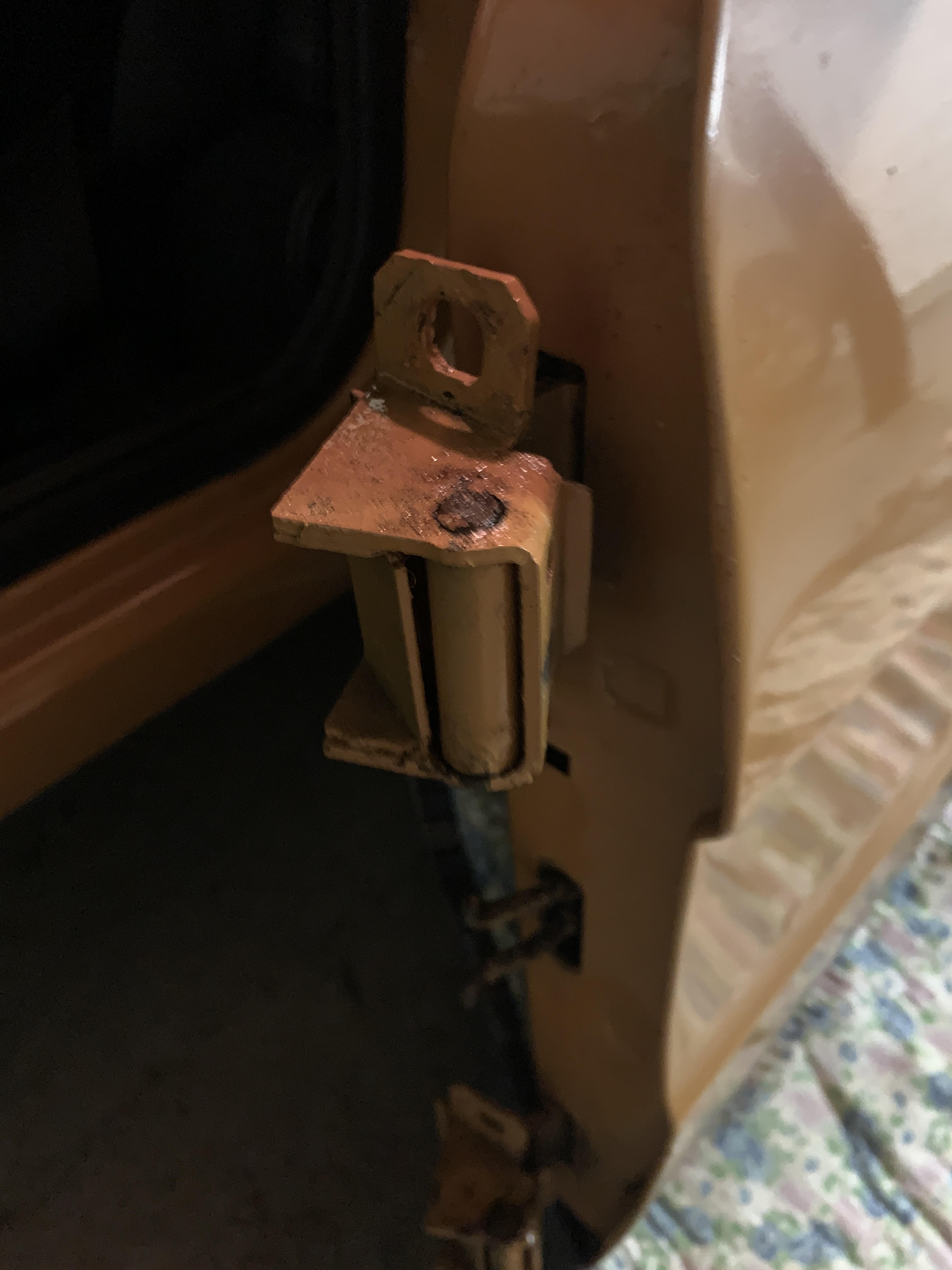

Apology time :eek:
The info I gave above was for other Fiat models e.g. 850, 124 etc which use heavy type hinges made from 6? mm plate which have the hinge pins locked in place by swaging. So I think you can disregard most/all of my advice.
Looking at the link you've provided, I see that the 126 uses a much lighter construction type of hinge.
Hopefully, you'll be able to fit the pins you've bought without as much aggravation as I've experienced on the larger Fiat models.
Sorry for any confusion I may have caused. :(
AL.
That's the thing... I think you may actually be right about how the hinges are on my 126. That's why I am unsure about the replacements I bought. The replacements come with the bushings and a smaller pin. What is currently on the car seems to be a larger pin with no bushings. I will get a clearer picture tonight and add.
