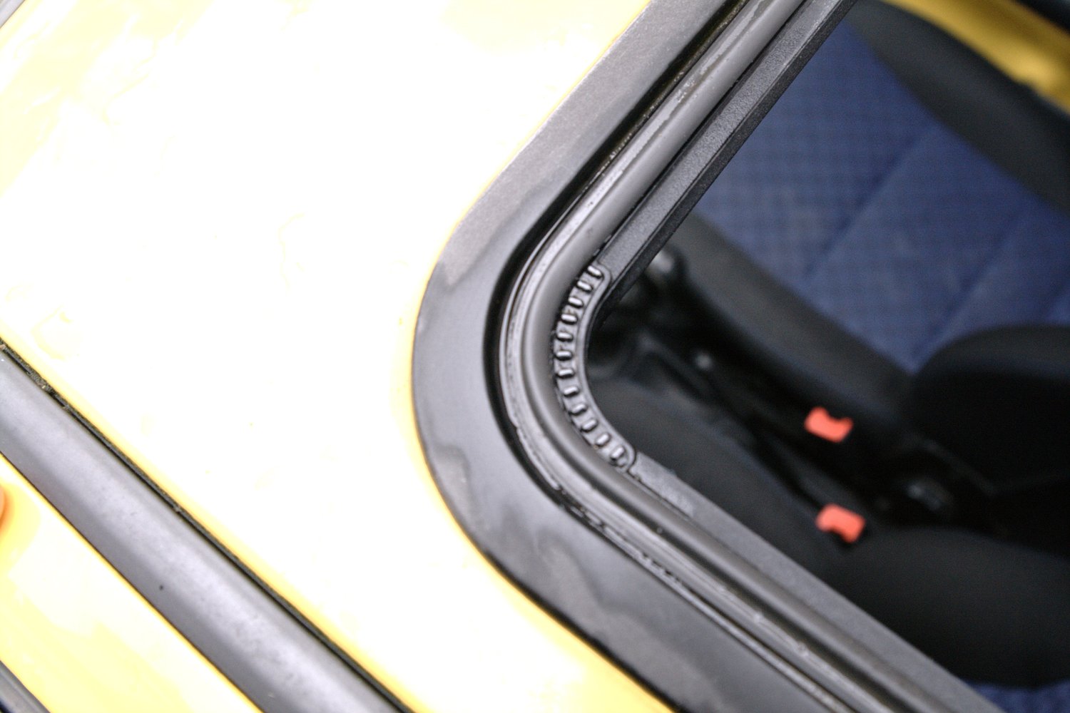

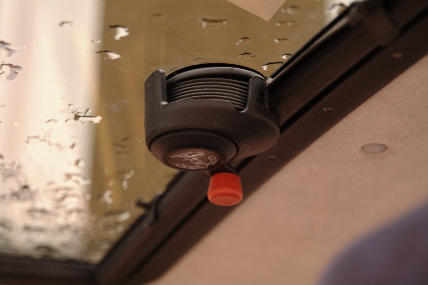

Attached are some photos of the sunroof, in order: First, the opening spring, the sunroof opened. (Is this a standard Seicento sunroof, or a "dodgy dealer" one? :))
Then the rear-corner and front-corner (with the sunroof out). From the descriptions here I would guess the drain-holes should be there, but I can't see any. Are they under the rubber-seal?
Finally, a picture of how the thing doesn't really close properly. This has also gotten worse I think, even doing 40kmh on the way to work today made a the wind sound like a cheap horror movie soundtrack.

Hi
That looks like a post factory fit.
The factory sunroof fits into a deep pressed depression in the roof and the drian holes drain from this depression.
There is an outer seal and an inner seal and the drain drains water that might by pass the outer sea, so the inner seal is not troubled.
Your sunroof probably does not use drains, but relies on a 100 % outer seal.
You might have to take it to a sun roof specialist.

on the standard sunroof, if you remove the headliner, there are some plastic pipes on each drainhole. Rear ones go down b-pillar and just drips into the void behind the plastic trims under the windows in the back. Front ones go down the a-pillar a drip into void between the inner and outer arch.
You could spend an age trying to unblock drainholes, but by removing the headliner you can remove the actual pipes pretty easy, either replace the pipes with new or unblock off the car, its alot easier ;) Hope this helps anyone that has this problem.
Edit: Both times i have removed a headliner the drain pipes have been clear so blockages are easy to find..
To the OP, i shouldn't think it'd be hard to completely remove the sunroof on your car, clean up all surfaces and refit with plenty of sealant. Should be easy enough and not cost much. If you still have leaks then it will be time to go get a new one fitted professionally.
