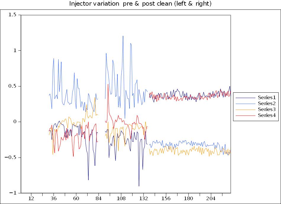

I will only comment on my vehicles both "modern" a 2010 skoda fabia 1.6 CAYC Engine and a 2017 Ducato. I monitored the Injector variances before and after cleaning with liqui moly diesel purge Injector cleaner. The skoda results are below the Ducato has better results on 3 Injectors but tother is dodgy? So I think it does clean Injectors but it is intended specifically for that. There are other products in the range with simular names
