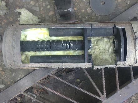

Packing coming out of the tail pipe is very common even on new back boxes, small bits are of no concern, in fact even if all of it comes out it will not be much louder due to the internal baffles
No it doesn't suck water into the engine if the tail pipe is submerged, I have driven a Punto 1.2 with the tail pipe submerged and water over the sills
There is absolutely no risk to the catalytic converter

I am saying fiberglass coming out of the tail pipe is common, and causes no problems there hundreds of thousands of cases
It's almost a feature of the trailblazer even from new

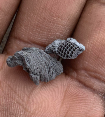

You do get bits of CAT in the back box or exiting the exhaust
