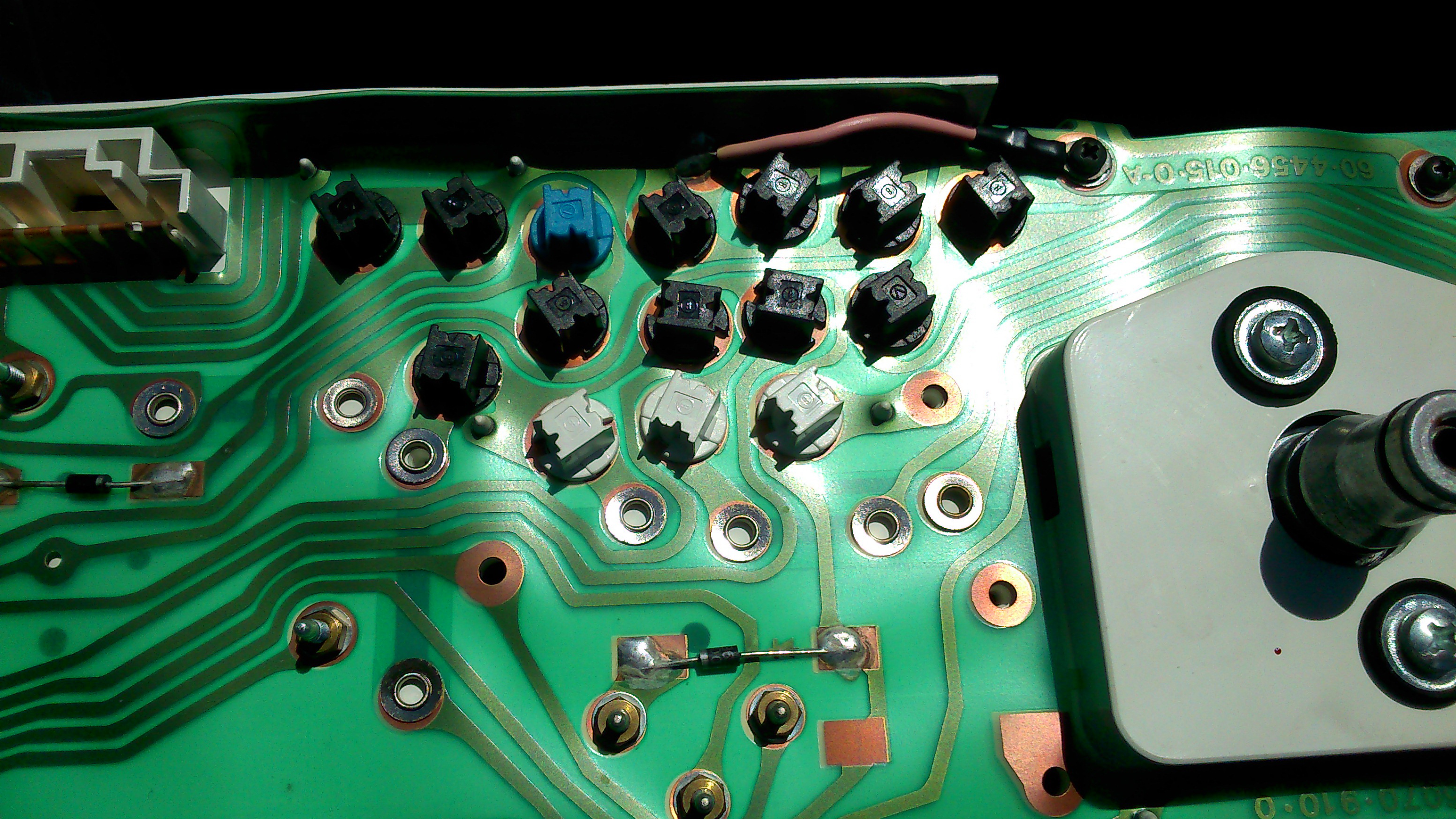

I recently replaced all the bulbs, about 20 pieces for 12v 2.0w
(my old DGT had 39 bulbs!)

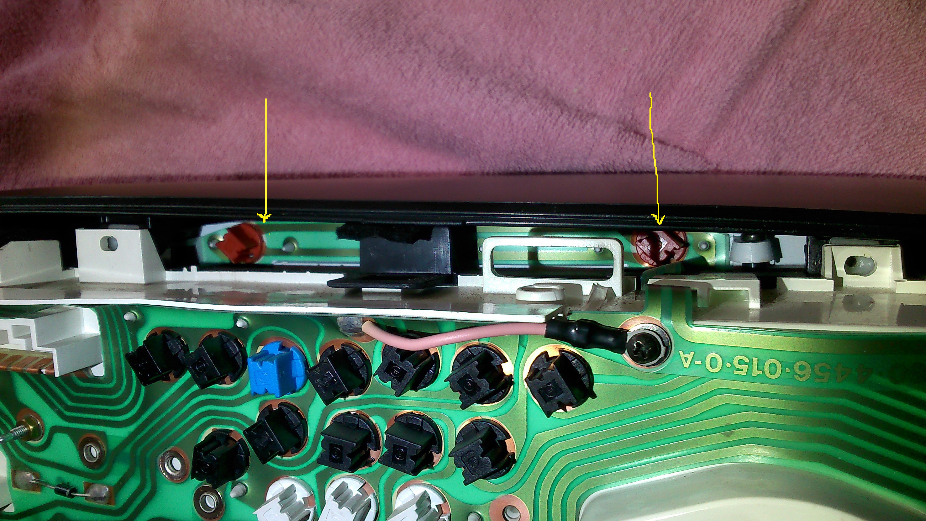

It looks much better at night, especially when I found out that there are 2 "hidden" bulbs which normally you look over them, if you do not know you'll miss them like me and have to take the dashboard out again...
Some tips; The electrical wire plugs can be stuck like hell.
Take great care removing them. Don't forget to pull back your speedometer cable (from engine compartment) when you are finished otherwise you may have a vibration on the speedometer needle.

edit: When removing the wire connectors from the dashboard, push / hold the printed circuit met one hand tight to the dashboard and with your other hand remove the connector.
If you do not so, you will end up with a loose connector which has still the printed circuit attached to it.....
Tip: Before I put the dash back I tested if all the bulbs were working. Just put 12v on the printed circuit "around" the bulbs plus and minus.

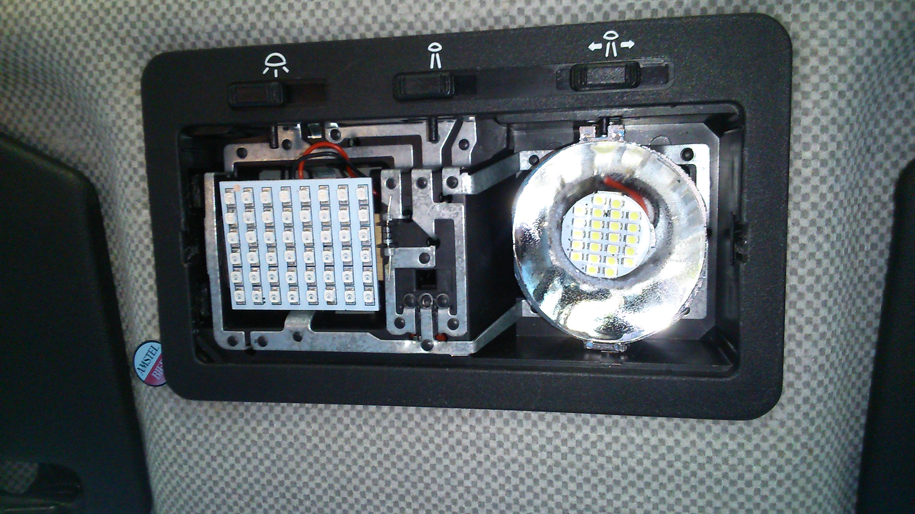

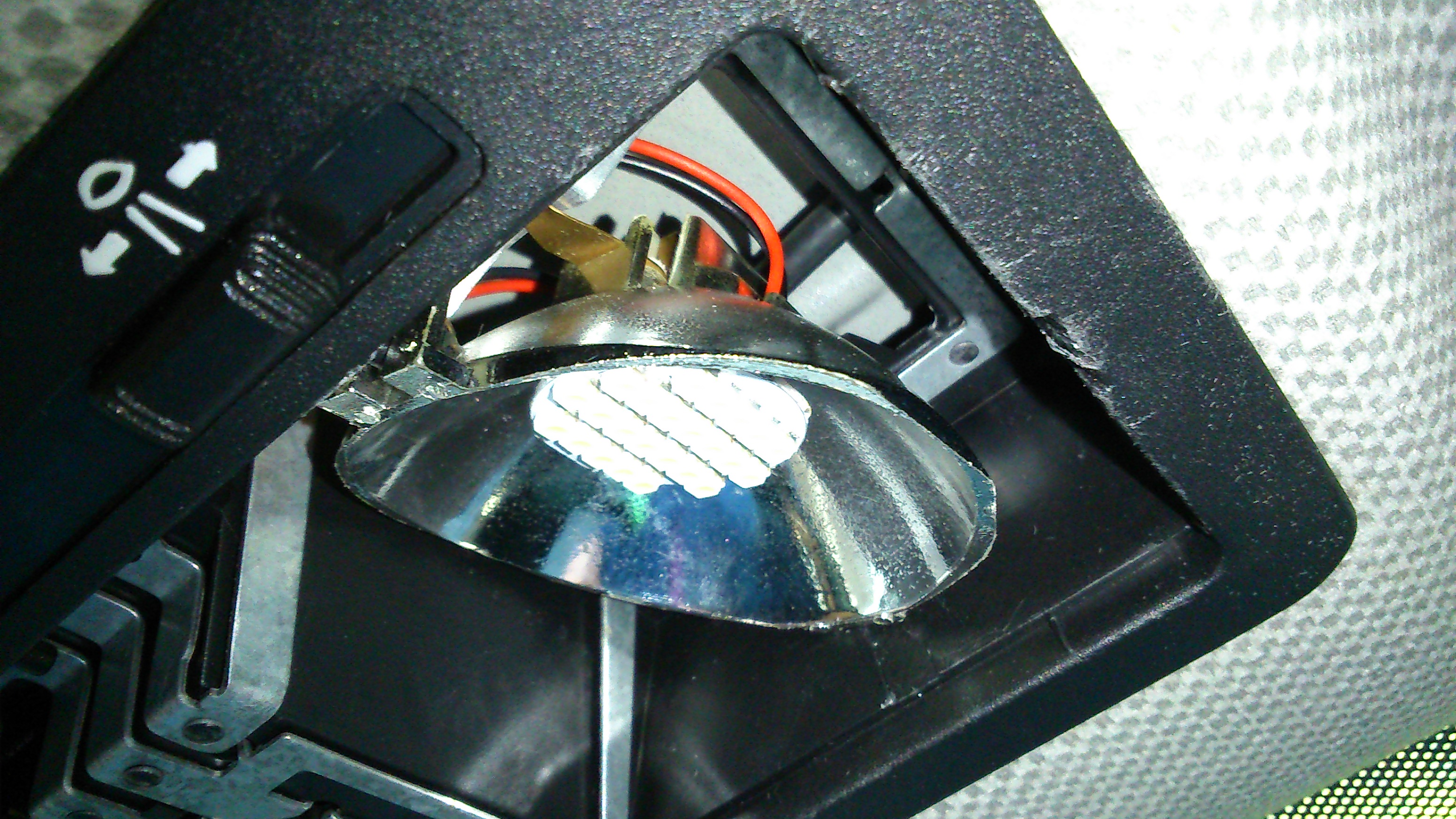

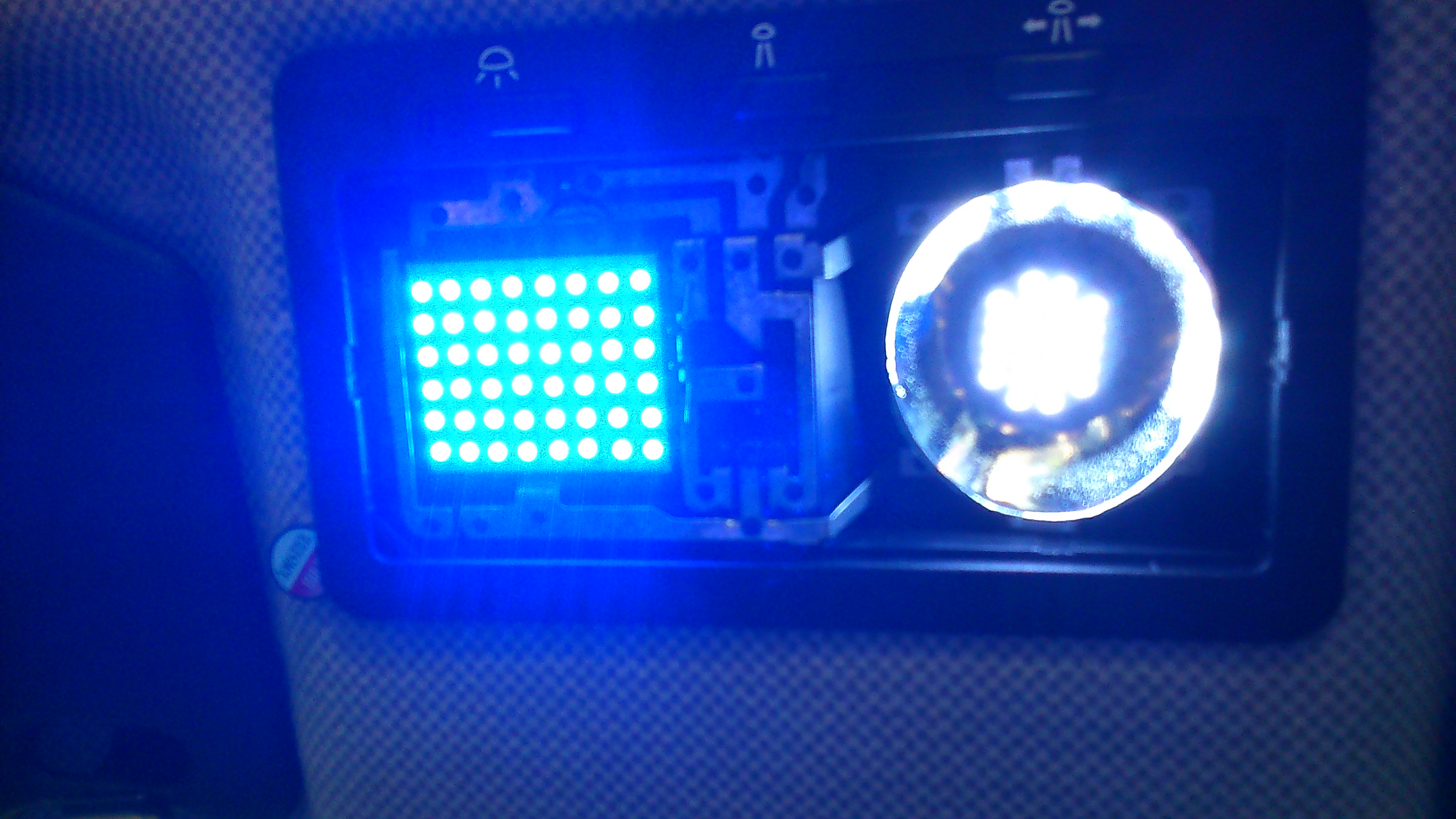

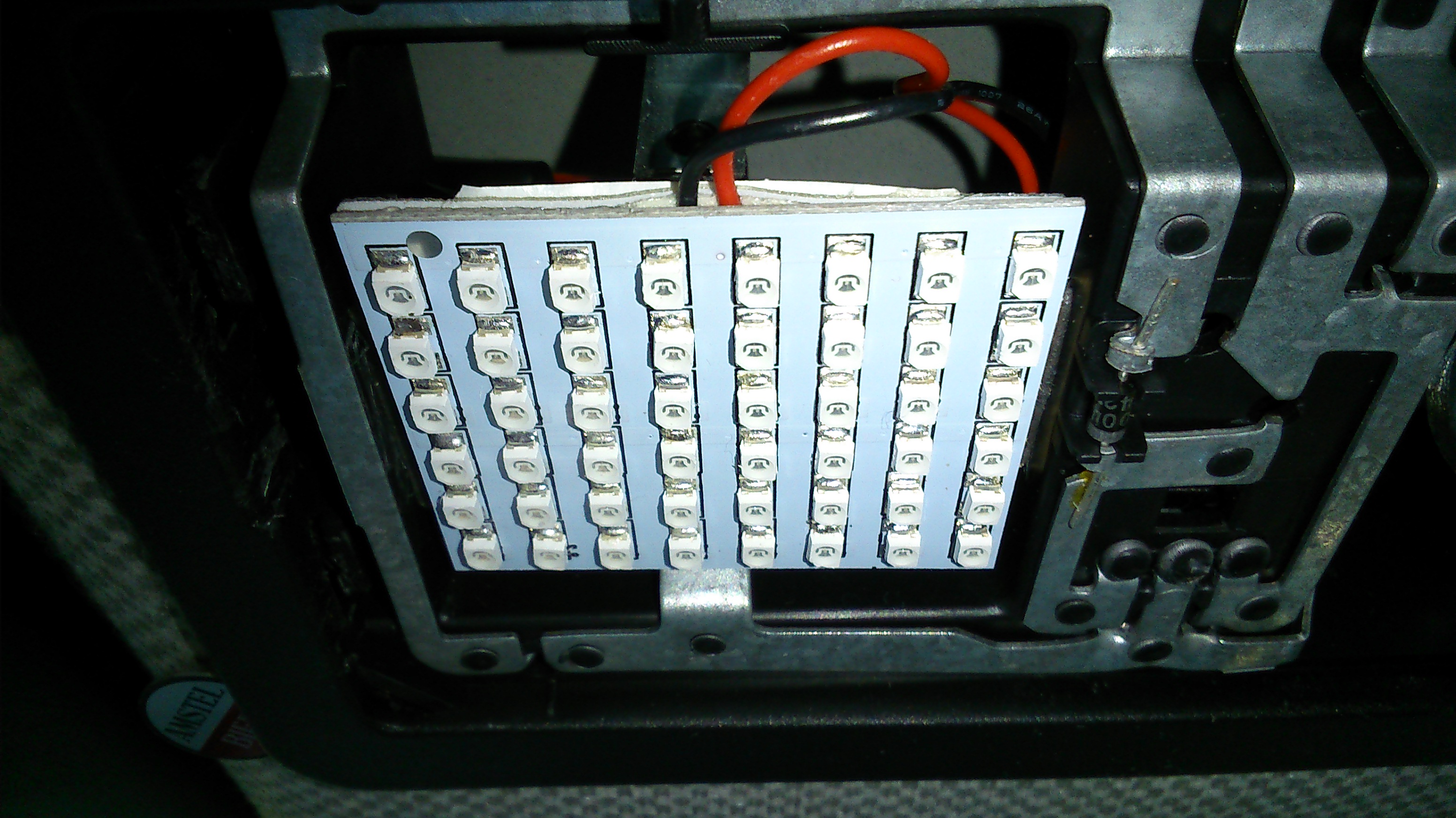

Why not LEDs? I was planning to buy them for my Tipo
The only led's you can put in is hand glove compartment, The roof panel light and the trunk light.....
Believe me, I'd tried them all, reverse light, Taillights, Headlamps, with canbus and without canbus (checkpanel!) etc., and I strongly advise you not to spent any money on it...
(I allreay did...., it's a waste of time and money! :(:(:(

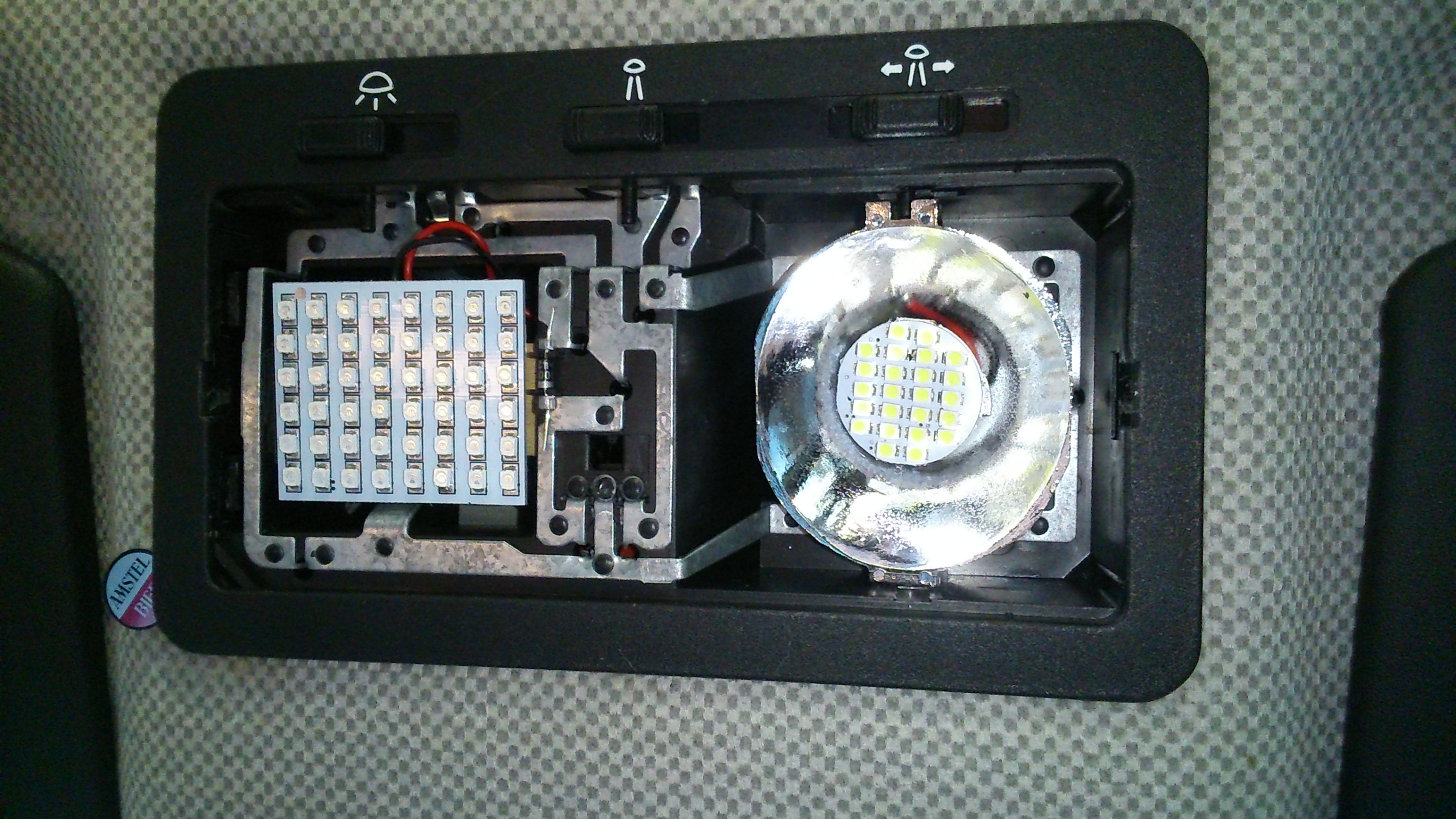

edit: some pictures attached: Led panel for a few euro's, I have them in green, red and blue. The reading lamp light is white, the interior light is blue (at the moment.....
In the trunk I also put a white rectangular led panel r.h.s. and left I replaced the original bulb for a bright white led one and of course also a new led in the hand glove compartment. I like to see the light! :)
