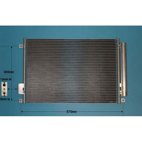

I was asked to look at a 59 plate black 1.2 with a variety of noised/issues.
One was the aircon not working very well at all. I looked through the holes in the bumper to find at least the bottom 10 or 12 horizontal bars flailing in the wind, it didn't seem to have any gas leakage just next to no surface are left, further up there were some but that's not in such good airflow.
