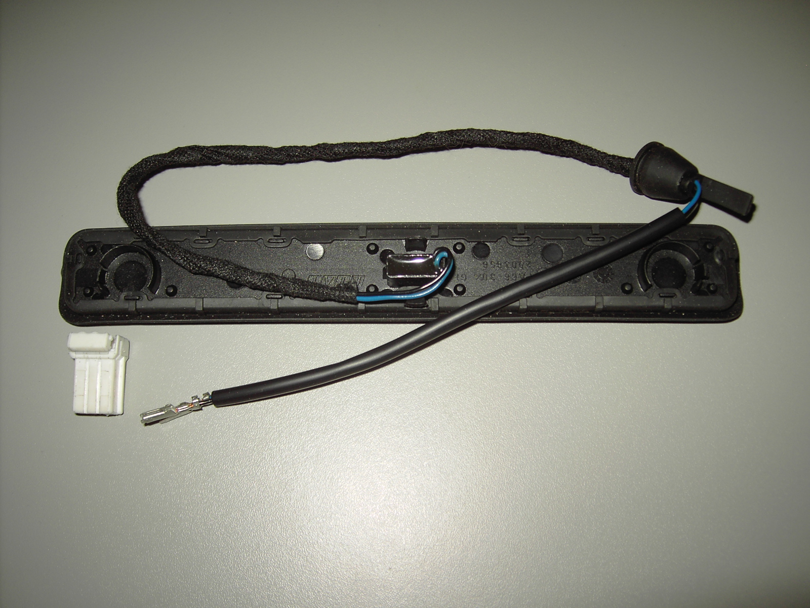

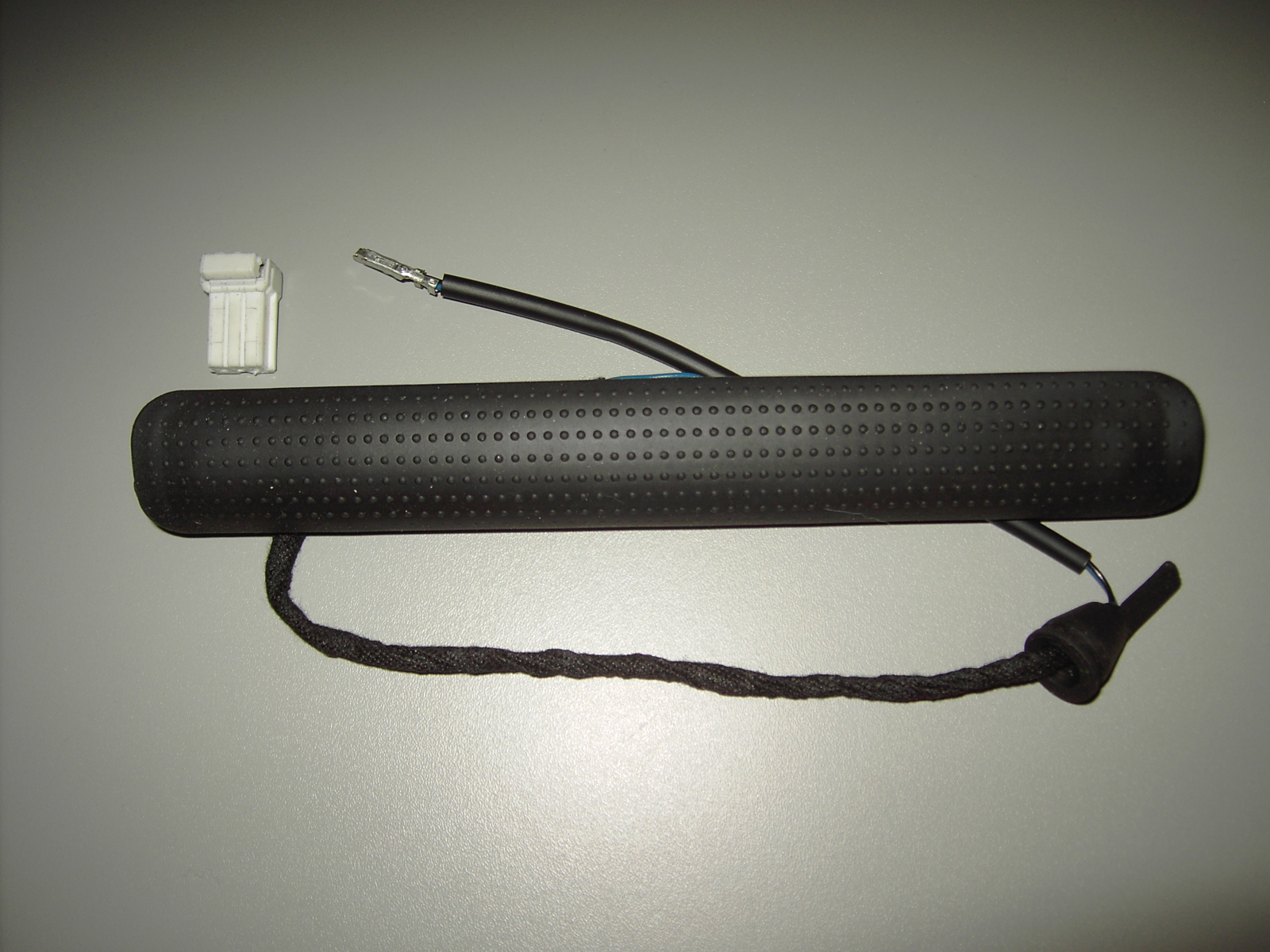

The actual switch is probably similar to the one fitted to the Stilo SW. In which case, it's a micro-switch encapsulated in potting compound behind the rubber button. You may be able to cut the switch out and replace it separately.
The Stilo SW switch and rubber button is available as a separate part, but not the Croma one.
