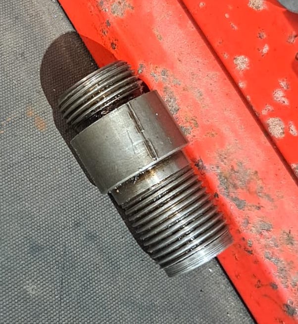

I have a Fiat Uno 1.4 70 i.e. and sent the car to my local backstreet garage for a service. I was told by the mechanic that he wasn't able to mount the new oil filter and it just spun in situ. For the time being, the old filter is back on the car but it needs replacing before too many more miles go on it. What are we missing?

Wrong filter supplied! They sometimes have the thread dimensions marked on the inside where it screws onto engine. It should be fairly obvious to the mechanic!
