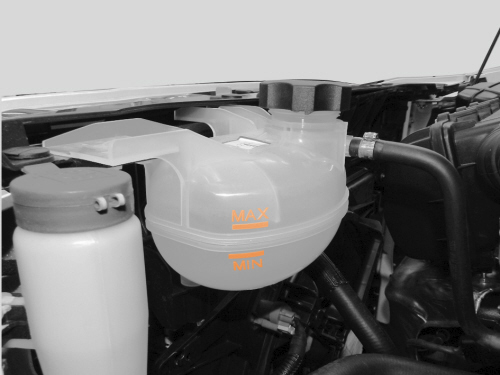

- With the engine cold, undo the engine coolant supply reservoir cap.
Do not remove the expansion tank cap when the engine is hot as there is a danger of scalding.

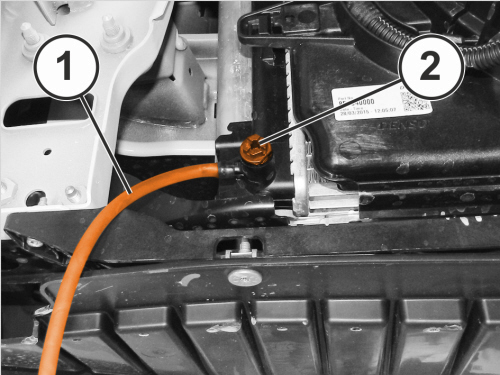

1. Connect a suitable pipe to the exhaust connector.
2. Loosen the band and disconnect the coolant outlet pipe from the radiator.
Collect the coolant in a suitable container.

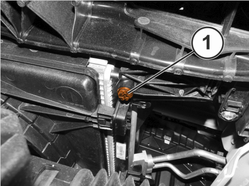

1. Open the bleed valve at the back of the radiator on the right hand side.

- Continue filling up until the MAX level on the tank is reached.
- Tighten the cap fully on the tank filler.

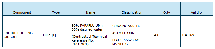

- At the end of the above operations, make sure that the amount of fluid introduced into the system is at least equal to the amount collected during the draining stage.
