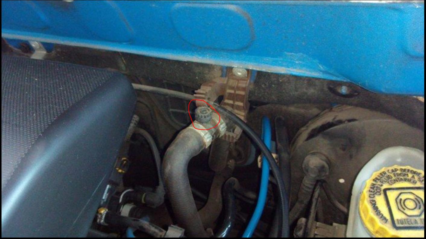

OK - pic in post#10 , https://www.fiatforum.com/panda/340612-blocked-water-drains.html
on the back wall , see a black plastic over with a "GRID" on it , to the right is a BLACK HOSE - held with a BROWN Bracket, that hose has the bleed screw in the short section between 2 x shiny metal hose clips.
Charlie - Oxford
cheers for that, i thought that was it and took a photo before you replied. have a look at the photo below just double checking it is the one in the red circle. as in the link you sent one of the posters says there is a fuel valve right next to it.
the only one i cant see yet is the one next to the expansion bottle but it is covered by a plastic trim (is it easier to remove this?)

Done! And yeah I realised that was where the spring went I remembered removing it when I did the air filter last month. Went very easy and smoothly actually,Few tips for anyone reading this to get those last bits out when draining pull the flexi hose down lower than the engine then Jack the left side of the car up to help push any last bits of fluid over to that side and again pull the hose down this helped me get about another 500ml out another tip, without the car jacked up gently rock the front right side of the car up and down the very last bits will slosh out. All in all I got about 4.2L out and the system only holds 4.6. Heaters get red hot and engine temp stays around 2 marks below the half way line so that coolant does seem to perform well!
