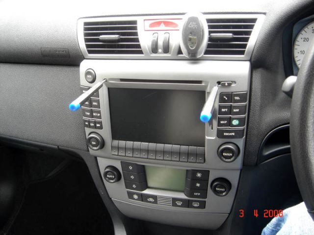

J johnh1954 New member Joined Sep 14, 2017 Messages 8 Points 5 Sep 15, 2017 #1 Hi can anyone tell me how to remove satnav/radio cd from stilo abarth please
Davren Moderator Staff member Uploaded 10+ resources/downloads Joined Jul 6, 2008 Messages 16,426 Points 3,932 Location London, UK. Sep 15, 2017 #2 johnh1954 said: Hi can anyone tell me how to remove satnav/radio cd from stilo abarth please Click to expand... Push 2 rods into the 2 holes as shown below, then pull the Connect Nav out. . Attachments Connect Nav+ Removal.JPG 43.8 KB · Views: 83
