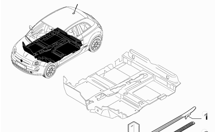

That's how the floor looks like in the same model:
It's not completely flat, but it would be easier to make it flat than with the seats installed.
