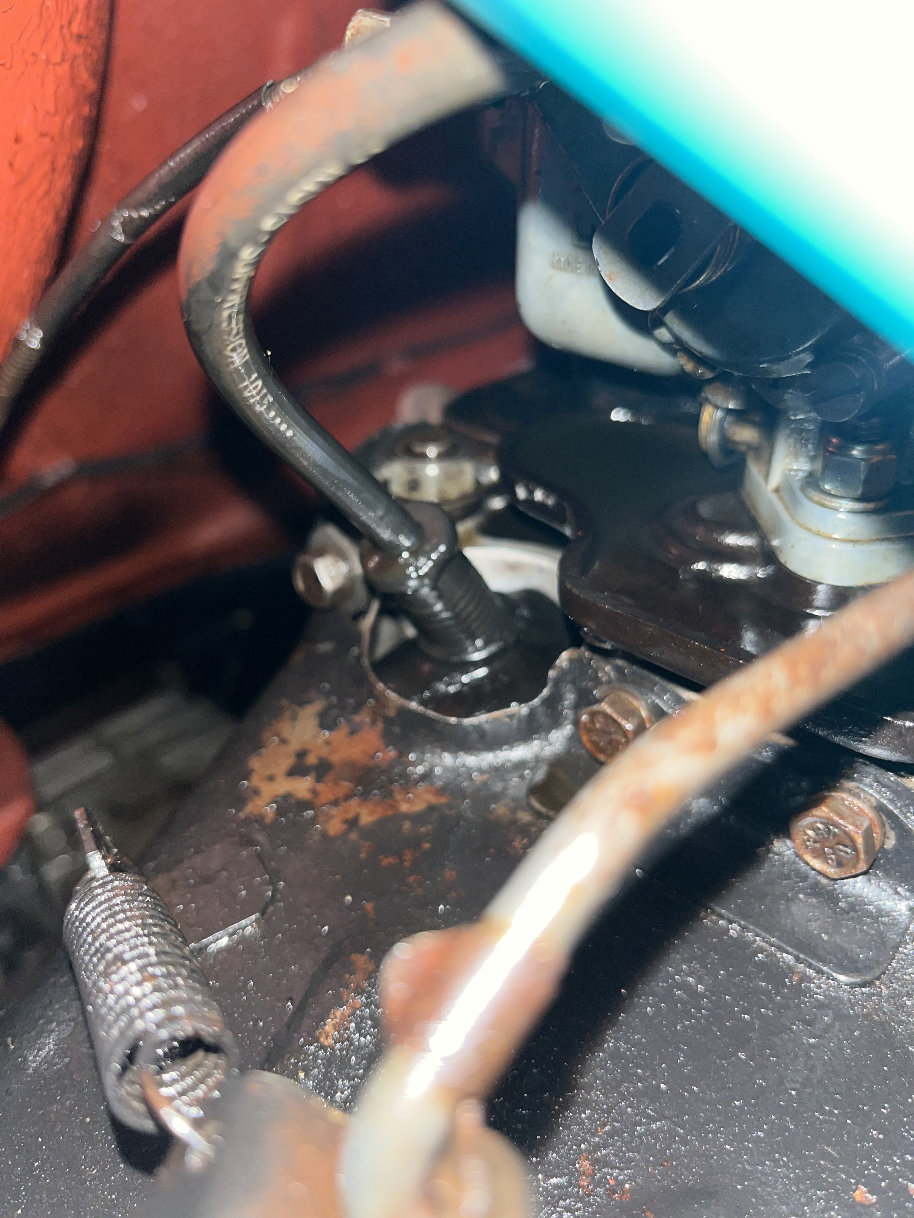

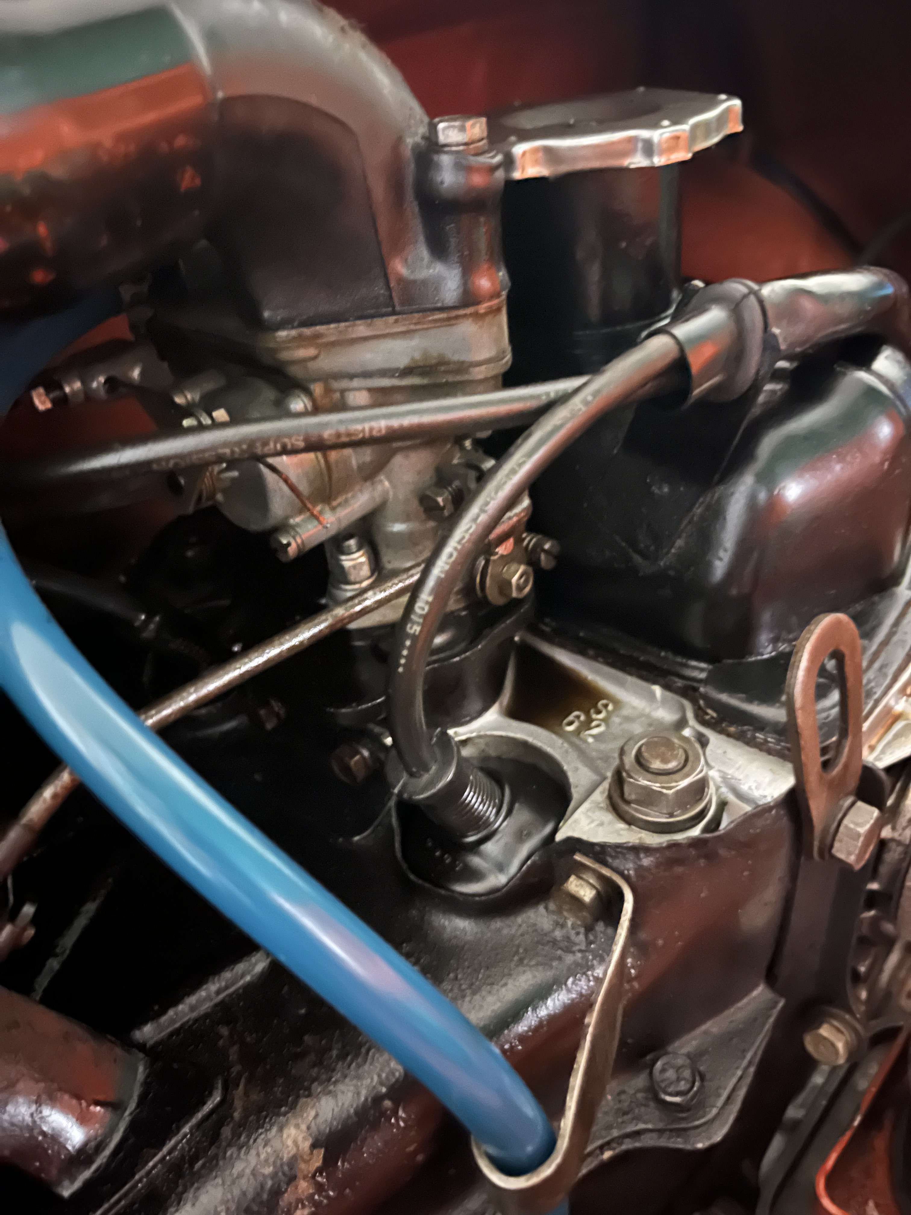

I am new to the forum and new to the Classic 500 community. I have been recently experiencing issues with starting up in colder weather although I now suspect that is not the root issue (40 def F / 4 deg C). My ‘72 had been starting and running great until recently.
Now it struggles to start. The choke is not assisting any more and have to throttle the gas pedal to get it going and takes 20+ minutes to get a good rhythm. I hear some popping and backfire that is unlike its usual behavior. Tonight was the worst of its behavior as it took a substantial amount of cranking with no audible sputter until a lucky turn got it going.
I have replaced the spark plugs and checked all connections. I am assuming the carburetor is the likely suspect now. Particularly because I am noticing fluid accumulation around it.
I do not suspect the carburetor had been over tightened as I have not adjusted this and was not an issue before (a common issue I’ve read in some research). Another suspicion is the float but I wanted to get some feedback before disassembly.
Picture is attached, thank you in advance for any assistance!

It could be wet just because of the amount of time you take trying to start it and so it’s throwing fuel in. Is the choke actually operating ? I notice from the photo that the choke is not engaged make sure it moves when you pull the lever. I would always start from the basics make sure the plugs are good, that you’ve got a strong spark and if that’s ok then it could be that you have a problem with the starter valve or need a carb rebuild kit.

Thank you for the reply. The choke is functional and works once the engine is running. I am suspecting a carburetor issue because I had just replaced the plugs and the engine will not turn over unless I press the gas pedal and once running I need to periodically push the gas pedal to keep it from sputtering out.
Once the engine reaches a certain point it gets a good rhythm and the choke and throttle are not necessary to keep it idling.
Could there be something wrong with the float in the carburetor? In the pictures you’ll notice liquid accumulation around the carb, maybe it’s not accepting the gas and spitting it out?
