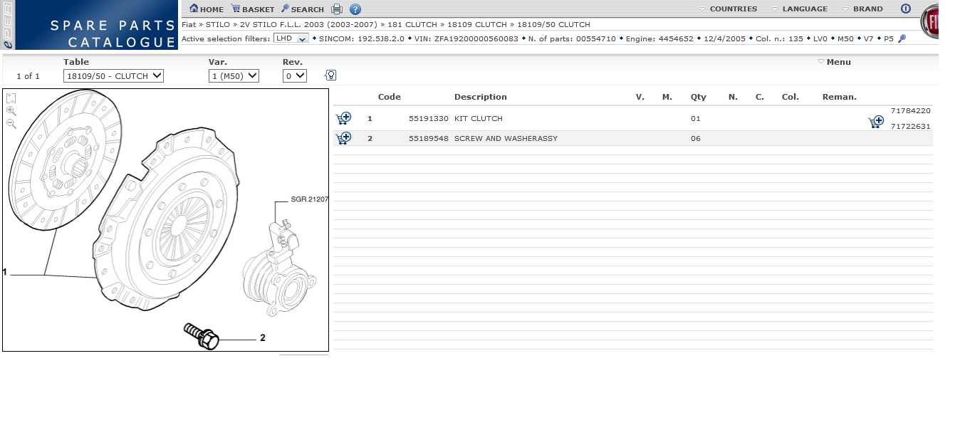

B bri1232 Patron member Joined Aug 28, 2011 Messages 277 Points 121 Location Edinburgh Dec 7, 2015 #1 Hi need help identifying clutch kit for Stilo jtd 115. I need part numbers for Valeo or Luk. Vin no ZFA19200000560083. Year 2005. Thanks.
sussexa Patron member Written a guide Joined Oct 21, 2007 Messages 1,057 Points 206 Location north wales Dec 7, 2015 #2 this is part number eper throws up from your vin 55191330 bolts are 55189548 recon clutch listing 71784220
sussexa Patron member Written a guide Joined Oct 21, 2007 Messages 1,057 Points 206 Location north wales Dec 7, 2015 #3
