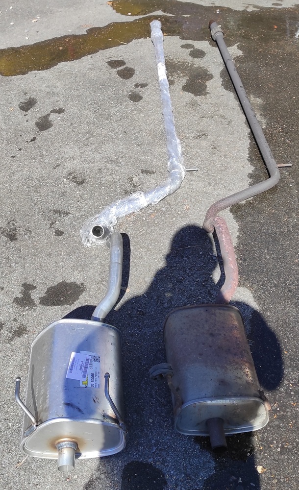

I had a nightmare with a replacement exhaust on Mrs Dave's 1.2. The exhaust was rubbing, but I could not find where. She had to put up with it far longer than acceptable after each failed attempt to sort it out. Witness marks on the shock absorber bracket eventually exposed what was going on. The box was sitting too far back so the axle hit the box on full bump.
Well, I took it to a garage today for a wheel alignment and while it was there had a good look at the underneath with the mechanic, and there was the tell tail mark on the shock absorber.
It explains why the sound is getting less and less. Every time it hits it gets knocked a bit further back.
