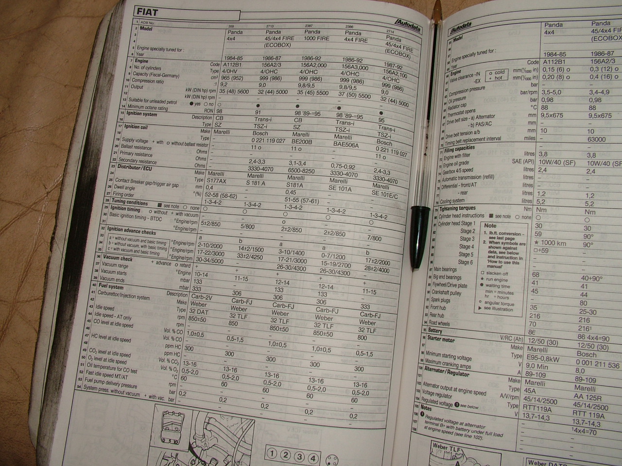

Adding this in here as I think I may have an UNO engine? Any help on identifying much appreciated.
Hi all, new on here and to owning a Fiat so hello all.
I'm just registering a 1991 Panda 4x4 from Italy and was wondering if anyone could decipher the engine number?
There appears to be a letter/number stamped over each other. Could it be A3? Would this be the original engine also? Not sure if the engines were shared with other Fiat models as I can't find any reference to this engine in a Panda.
Thanks for any help.

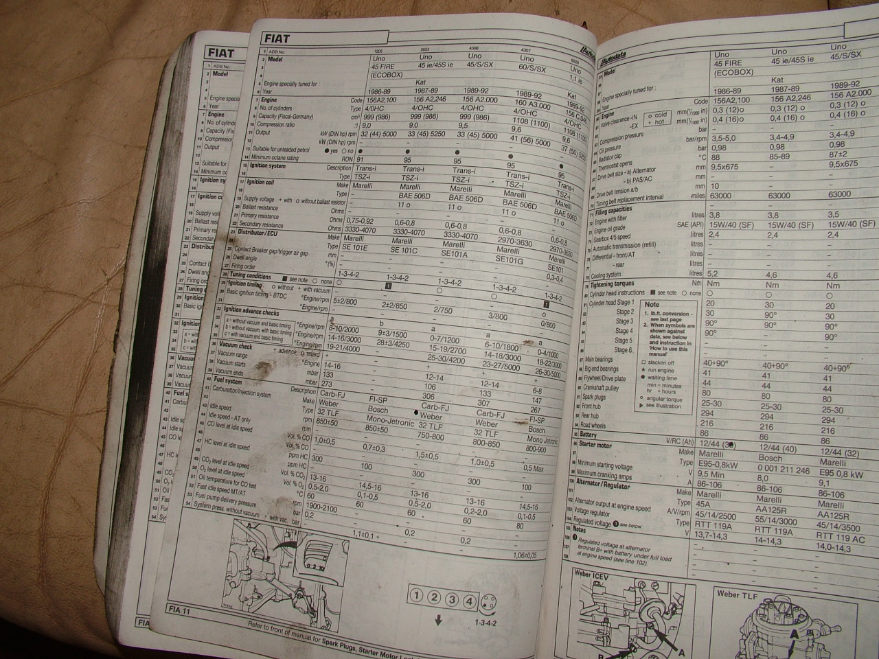

Any good? So could be the 1108cc 160A.3000, much more powerful. :)

Thanks very much Mike. Very helpful. So this would definitely be an UNO engine then and not the original. I am guessing they are very similar due to it being in the car already.
The other engine stamps I have seen clearly show 'A3' but this one seems to be stamped on top of itself. Anyhow, thanks for the quick response. 🙏🏼
