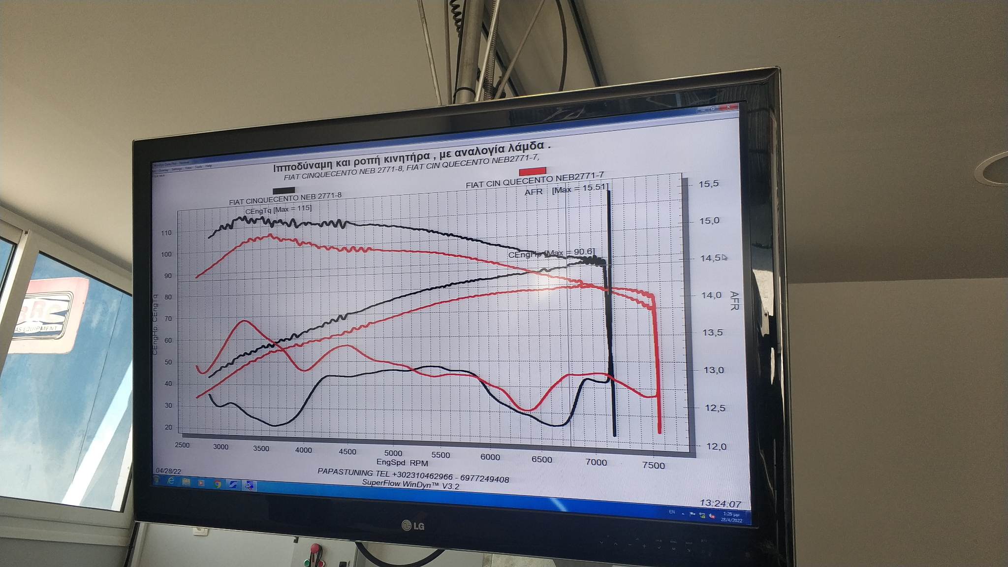

Greetings from greece ...i have a cinque with a tuned 1.2 8v spi ..specs are
Engine from lancia with the bigger valves and 866 cam installed
Headwork
Ported /portmatched intake manifold
Colombo bariani 280 masino stradale
Headers / exhaust
Ecu reprogramed
...the dyno wrote 90.5 hp

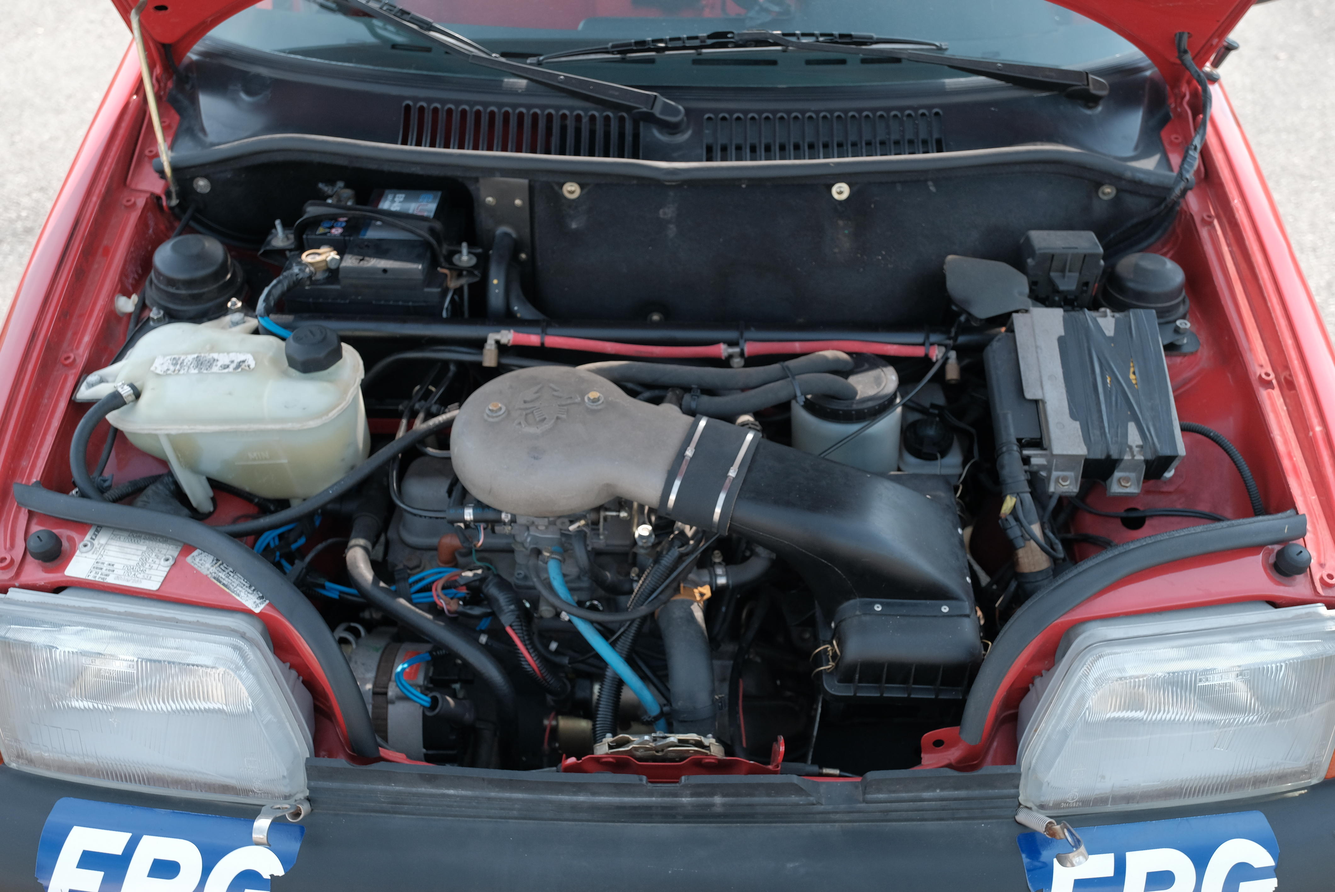

I have the intake from the pics ..
Is there anything better for intake or it is fine ? As i see it doesnt have path to fresh air

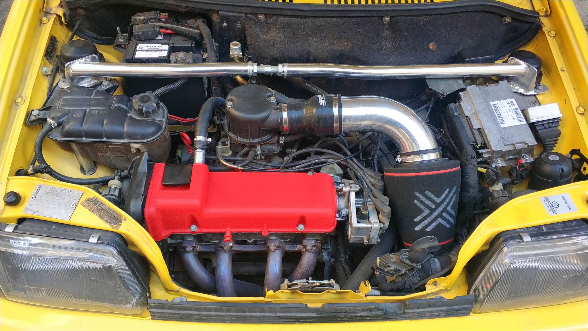

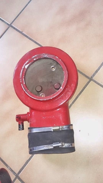

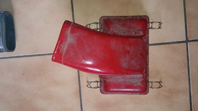

The Trofeo cars used a larger intake plenum box with less restriction compared to the original diameter of the plastic part, efectivelly removing the step down on your aluminium tube. There's a guy in Italy making replicas out of fibreglass but the original Abarth was aluminium. However you can built something in that line
I ask the man who make the replikas and send him a pic of my intake and ensure me that the is no worth the effort my strada bob make exepent job
Whats the diameter of the intake tube on yours? (where it goes to the plastic part over the throttle)
