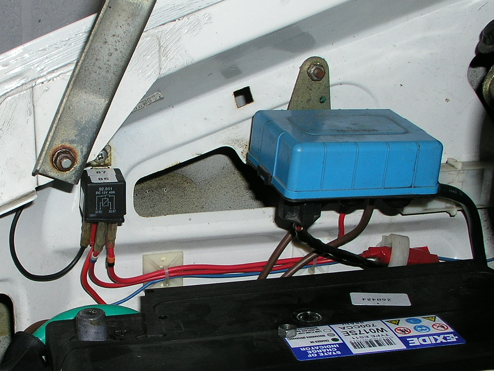

Pay particular attention to the connecting point labelled "BB10" at the lhs of the diagram. On my Talbot Express which was the earlier 280 model this connection point was a 4 way large 9mm? blade connector. As I remember everything other than the main starter motor connection was routed through it. For safety, disconnect the battery negative before investigating. Also worth checking the main chassis earth connection in front of RHS engine mounting.
For 4 way blade connector see photo. It was to the right and behind the blue glow plug controller. Your x230 may be different.

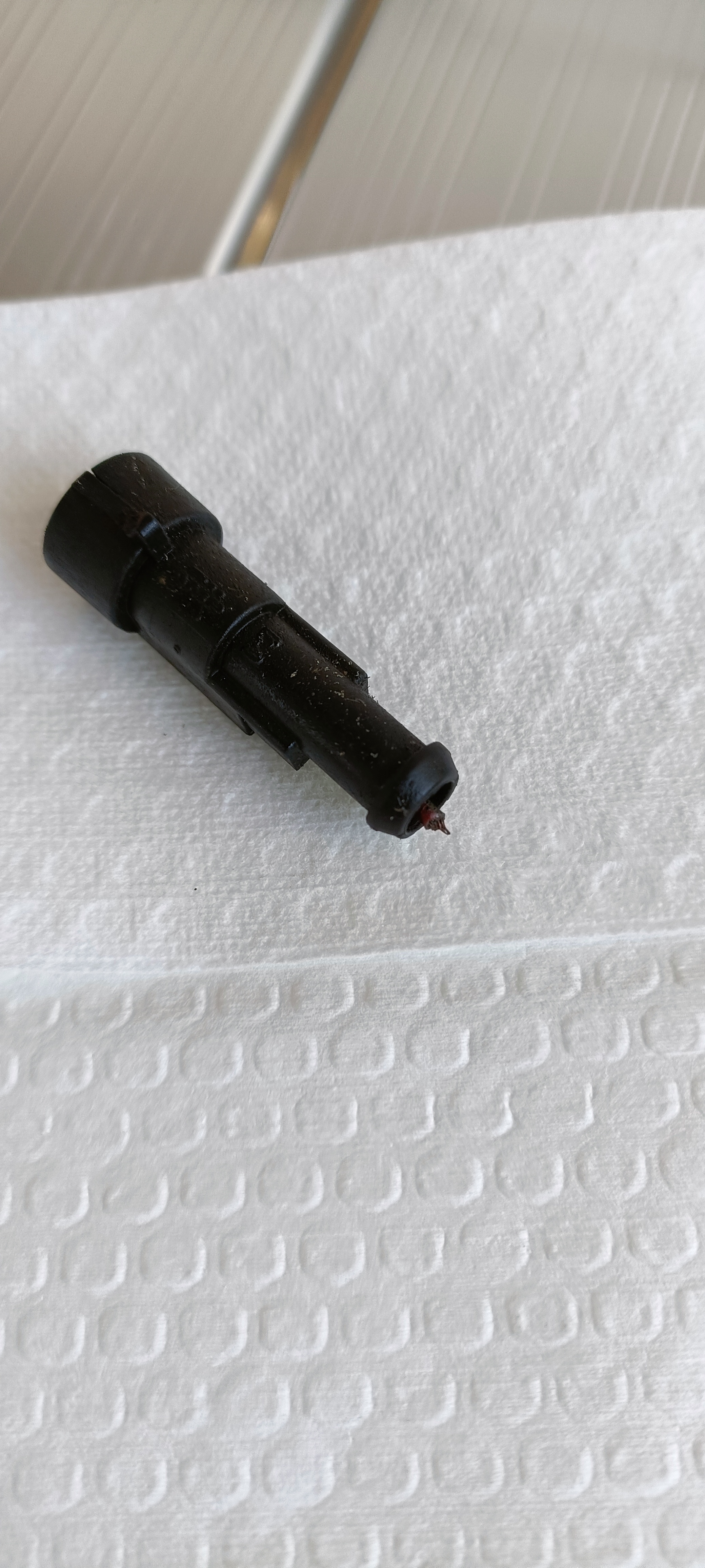

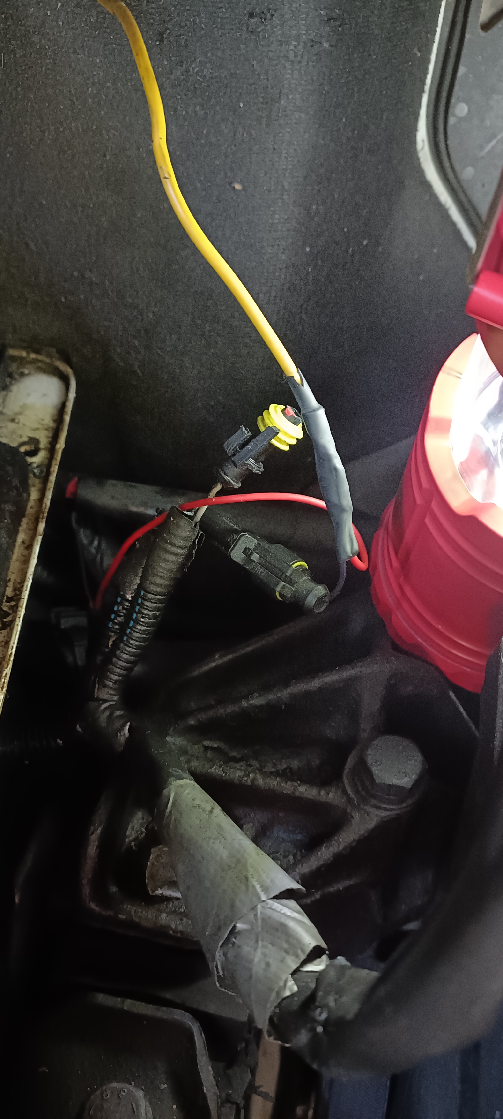

Plug with red/black wire broken in photo 1. Photo 2 shows yellow tipped corresponding socket . Cannot find red/black wire to warning light nearby. Possibly fallen behind engine or lost in loom.
The single pole Tyco-Amp waterproof connector seems to have met with a nasty accident! It is irrepaiably mangled.
If it is indeed the connection to the warning light that is broken, then the wire must be grounding somewhere for the light to illuminate dimly as described in initial post.
