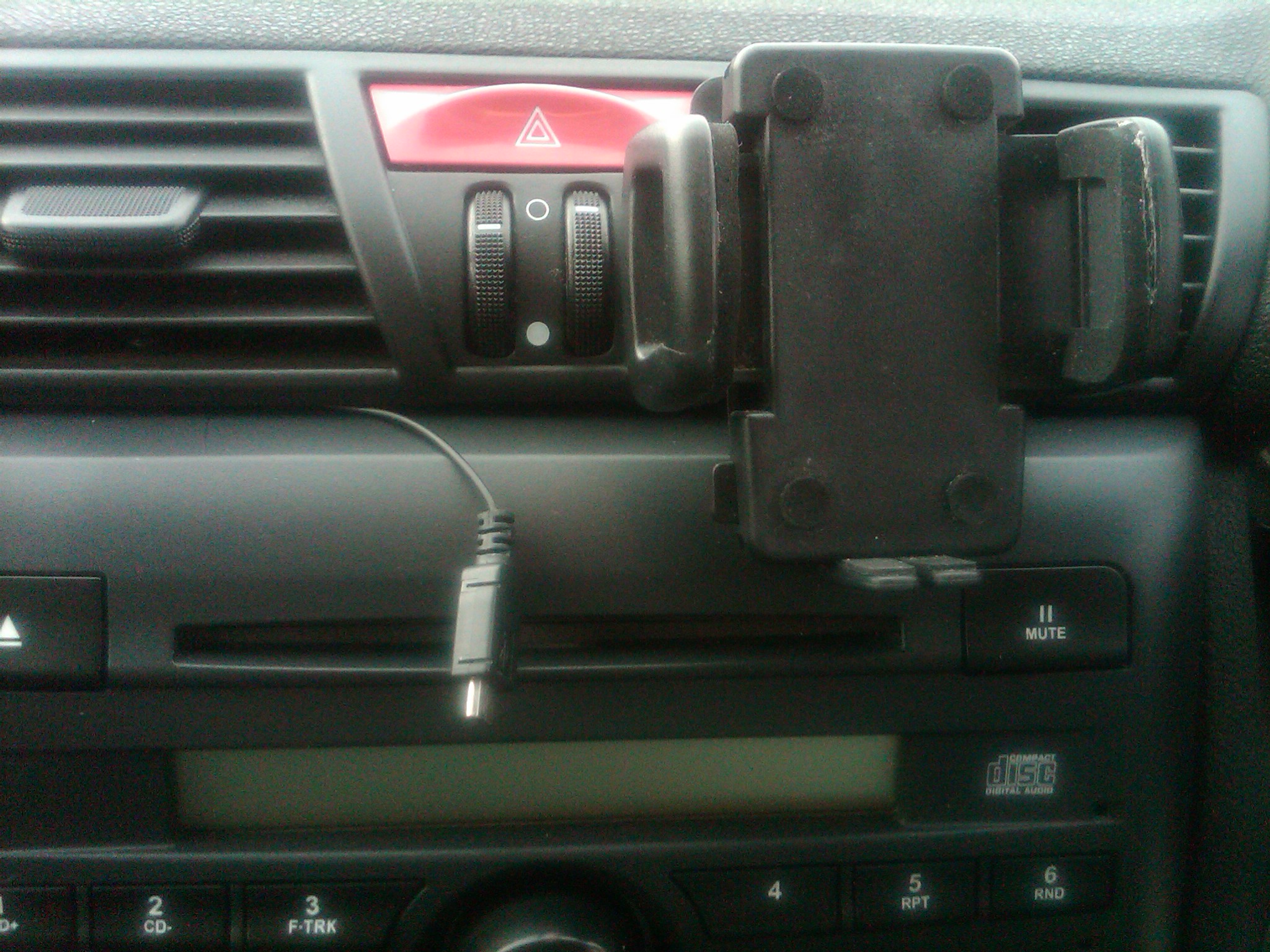

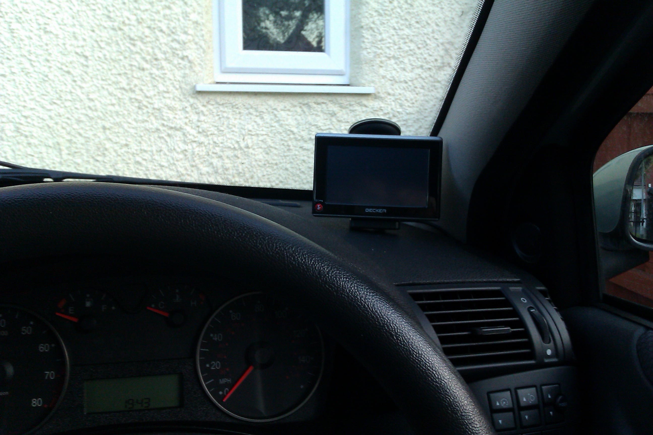

I took a feed from the glovebox courtesy light - it's a switched feed, but also stays live for about 15 mins after you turn off the ignition (try it - leave your glovebox open, lock up the car - the light goes out after about 15 mins).
I got an inline lighter socket and let it in the glovebox connected to my blackberry charger, which is neatly run behind the dash to where I need it, but I can easily unplug it and stick in my satnav charger - I only use my proper satnav occasionally on long journeys...
