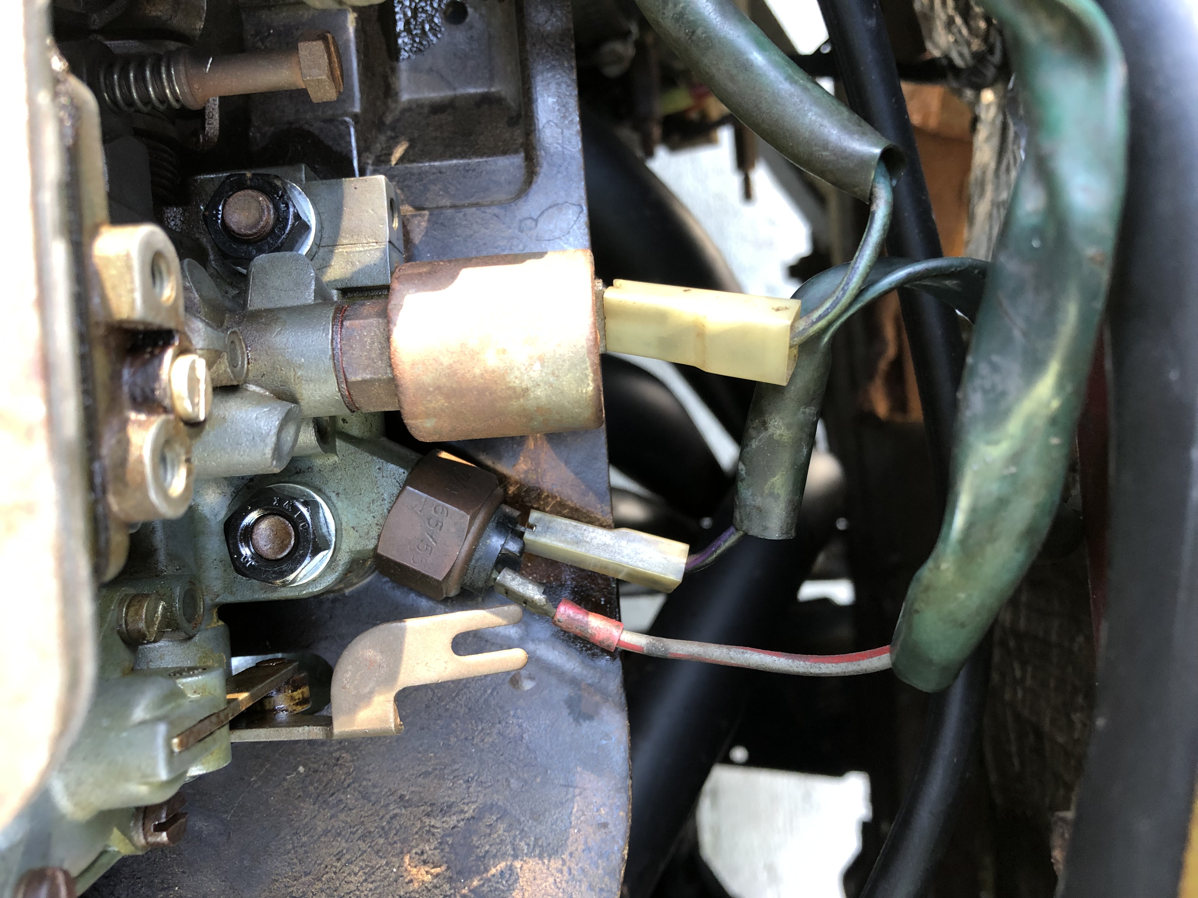

Can someone please show me pictures of the wiring for the carb fan at the Carb. Also can you show me a picture at the fan.
This is how mine is. I thought there would have been some relays by the fan or something. Also I don’t know what those green wires go to.

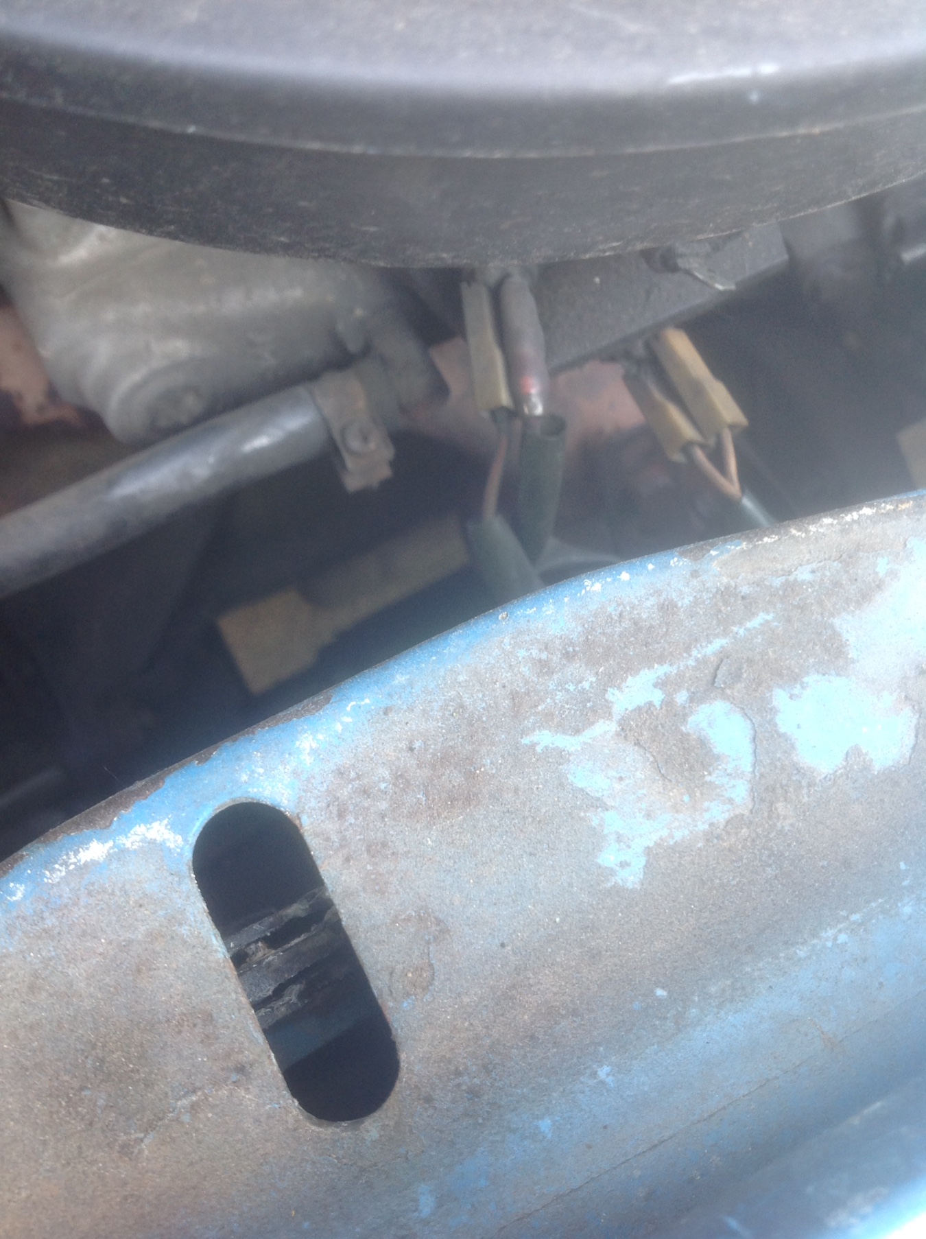

Here is at the fan motor.

There is a relay in the spare wheel well. One side of the thermostatic switch on the carb should have continuity to the chassis, the other side continuity to pin 86 on the relay.
Pins 85 and 30 on the relay should have permanent 12v on them. One side of the fan motor should have continuity to the chassis and the other wire continuity to pin 87 on the relay.
When the thermostatic switch closes it engages the relay switching 12v on pin 30 to pin 87 connected to the fan motor. As the 12v is permanent the fan should operate without the ignition.
If continuity between contacts is ok and shorting the wires of the thermo switch together doesn’t operate the fan, replace the relay.
Right now on the sensor on the carb I have the black wire with a purple line that goes right to chassis. And the other wire on the switch is grey with a red line. If I touch them together the fan comes on. But I have never heard the fan come on before. They’d why I thought something was wrong.
