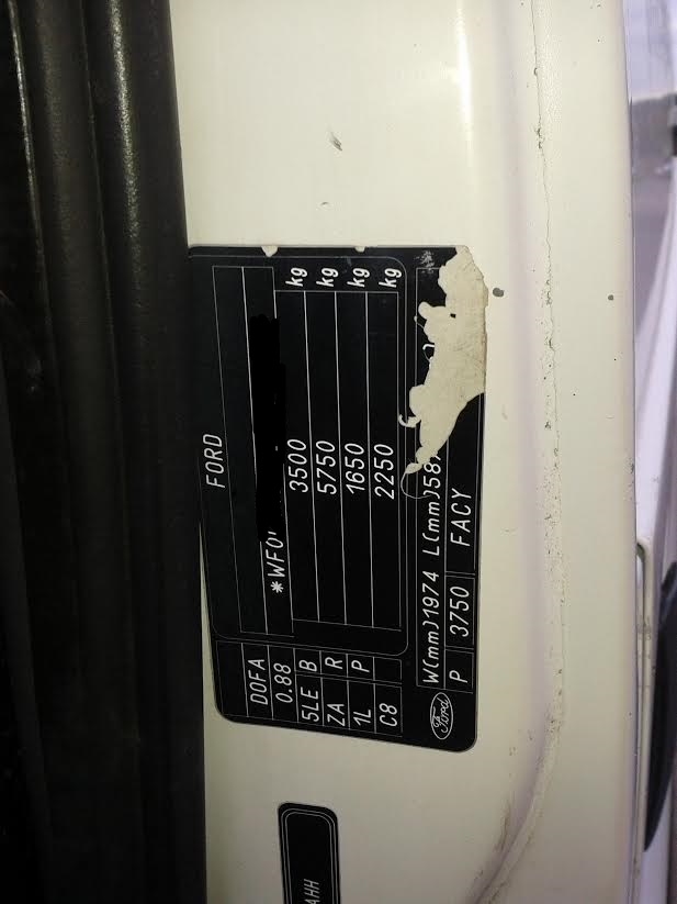

I have only a car licence (Cat B) and (B+E)
Can i drive this van on it?
Since Cat B is MAM upto 3500kg
So does that mean i actually need a Cat C1?

Yes the MGW is 3500kg.....
the 5750kg is the max towing weight..
Category B
You can drive vehicles up to 3,500kg Maximum Authorised Mass (MAM) with up to 8 passenger seats (with a trailer up to 750kg).
Category B+E
You can drive a category B vehicle with a MAM of 3,500kg with a trailer with a MAM over 750kg.
You can also tow a trailer with a MAM greater than 750kg as long as the combined weight of the category B vehicle and trailer doesn’t exceed a MAM of 3,500kg.

Im not gonna tow with the van
No trailer lol
But im fine to drive it on my cat b then?

Yes, you can drive this van without a trailer on a B licence.
Interesting question; if you were to overload it (and I'm not for a moment suggesting that you would), then clearly you'd be committing the offence of driving an overloaded vehicle, but would you also be committing a licence offence?
Logic suggests that you'd still fall within the licensing rules, since its maximum authorised mass is still 3500kg, even if you're carrying some additional unauthorised mass.
If it was 3501kg in thoery id be done for overloading vs not driving with the correct licence I would have thought

As the Gross vehicle weight is 3500kg, it is a catB vehicle.
If you overload it, you commit the offence of overloading, but not the licence offence. The licence permits driving a vehicle with a gross veh weight of 3500kg, which it is, regardless of the actual load.
