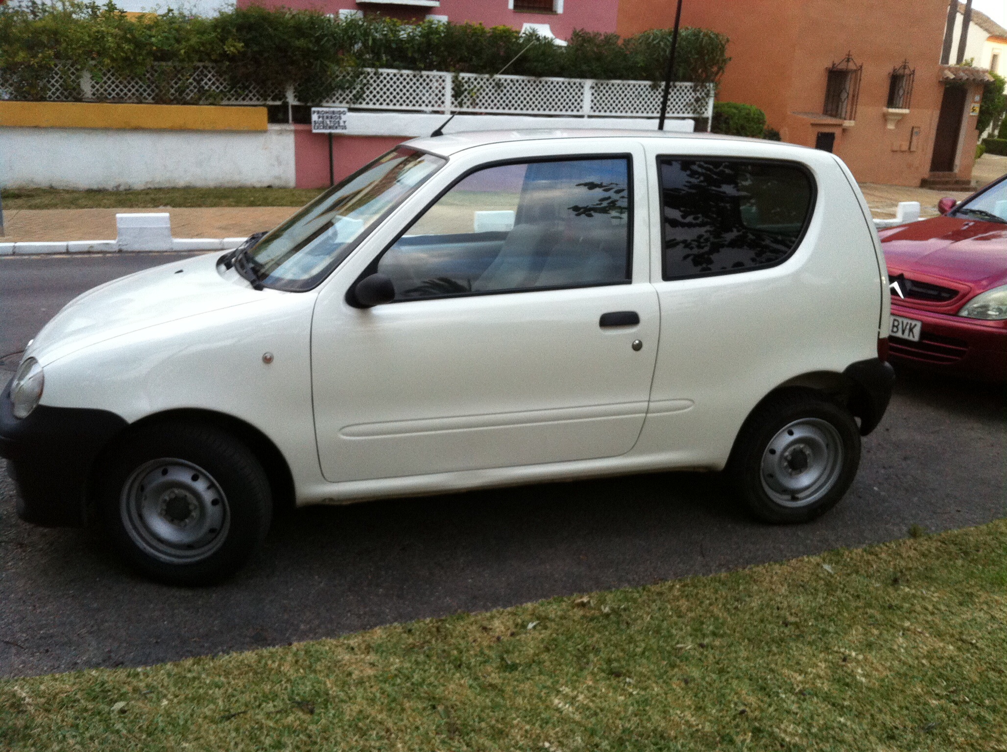

I attach a random photo of 'Noddy'!!

been a while since i had stock cento brakes to be honest, can't remember if they have the plate or spring type retainers that stop the brakes squeaking like hell. But sounds like its not that ;)
And i do love a white cento!! :yum:
'Noddy' is brilliant...and he is a 'Van' so no rear seats just a cage and loads of loadspace for 'man things'(tools/big dogs etc)
They are sought after here. Many tradesmen use them and one like 'Noddy' was for sale just up the road, same year, colour, spec with 250,000km on it for €2,500-00....
CRAZY..
'Noddy' used to belong to a mate of mine(he has a car/boat/plane polishing business) so I got him for 'buttons'. He has 'swam' a flooded river(carpets in passenger footwell have been 'cut out') but other than a couple of minor dents is 100%.
My business partner was driving 'Noddy' in Marbella and was 'T' boned by an ITALIAN driving a Mercedes...
That has been fixed now but 'Noddy' just brushed himself off and kept going.
The Italian bloke had the TEMERITY to say 'I know these cars, they are 'cheap'.
My mate, who is MASSIVE(yes and still fits into Noddy) growled at him and the Italian s@@7 his pants and called the police...
