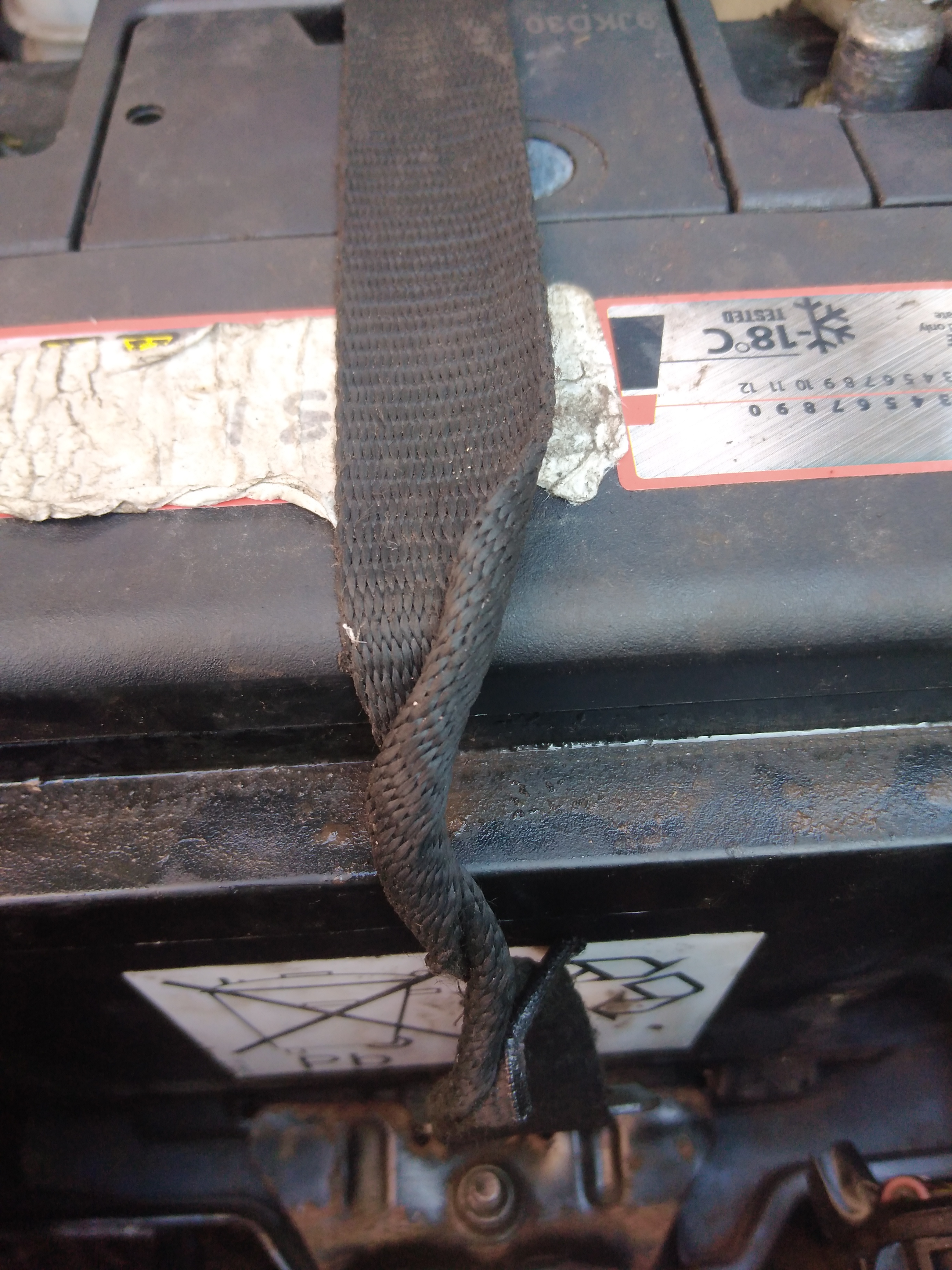

It's shorter though
So the strap doesn't hold for an MOT
I put a twist in the strap to shorten it a bit

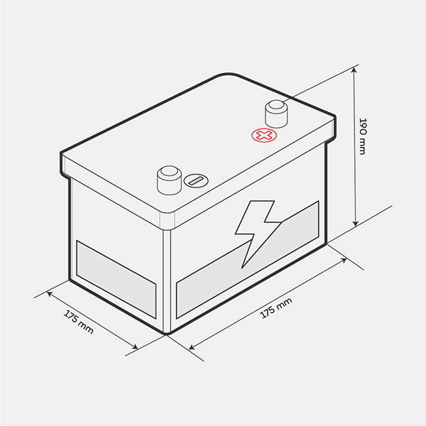

width or depth?Here's mine
I believe mine was 207 mm long, I no longer have the car to check
Width has to be 175 mm

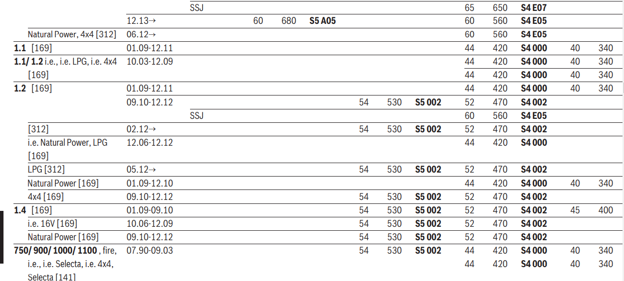

Bosch catalogue
Only thing that matters is CCA
175 on the left has to be 175 for the metal clamp to work (bottom center of my photo)
