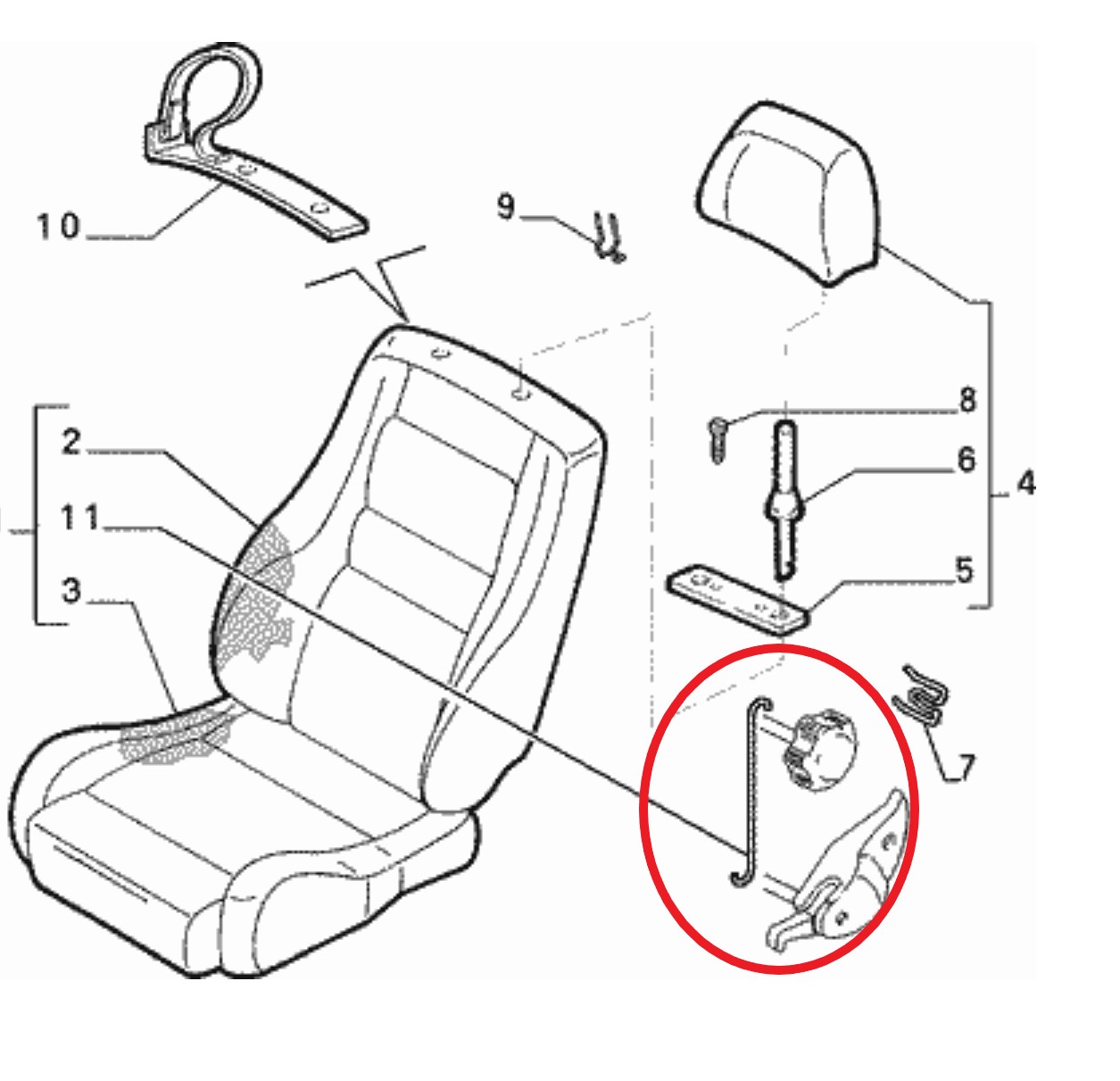

Does anyone have experience with the b seat mechanism? The knob on the side of the seat is connected by a wire to the folding mechanism. By turning the knob, the seat can be folded forward. I have removed the plastic cover and cleaned and lubricated the mechanism. It seems that the wire has stretched and will not quite release the cog. Any ideas?
To clarify:
Problem solved for the technically adventurous:
Remove the seat ( 4 bolts and a few plugs )
Turn the seat up-side-down.
For those of you who have had old 3 speed bicycles, this will all be logical.
The end of the cable that clips into the cog ( this is in the bottom of the red circle ), the last 3 centimeters are cased in a brass sheath bent to form a Z. Detach the Z. Re-bend it with 2 pair of needle-nose pliers to make a new hook. This basically shortens the cable by about half a centimeter. Just enough to make the cable work again. Hook it back in and everything works like new.
