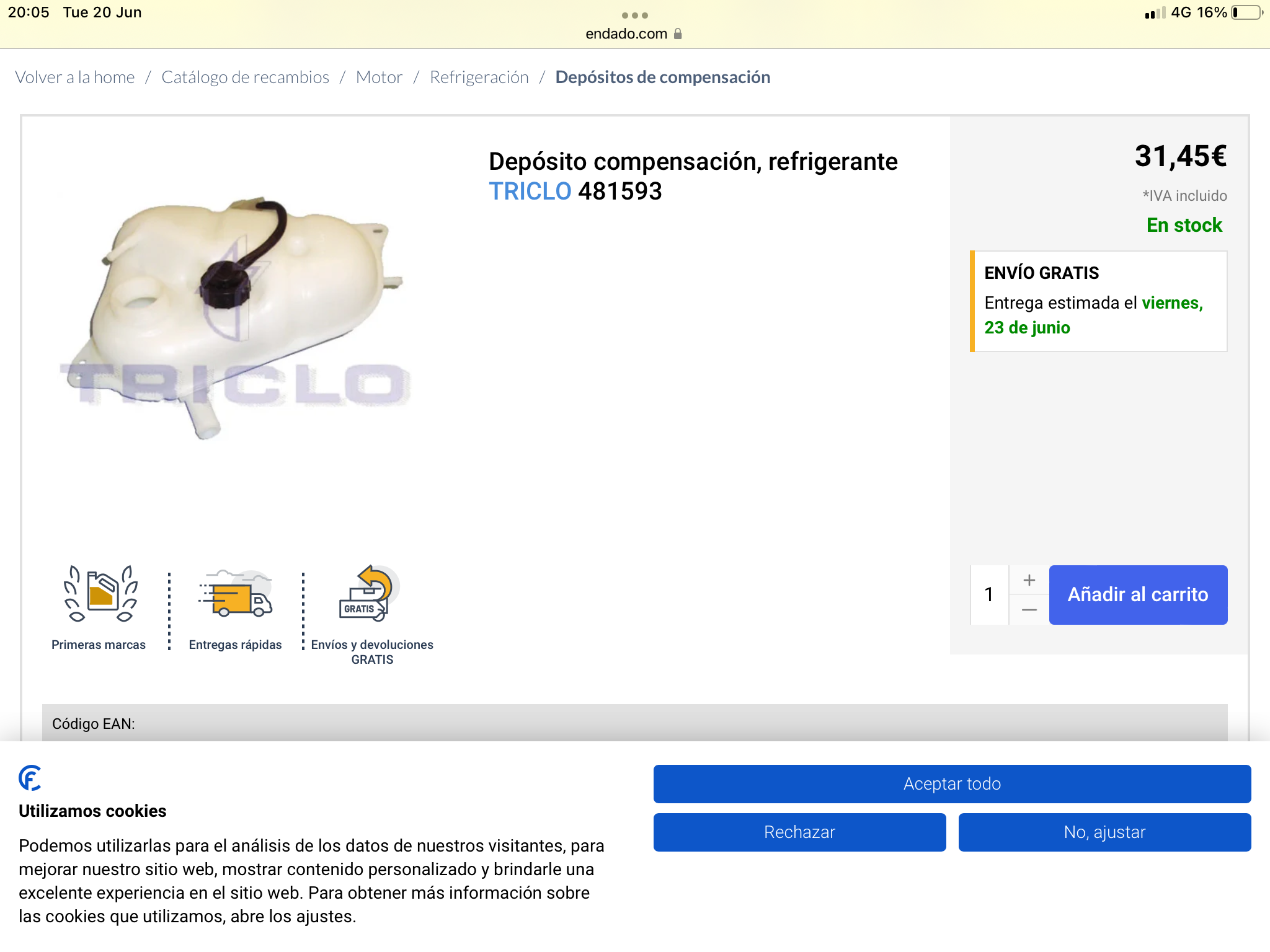

I IbizaLad New member Joined Jun 2, 2017 Messages 1 Points 1 Jun 20, 2023 #1 Hi. I need to replace the coolant reservoir on my Barchetta. All the online searches point me to the first photo. However this looks nothing like what I’d in the car (second photo). Can anyone advise? Attachments IMG_0650.png 506.9 KB · Views: 150 IMG_0649.jpeg 1.2 MB · Views: 128

Wiltshire Chris Accidental Barchetta owner Parked in the garage Written a guide Uploaded a resource/download Written a review Joined Jul 14, 2020 Messages 433 Points 241 Location Wiltshire Jun 20, 2023 #2 Hi, the part number you're looking for is 46403390. Henk has them in stock Tank for coolwater - Barchetta Parts repair and auto spare parts barchettaparts.com I see autodoc list them available as a new part but without any picture it would be a risk.

s130 Moderator Staff member Parked in the garage Written a guide Uploaded a resource/download Written a review Joined Dec 5, 2006 Messages 6,271 Points 1,607 Location Wrexham, North Wales Jun 21, 2023 #3 The Fiat P/N is: 46403390 Suggest you try searching on that.
