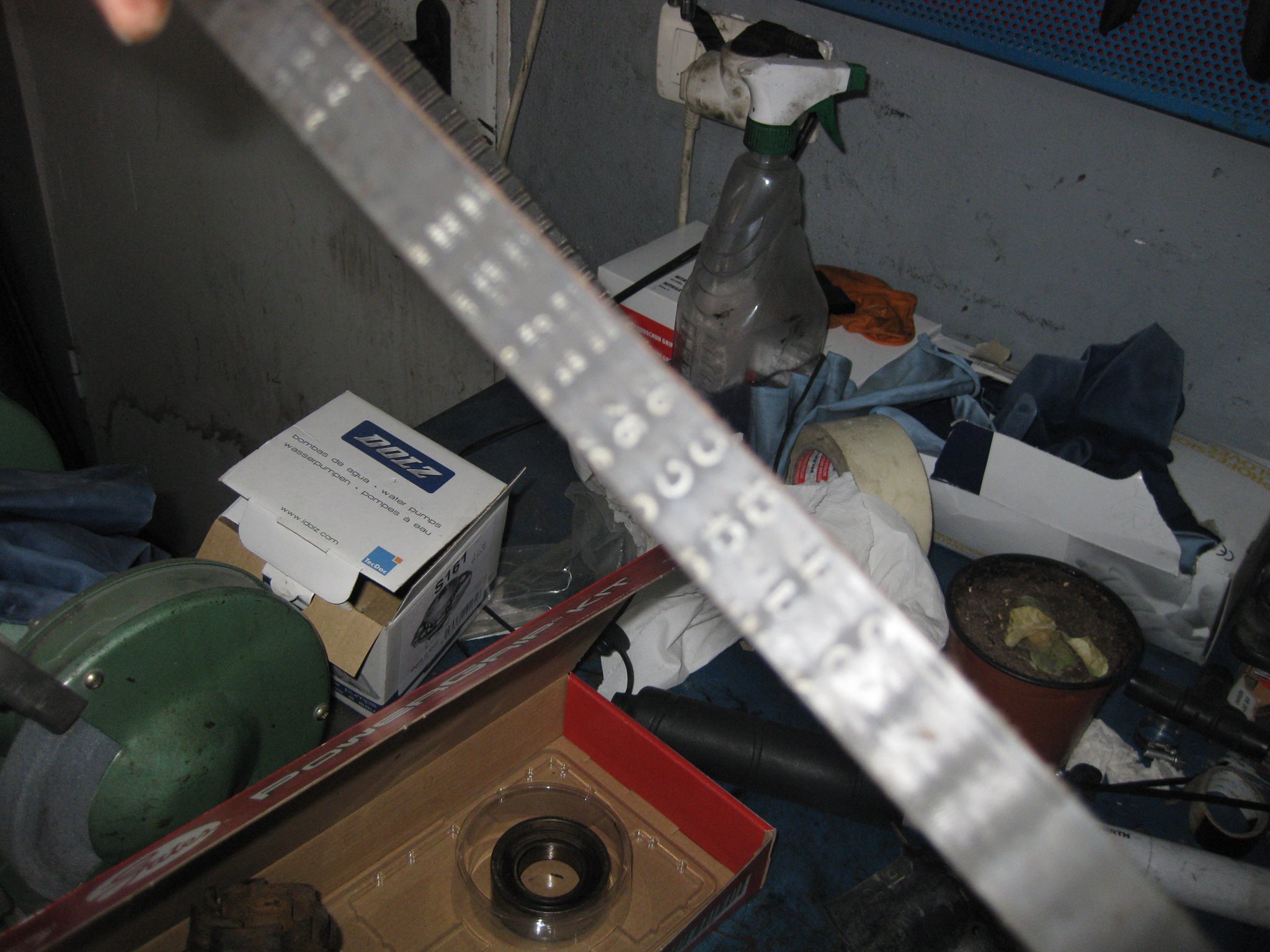

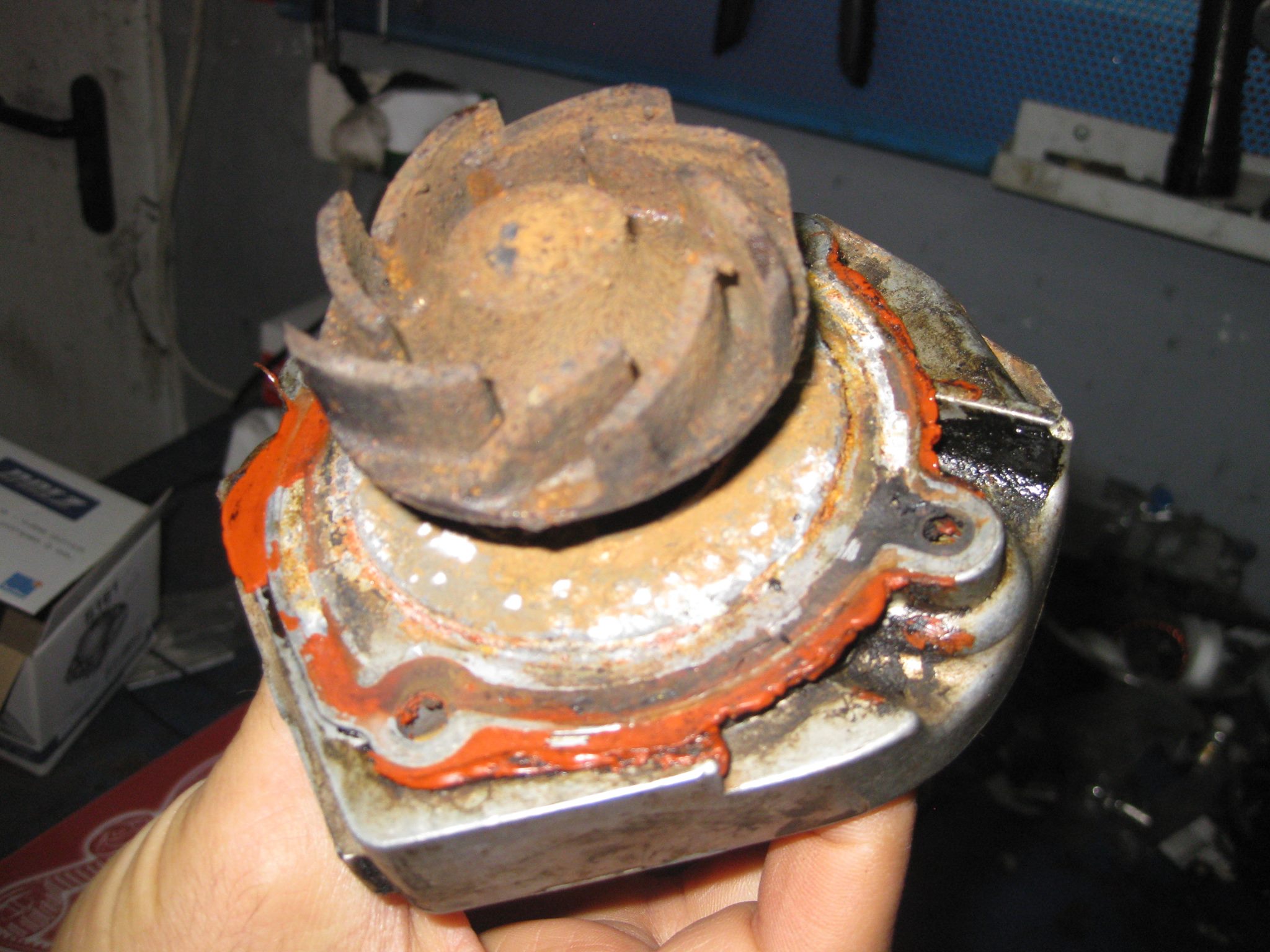

I have attached photos of the waterpump, cam belt and tensioner and it would be good to get opinions as to the age of the waterpump, and whether the belt and tensioner look like they were replaced 300 miles ago.

How old would you say that water pump is and do you think they have any excuse for thinking it was 'quite new' - assuming they didn't take it off and look inside.

could you take a sharper focus picture of the belt..?? I've a suspicion that's OLD too.

I can get a better pic tomorrow. What exactly should I be looking for? The white writing has definitely started rubbing off, the teeth have some nicks in them and the outside has shiny stripes on it (corresponding to the teeth on the inside). I had only driven about 300 miles with this belt before these pics were taken. I have seen belts that have done 70k, and this belt looks worse, but then I guess it could just be a poor quality aftermarket belt.

Outside of pump looks scruffy, but will reach this state quite quickly, so difficult to judge its age when fitted.
The state of it inside suggests it has been in there some time, but the rusty impeller suggests run for some time without coolant. Whilst we often refer to the coolant as 'anti-freeze' that is only one of its functions. Just as important is its anti-corrosion properties, but warmer climates often leave it out, with disastrous results. It is quite likely that the seals in the pump failed due to corrosion contamination. Not the fault of this garage, unless they've looked after it for some time and have charged for non-existant coolant.
The red sealant shows this is not the original pump
Take a pic of the belt without bending it. Important to diagnose tooth failure. If possible, indicate direction of travel, as tooth failure can indicate too tight, or too loose, but failure will be different.

A belt tooth coming off can be caused by either too tight, or too loose. If the garage overtensioned it, the failure could be their fault, and you could argue that the pump failed because the belt was too tight. Ideally, the belt should be sent to its manufacturer for inspection, but it is important to mark its direction of rotation. Tight or loose will remove teeth differently.
Normally, the teeth do not drive the pulleys. The outer band of the belt provides the driving force. the teeth are merely there to ensure the timing stays correct.
A tight belt will tend to stretch a little between the pulleys, and then be squeezed back to normal size as they run across the pulley teeth. This tears the teeth from their leading edge.
A loose belt will rely on the teeth to drive the pulleys, so that will pull the teeth off from their trailing edge. So direction of rotation is important in diagnosis. Both the above should show distress on all or most teeth, although only a few may fail, as that stops the engine and prevents further teeth failing.
If pump seized, even momentarily, teeth will strip at that point. The rest of the teeth would probably look fine. You bent the belt to take the photo, don't do it again, it may make diagnosis difficult if you cause further damage.
