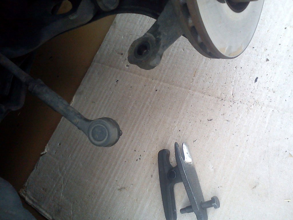

Next undo the steering tie rod end. Inspect it (cracked boots, damaged/loose joint). All bolts/nuts will be 16 or 17 mm from now on. Not much tools needed for this whole job.

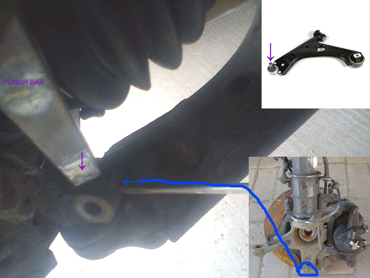

Track control arm ball joint. Pop it out too. Remove bolt and nut. Wedge something into the gap (but not too crazy) and hit, punch the joint out of the knuckle. Many universal ball joint pullers will not fit here (or will damage the rubber - "wishbone" ball joint boot and/or axle CV joint boot).

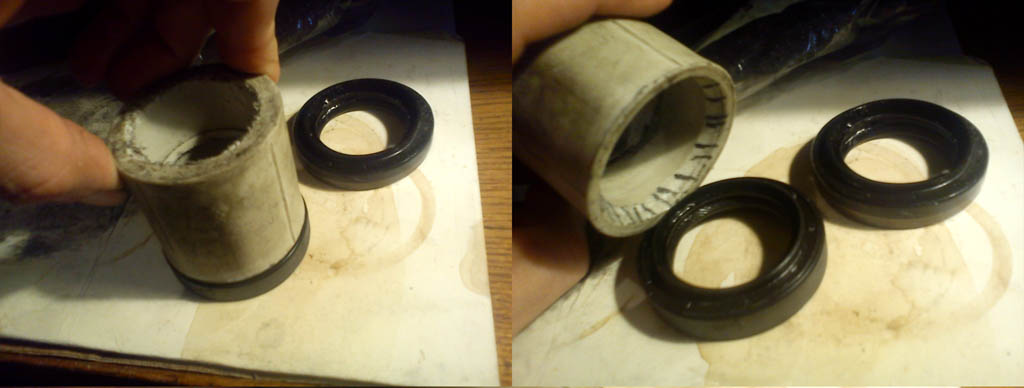

Second most important thing. You know the seal dimensions (diameters). Prepare some install tool, improvise, piece of pipe, bushing, plastic hydraulic fitting, bearing race, or old seal etc. Lubricate and tap the seals into place, slowly, stop and check often, don't tilt/crook it too much during the job.
