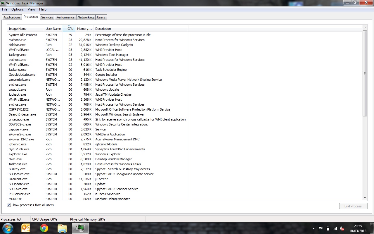

right after having this laptop for a while its really starting to bug me that stuff temporarily hangs and the damn thing just runs slow ive done everything my IT guy (my brother) i can think of to get the CPU usage down at idle but its still idling at 30%+
he suggests CPU upgrade to a dual core processor... but what? (i understand there maybe some chip architecture issues)

speaks for itself but that svchost entry is rouge, 99% of the time it's 0-2%

Personally I'd do a clean install. You could spend weeks hunting down causes for svchost.exe to use more CPU / memory than it should.
While you're on do a physical hard disk check to make sure the HDD is 100% ok and not causing any underlying issues: http://www.hirensbootcd.org/hbcd-v106/
Download and burn that boot CD. Lots of hard disk diagnostics on there. I'd start with Seagate "Seatools".
