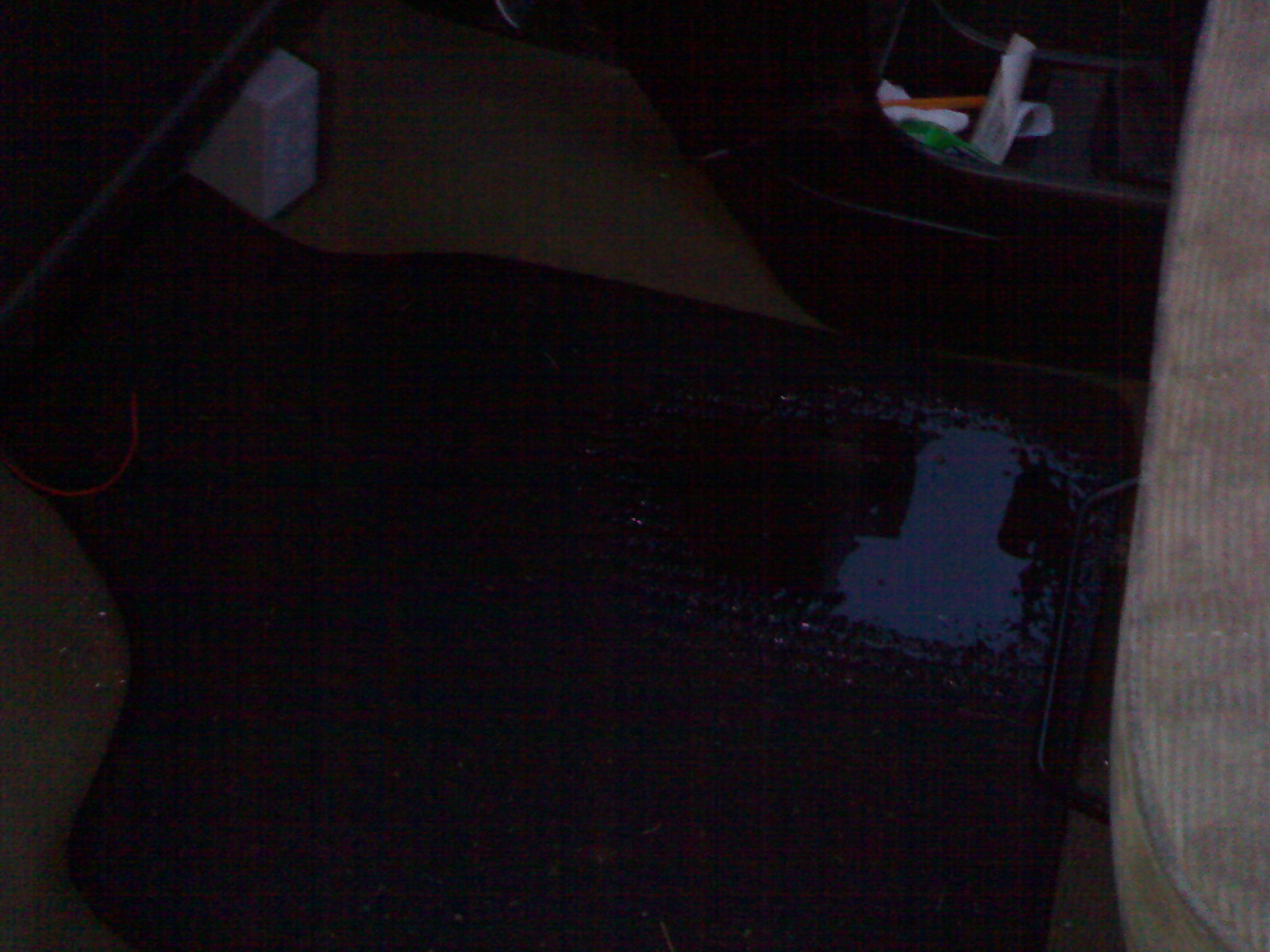

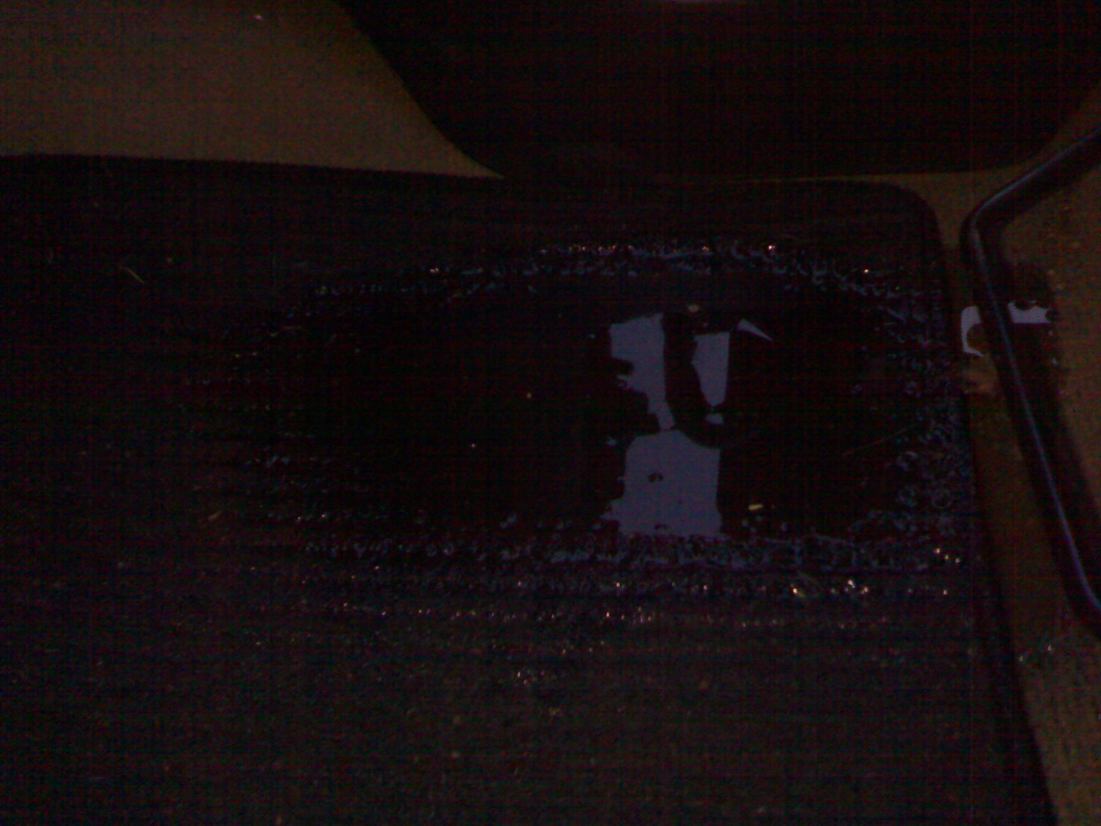

Weather was chucking it down yesterday and to allow a workman's van to have easy access to the house my 70SX was parked sideways on my sloping drive. Went out to my Uno this afternoon and found this pictured below :bang:
Prime suspect is a dodgy door aperature weather strip on the passenger side. Has never leaked before so I assume the angle it was parked at made more rain water pass down that side of the car, which then leaked into the footwell. One sponge to mop it up and hopefully a few days with the heater on will soon have it dried out nicely... :rolleyes:

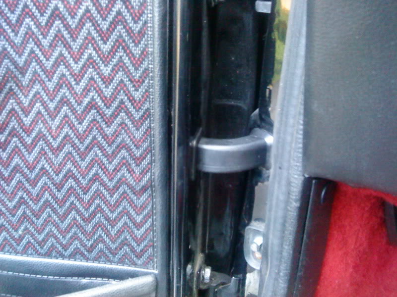

check the plastic bit where the wires go from the car to door, if these are not fitted properly or are damaged your footwells fill up,
there often overlooked but have been the culprit of flooded footwells on both my mk1 uno turbos,
there avaliable new from fiat still for a couple of quid

I checked both sills on both sides for splits in the rubber along the bottom where the doors close (like in oldskoolmk1unoturbo's first pic) and both sides have two or three splits in the rubber...could this be where the leaks are primarily coming from ?

check the plastic bits which cover up the wires which go from the door to the car!!!!
I have no wires from the car to the door ! Where the plastic cover is on your photo i have nothing there. Presumably because yours is a turbo with electric windows ?
