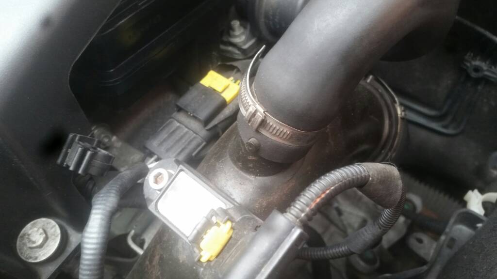

Hey guys I hae a grande punto tjet 2009 1.4.
I am planning to change Antifreeze / Thermostat and Hose pipe to engine block as I have a very slow leak after doing a pressure test on my car.

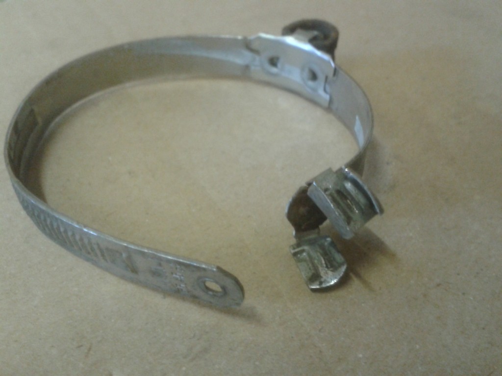

There seems to be 2 types of hose clamps on my car but I cannot see how these are removed and are they also one time use (see pic) 20190902_144346.jpeg20190902_144413.jpeg
You can hardly re-use them since they're will be almost destroyed when removed... When new, they slide to a certain point and then are crimped tight.

It is possible to remove and reuse them with the correct tools, but it's a lot easier to remove them via destructive means, and then replace with a worm drive (jubilee) clip.
I use a small blade screwdriver to open a bit the crimp, then a larger one to get the clamp loose until I can "un-hook" it. Tighten back with a "nail plier", but better use new jubilee clamp ...

Het bern.
thanks for input. Ok so help me out here as when i look at these my eyes go:bang::bang::bang::bang: lol. So is it best to tackle it from the back or the front,by front i mean the 'rolled up C' looking part of the clamp. Is it a matter of hooking off the 'C' looking part of the clamp or do you need to do something else?
