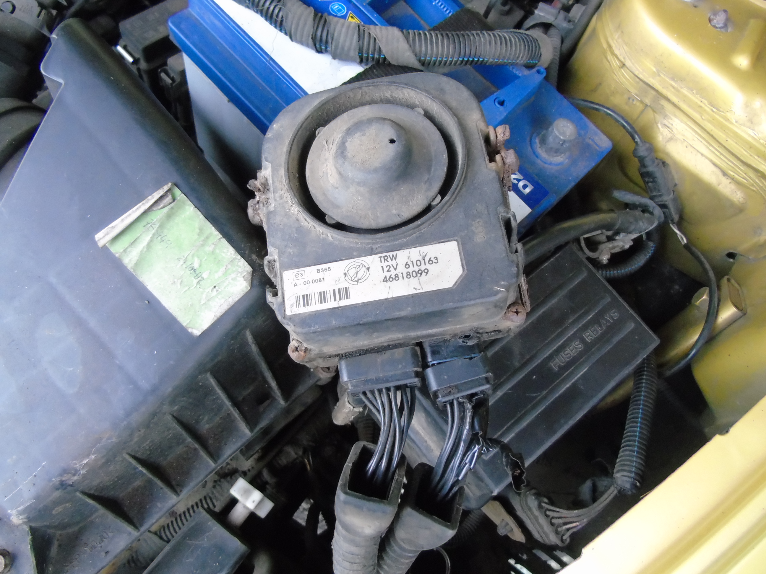

Is anybody breaking a Multipla? I need an anti theft alarm ECU siren. At a garage, where my 115 ELX JTD had been taken for an MOT, a small fire took place in the wiring & plug connectors for the alarm. The garage takes no responsibility and cannot give an MOT pass for the car because the hazard warning lights will no longer operate. All work required for the MOT had been done, but I have been unable to find the parts I need. I could buy a new anti theft unit, but I also need the connectors and wires (or at least a few centimetres of the wires so that they can be reattached). I've sent messages to all that I can find who are breaking Multiplas, but have had no replies. The photo shows the anti theft unit and burnt connector and wires. I am, of course, willing to pay a reasonable price for the parts I need, together with postage costs. Thanks in anticipation of any helpful replies. Colin

Many thanks. These two sellers didn't come up on my monitor when I was searching for Multipla breakers.
My alarm is disconnected but my hazards work. Is something else wrong. I will double check Sunday when home.
Thanks for your reply. My car had failed an MOT at the same garage a couple of weeks before and the hazards were not a failure on that occasion so the fact that they were not working after the fire must, I think, be attributed to melting of the wires leading into the alarm ECU. However I'll be interested to hear the results of your check.

I'm with you in finding sellers annoying when they don't have the decency to even reply to a message and you were right in expecting dshotston to reply. I heard back from him within the last hour. He had difficulty in finding and removing the siren. It was behind the bumper on the drivers side, in a different place to mine. He advertised it on ebay and I've just bought it from him. Thank you for your help.

OK, so what happens if you press the hazard warning button on the dash, does it flash/light up?? Do the indicator arrows on the display light up or flash??
If they do, but indicators themselves do not flash, at least there is power going to the system, but not reaching the relay??
If nothing at all, then possibly check relay for failure?
(this relay also does the left/right indicators individually from the stalk? so worth checking the relay if they don't) Also, possible fuse in the fuse board blown due to the fire shorting out the wiring perhaps?? (earthing out/short circuit?) worth checking fuses to see??
Very grateful, once more, for your advice Hugharsse and that of MultipleMultis. The indicators were working, but the hazard warning switch did not light up, nor was there any light in the indicators when hazard warning switch was depressed so I checked the fuses and found that the hazard warning light fuse had blown. I've replaced the fuse and the hazard warning lights are now working. Seems I could have saved myself the trouble and expense of buying the second hand anti theft device and once I receive it don't think I'll be fitting it. New MOT now to be sought.
Great to know it's all sorted. Assume the wiring fire 'shorted' something to earth, and took out the fuse (as it was designed to do) otherwise could have been more of a disaster, you could have had more loom gone up in smoke.
