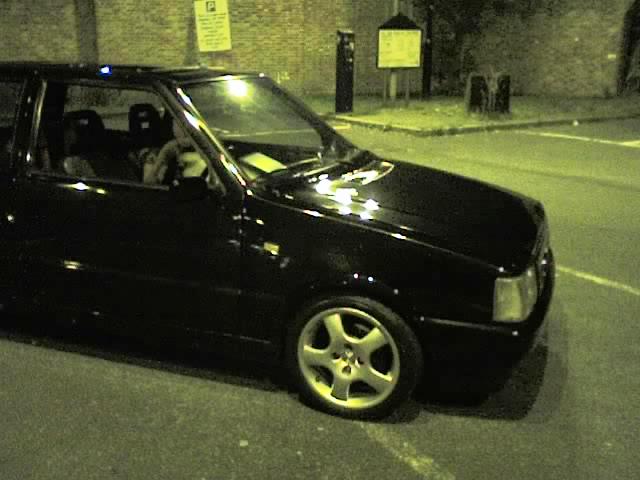

Looking good Kalel. It's a bummer working in tight spaces and when a bolt sheers it can bring a grown man to tears. The thought of a 1 hour job become a couple of days work.....
Thank you. The hardest bit to deal with is that I had to have the engine taken out...then temptation kicked in and I wanted to replace bits that were readily accessible...I managed to hold off with just changing the timing belt, tensioner pulley & fan belt.
