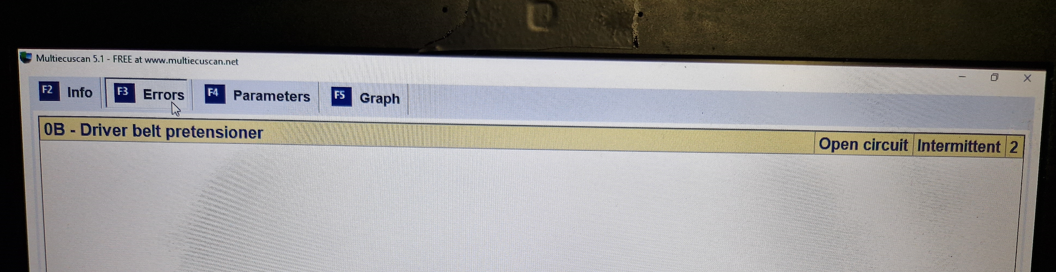

I have a 2003 model (pre-facelift) with newer engine, passenger airbags and OBD2 connector under the seat.
Recently, my airbag light came on, probably hit the cable under the seat after replacing the radio.
Hopefully someone can give me some definitive information on how to reset this yourself:
- Can I reset the airbag light with the free version of MultiECUscan ?
- If so, do I just connect to the ODB2 port to reset it, or do I still need to connect to a separate airbag ECU on the rightside of the car with corresponding cables (3pin?).
Thanks!
Hi Bartazar, I think you can reset it with the free version through the ODB2
Ok thanks, I have just found this confirmation on another forum as well. This person was using a regular VAG KKL cable with the red adapter (#2) and directly to the ODB2 port.
Example: https://www.ebay.co.uk/itm/254536888799
I am wondering whether it will also work with the KKL cable with built-in switch and no adapter. Would make sense, and it mentions here it should work without:
For later "B"s (2003+ CF3) then all you need is a KKL interface and either an adaptor cable OR a KKL interface with the selection switch.
I have a later CF3 "B" and KKL with switch or with adapter cable works just fine with MES. Should also worjk OK with the free version of MES according to the Supported Vehicles List.
Thanks for the confirmation. This was my conclusion too.
I think mine is a CF3 too even though I have a pre-facelift, because I have the 188A6 engine.
I have ordered the KKL cable with switch, lets see! I have spent too much to get fast delivery so hopefully it works 😅

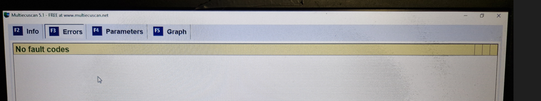

Success! 😁
Thanks!
