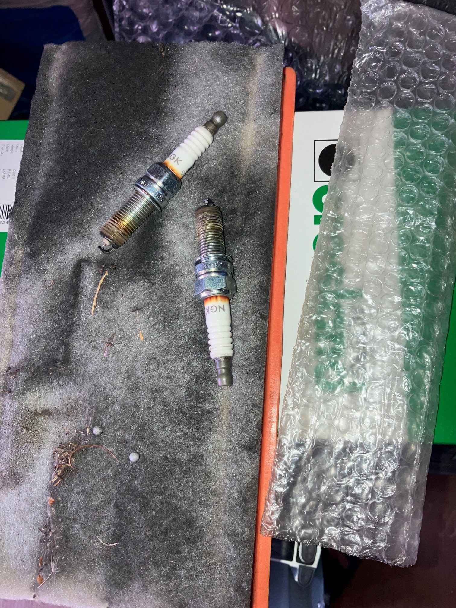

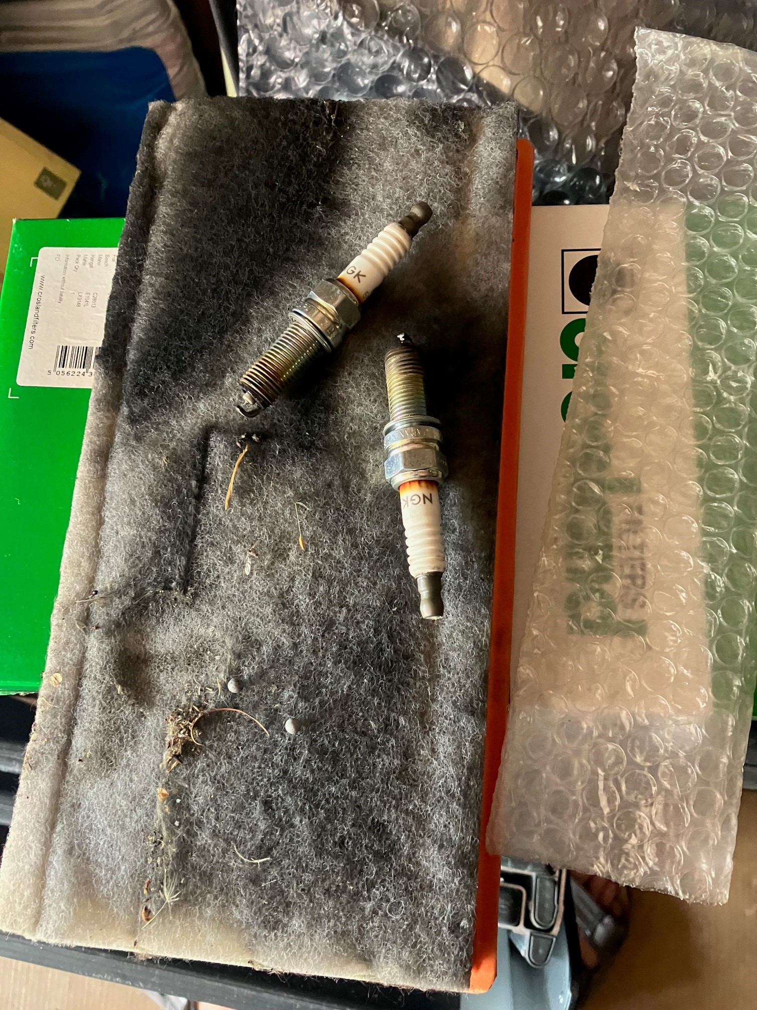

Hi - just for interest really....
We have had the car from new (2014 TA105 Lounge 48,000-ish miles) and in that time i haven't changed the air filter and spark plugs. It was serviced by Fiat at 18,326 (to keep the warranty alive) which was the 1st service interval (18,000). I think 18,000 is too long an interval for the oil and filter so i do that at 9000 or yearly. It being a TA too the oil is crucial.
Anyway i thought 18,000 (2017) - 48,000-ish (2024) is 30,000 miles and 7 years so they might be due a change.
I am assuming here that Fiat actually did change the air filter and plugs at 18,326 but me being a cynic thinks that maybe they just took the money and stamped the book.
So these pictures could be after 30,000 miles (7 years) or 48,000-ish miles (10 years).
I'd say there's nothing in those photos that's inconsistent with them having been in the car since it was new.
But whatever, it'd be a good idea to change them now.
The plug electrodes look to be in good condition (and this shows the benefit of using precious metal plugs), but the ceramic looks to be past its best. The rust staining suggests there's some internal corrosion in the ferrous part of the body of the plug.

What prompted me to change them was that i thought that if i don't change them soon will they become seized in the head
That's a good point. In this case, I'd worry about internal corrosion inside the metal body of the plug. You can see the telltale rust stains on the ceramic.
This weakens the metal body of the plug from the inside out, which can then shear at its narrowest point when you try to remove it, leaving the hexagonal part in the socket and the rest of the plug still in the head.
I've actually had this happen to me, once.
The brown marks on the plugs are corona discharge..... it's only a problem when it reaches the higher part of the porcelain & can cause misfires.
But yes, it can weaken the plug if left too long
