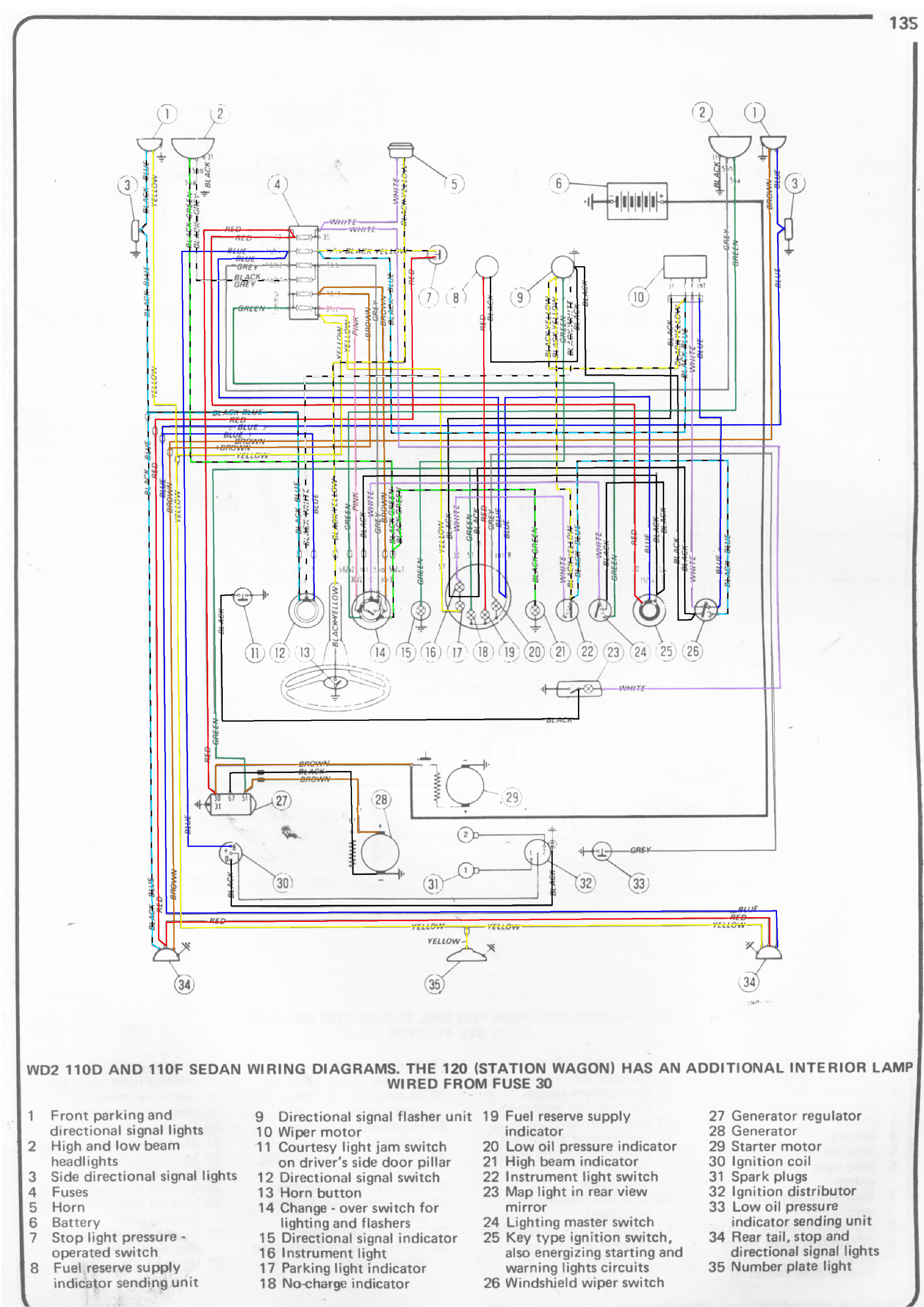

if you search online you will be able to find a wiring diagram....

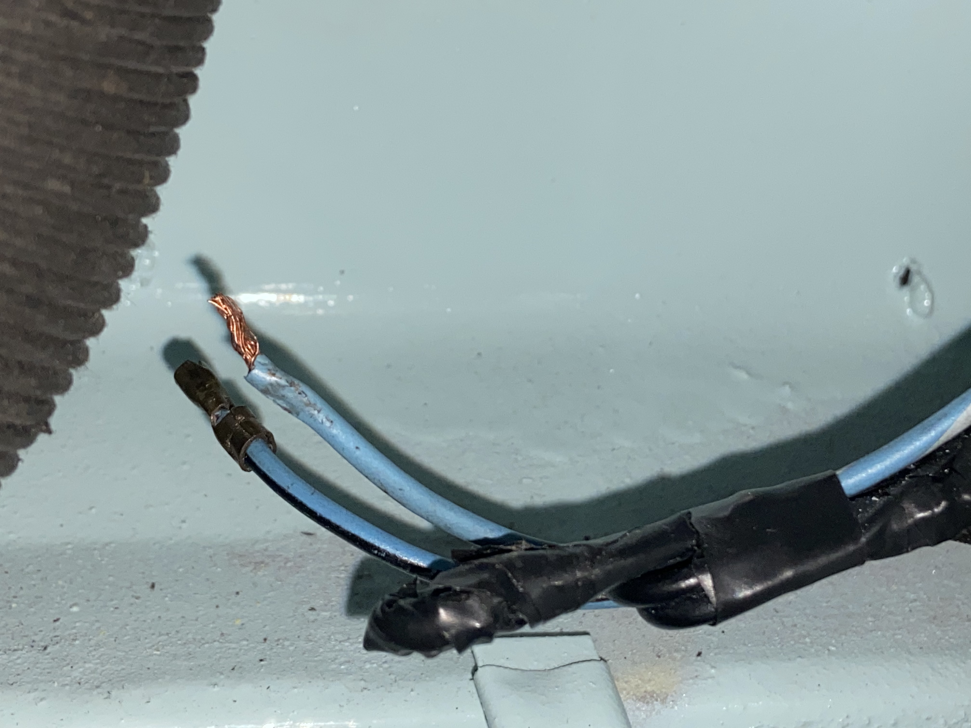

Thank you for all of your advice. I’m going through the wiring bit by bit to see if it’s shorting somewhere. I was checking out the wires that attach to the switch on the back of the dashboard. There are four wires spliced into two ( it’s hard to see exactly what’s going on with all the black tape. ) leading into the switch box. It looks like the four wires should be wired separately! Can someone send me a photo of how there’s is correctly wired please?
Thanks.

The wiring on the 500 is very basic and should be easy to repair. (I have owned 7)
Which switch are you looking at, as there are few on a 500 dash. If you have four wires, then I am assuming the light switch, which, memory permitting, is a two pole switch. The first click for sidelights and the second for headlights. This should have an input ( a live either permanent or ignition controlled) and at least two outputs, a single for the sidelights, and possibly two (one to each) headlights.
