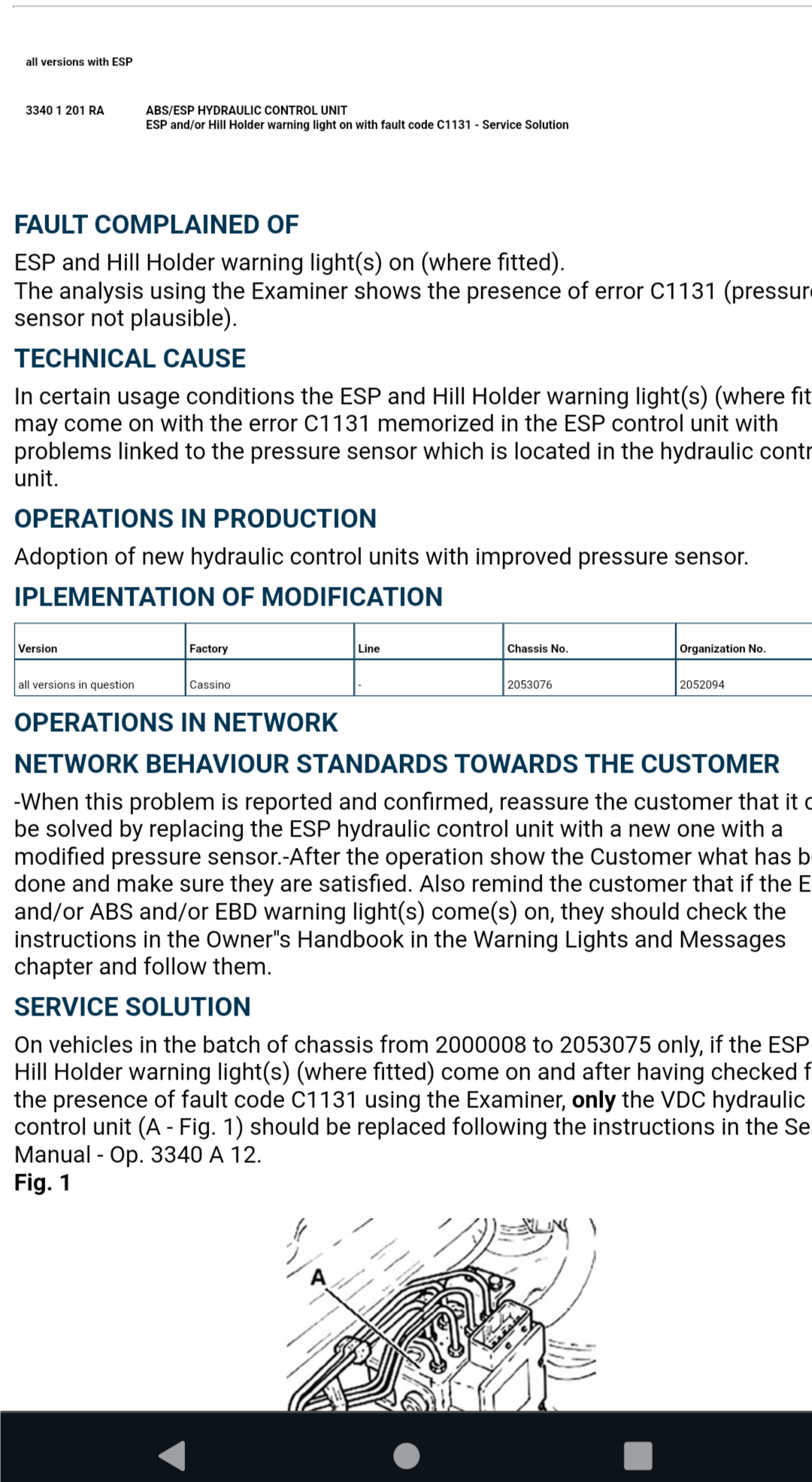

I am currently dealing with the fault code C1131 Pressure Sensor Intermittent Fault, aswell as C1117 Steering Angle Sensor (NGE).
Is it wise to replace both parts and hope this fixes the issue? They're quite expensive parts and both seem to be quite a pain to fix.
I have looked and all the fuses, aswell as checked the ABS Pumps connector and found no issues. Furthermore I have also replaced all ABS Sensors on the car, hoping that would fix my issue with the ABS, but to no awail. The Steering Angle Sensor is giving the right angle readings when connected and turning the wheel, so I am confused as to why it is giving me this fault (the car just got a wheel allignment and the code was present before too).
