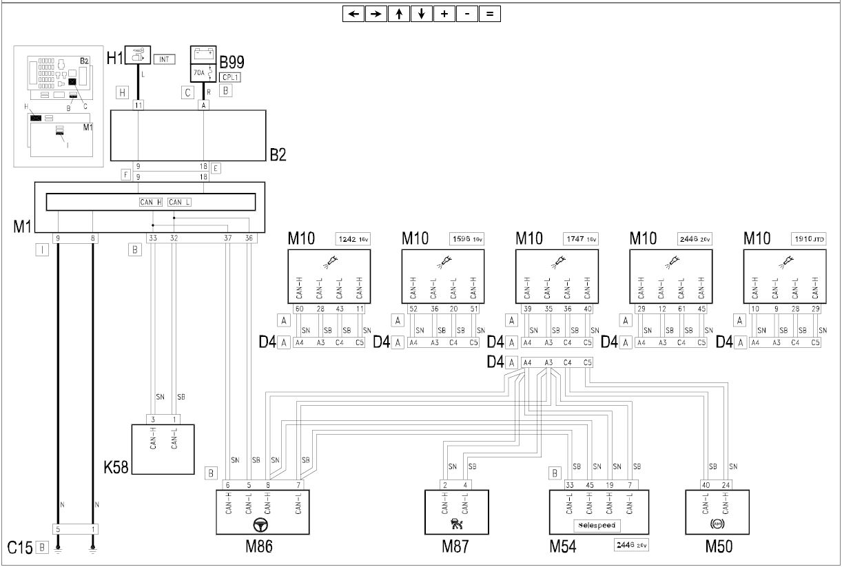

This is the CAN wiring diagram.
Looks like the CAN wires from the ABS ECU (M50) go via the D4 connector to the Engine Management ECU (M10), then to the Electric Steering ECU (M86), then to the Body Computer (M1), then to the Instrument Panel (E50).

I have mapped out the pin connections:
Unit CAN L (pin) CAN H (pin)
ABS*ECU*(M50) 40 24
D4 connector C4 C5
Engine Management*ECU*(M10) 28 29
Engine Management*ECU*(M10) 9 10
D4 connector A3 A4
Electric Steering*ECU*(M86) 7 8
Electric Steering*ECU*(M86) 5 6
Body Computer (M1) 36 37
CAN A (pin) CAN B (pin)
Body Computer (M1) 6 5
Instrument Panel (E50) 4 3
Side notr Info
Woops....sorry... lets try that again....
Can you please help with the pin-out and location of:
-M1 Body Computer?
-M86 Electric Steering?
Plus help to confirm that the diagrams I have found for the others and attached, are correct?
Again your help and time is very much appreciated(y)
My mapping- as per your sequence Davren....
ABS*ECU*(M50) 40 24
D4 connector C4 C5
D4 connector A3 A4

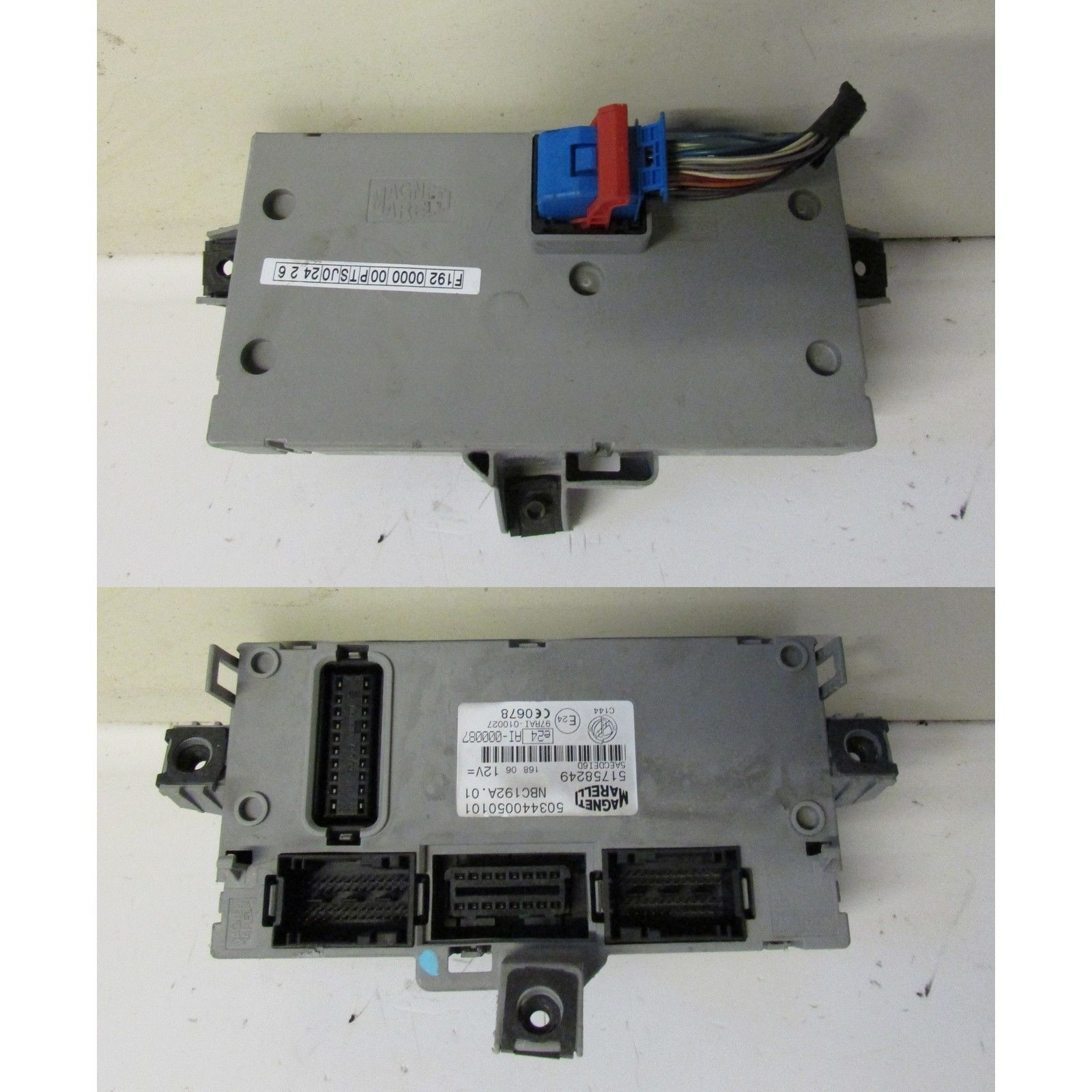

Body Computer (M1) is the grey box attached to the back of the dashboard fuse box.

No... That's one of the fuse box connectors.
The BC connectors are the black and blue connectors with red locking clips at the bottom in your picture, and there's another blue with red locking clip at the back of the BC.

ahhhh..... I checked the wrong connector before then:eek: thanks for putting me in the right direction (again the "picture-is-worth-a-thousand-words" (y))
I presume I have to remove the "fuse panel/body computer" to get to the connector at the back?
