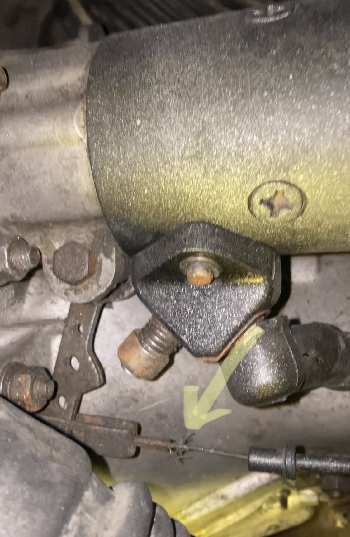

Thanks for the reply. You’re correct, I do know the starting procedure. The “button” I’m referring to is back on the starter in the engine bay. I’m sure by your response I’m using the incorrect term for it. I actually pressed it on accident the first time when I was fumbling around for the cable to see if it was connected properly. check out the pic. Thanks again.

Yup, button is as good a description as any! So let's rationalise your problem; is your engine actually cranking when you pull the lever? or, are the lights on the instrument cluster just going dim? If it is the latter, the first thing that I would suggest that you check is that the battery IS fully charged and then that the terminals are making a good connection--it might be worthwhile taking them off, cleaning them and then refitting them properly.
If the engine IS cranking correctly, remove the rearmost (actually the 'front' of the engine) spark-plug, earth it out on the engine and ask somebody to crank the engine (with the ignition on)--have you got a spark? Let's go from there.
Sounds like the cable is only barely short enough, so that the lever on the starter body only pushes the button to the point of making electrical contact some of the time.
Most likely cause of the problem isn't the actual length of the cable, but that the cable is not properly anchored under the car on the way to the starter. It should be anchored under the car in a way that keeps the attachment to the lever on the motor in enough tension that a pull on the lever in front causes good solid electrical contact on the "button" on the starter.

With respect to 'Popitinpete', if the engine is cranking when you pull the lever (between the seats) then I would say that the cable adjustment is OK---leave as is. The cable CAN be adjusted to a small degree by moving the cable attachment onto a lower hole on the button's operating lever. But be careful, if you make it too tight there is a chance that engine movement will engage the starter. If the engine IS being cranked with the starter-lever, we need to look at other causes. let's try and eliminate one thing at a time.

Ok, we have spark, I checked that. I think this one might be the starter cable not pulling enough to stay connected. It is frayed bad as you can see in the photo. I have a new one and I’d like to install it so I can move on from the starter cable in the future. Anyone install one of these? I’m guessing connect to the lever in the cab first, and then fish it back through the tunnel? Thanks
I can't remember for sure, but I'm pretty sure that the best way to do it is to push it from under the car forward through the tunnel to reach the hand lever.
Ok, I ended up just adjusting the current installed cable to check, and she fired up. Thanks for all the help everyone! I’ll consider this case closed. 🙏🏻🙏🏻🙏🏻
