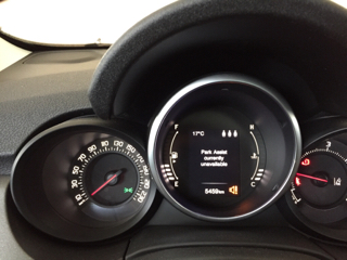

Took my car in this morning and indeed, it did take about an hour. Dealer told me it was to do with the "radio" but as I didn't have any problems and can't see any difference I'm still none the wiser. However, at least the car is "up to date".
The update solved this fault warning for me plus one saying: Sound system unavailable. So now I got a Fiat without any fault warnings?
