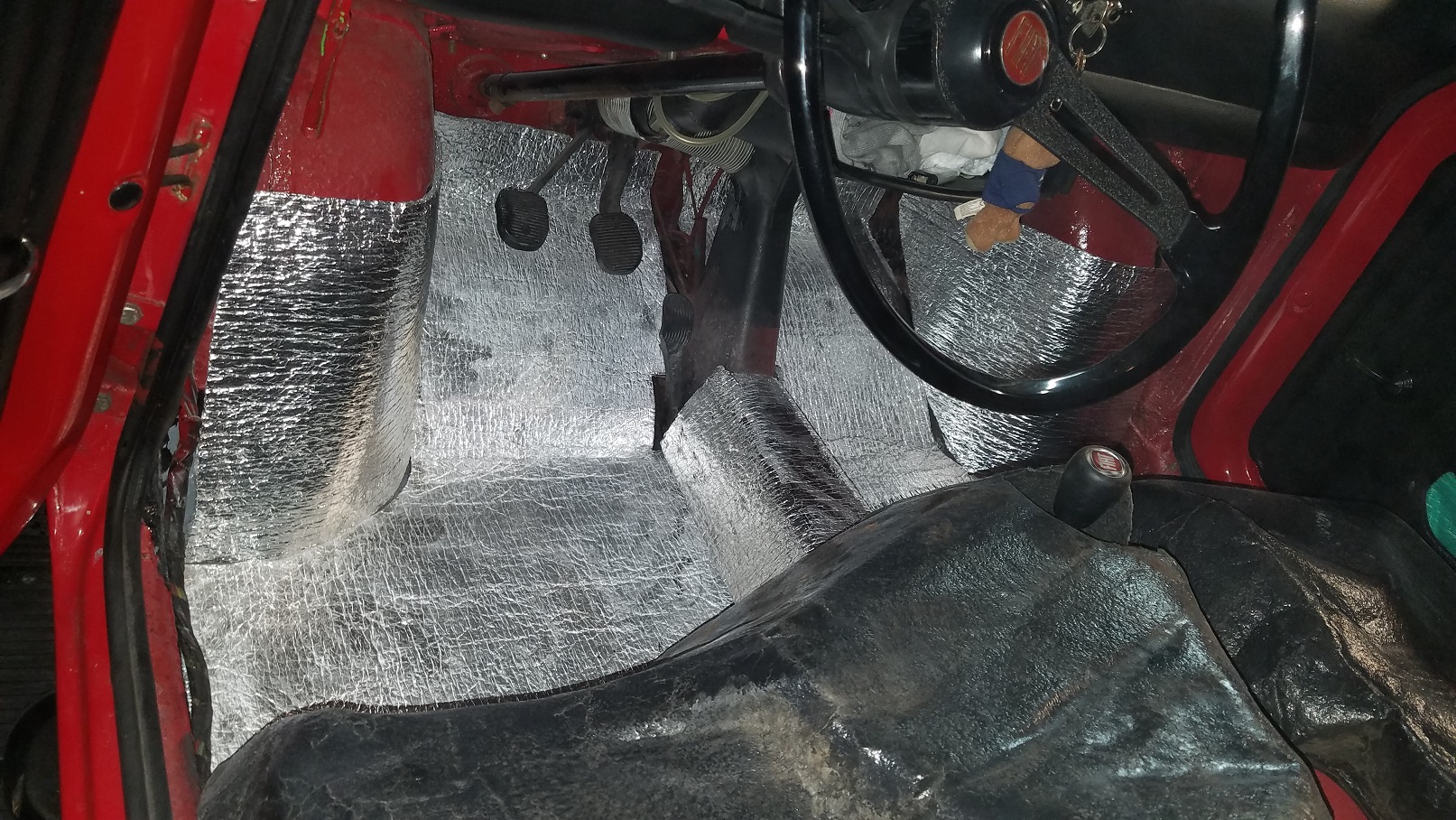

The issue I had with the felt one was any water leaks soak into the felt and then sit and create a rust trap.
Any thoughts on these things and what they do?
It would look like the water might sit on top and preferentially soak into the carpet, so being a good thing for slowing rust
I wouldn’t want to fix them too firmly in case I need to check something underneath though

I found that the combination of aluminum type insulation with 5-6mm foam on top works great to reduce heat and some rackety vibrations and noises. You still hear plenty of engine without road and gearbox/transaxle noise. Both should be nonabsorbent closed cell materials. If you know the track of water leak, you can shape the insulation in a way that it acts like a bucket. You might need to glue few spots to the sidewalls like an inner rocker or wherever the water runs down from and it will puddle up in there, under the carpet or original rubber mats if that's what you prefer. Metal stays dry(y)
