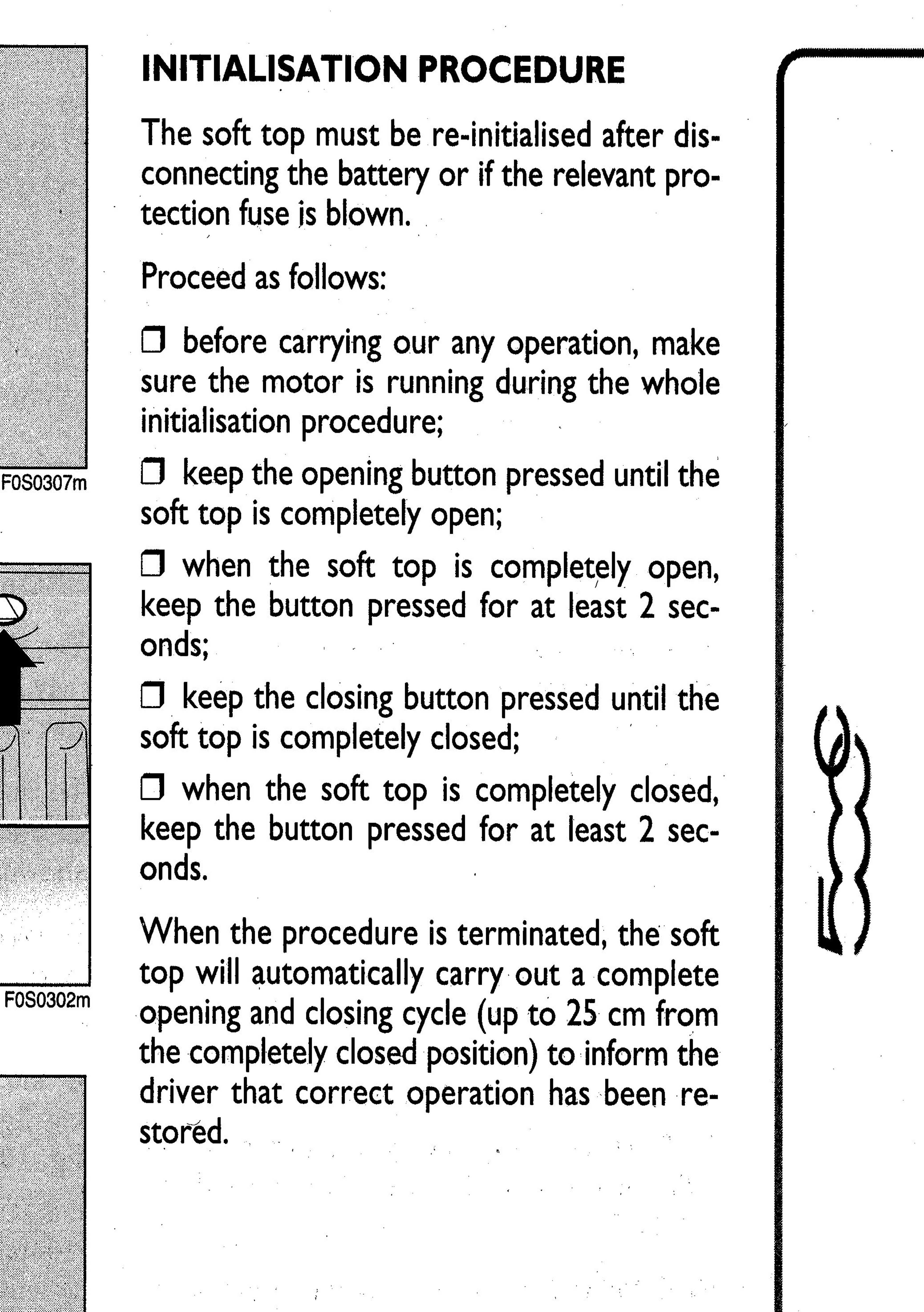

The very first thing I would do though is run the roof initialization procedure. If the roof controller has lost it's 'memory' and doesn't know where the roof is it won't allow you to open the boot at all.
Worked perfectly thanks piccolo. No idea why it’s done that….as the battery hasn’t been disconnected. But hey ho… means I don’t quite have to spend 50quid on the hatch fix kit just yet.👍🏼👍🏼
Cheers. Might be worth getting your battery checked if it's an older one. Also can happen if the roof jams momentarily so you could try treating the sliding parts with a dry lubricant.
