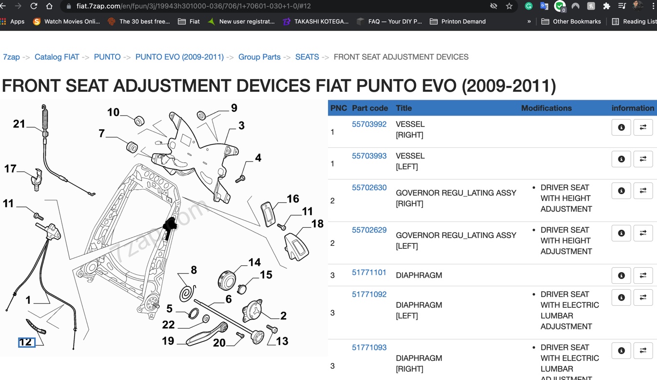

I have finally found a site online that gives Fiat part numbers - See attached screenshot (can't post a URL but the attached screenshot shows it if you want to view the page) ;)
The part number for the release cables seem to be 55703992 & 55703993
Labelled Item No 1 - These are the cables I think I need.
Assuming they are broken and not simply detached..
My questions are these:
Do I need any of these below too?
Part labelled No 21 on the diagram
part numbers are
55701767 & 55702371 - Rod Right & Left.
Is this part of the mechanism?
Part number 14560187 - Labelled No 12 -
Just called " strap" - do I need this? and whats it for?
Finally, will I need to remove the side airbags from the seat to get to anything or make the job easier?
Can't find anything online that shows exactly how the seat works and what each of the parts does. Anyone with good knowledge of these issues would be very helpful to me.

You can see how to disassemble the seats if you watch the video I made on installing heated seat pads.
The bit that releases the seat to slide is very fiddly and works on one of my seats and not on the other, it’s usually down to the steal cable that releases the catch stretching, I’m sure it can be fixed without replacing parts, I just never had the patients to play about with it.
Edit: yes I believe it is the part labelled 21 on that diagram, the cables from the catch go down to the hinges that release to allow the seat to bend forward, then the part 21 attaches to that mechanism and carries the movement down to an arm that pushes the handle down to release the seat to slide forward, there are a lot of moving parts and with age it gets a bit sloppy
Thank you, i suspected 21 connected with the opposite side of the seat somehow.
