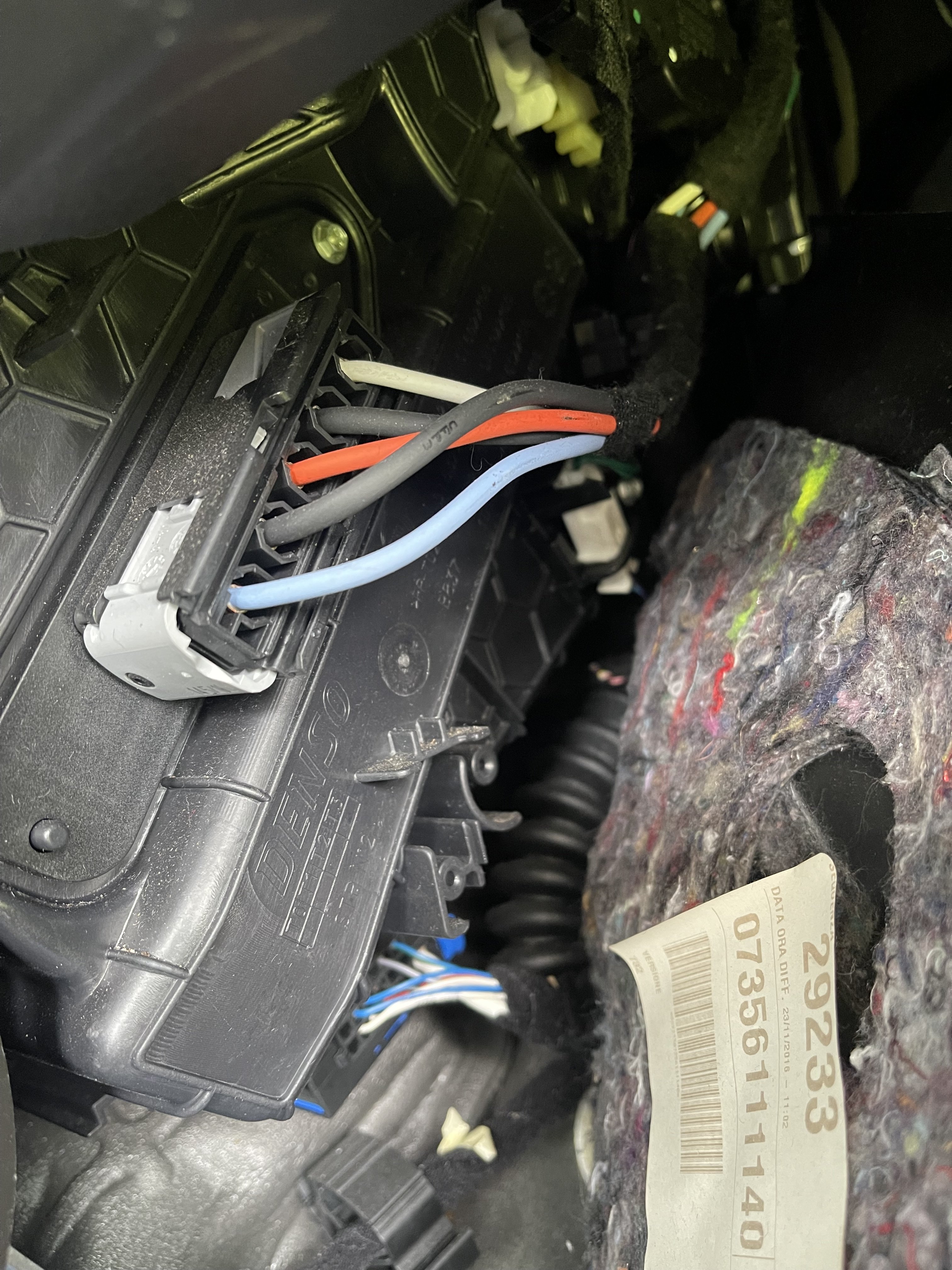

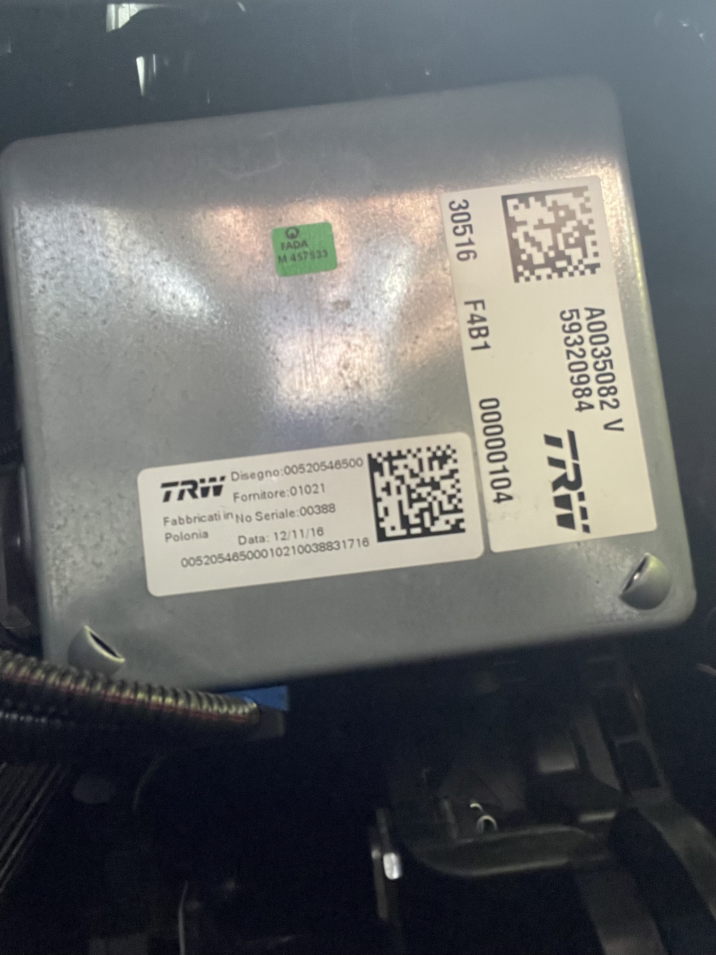

First photo is what’s under steering column and second photo is what’s on left of column. Are either of these the fuse panel?
