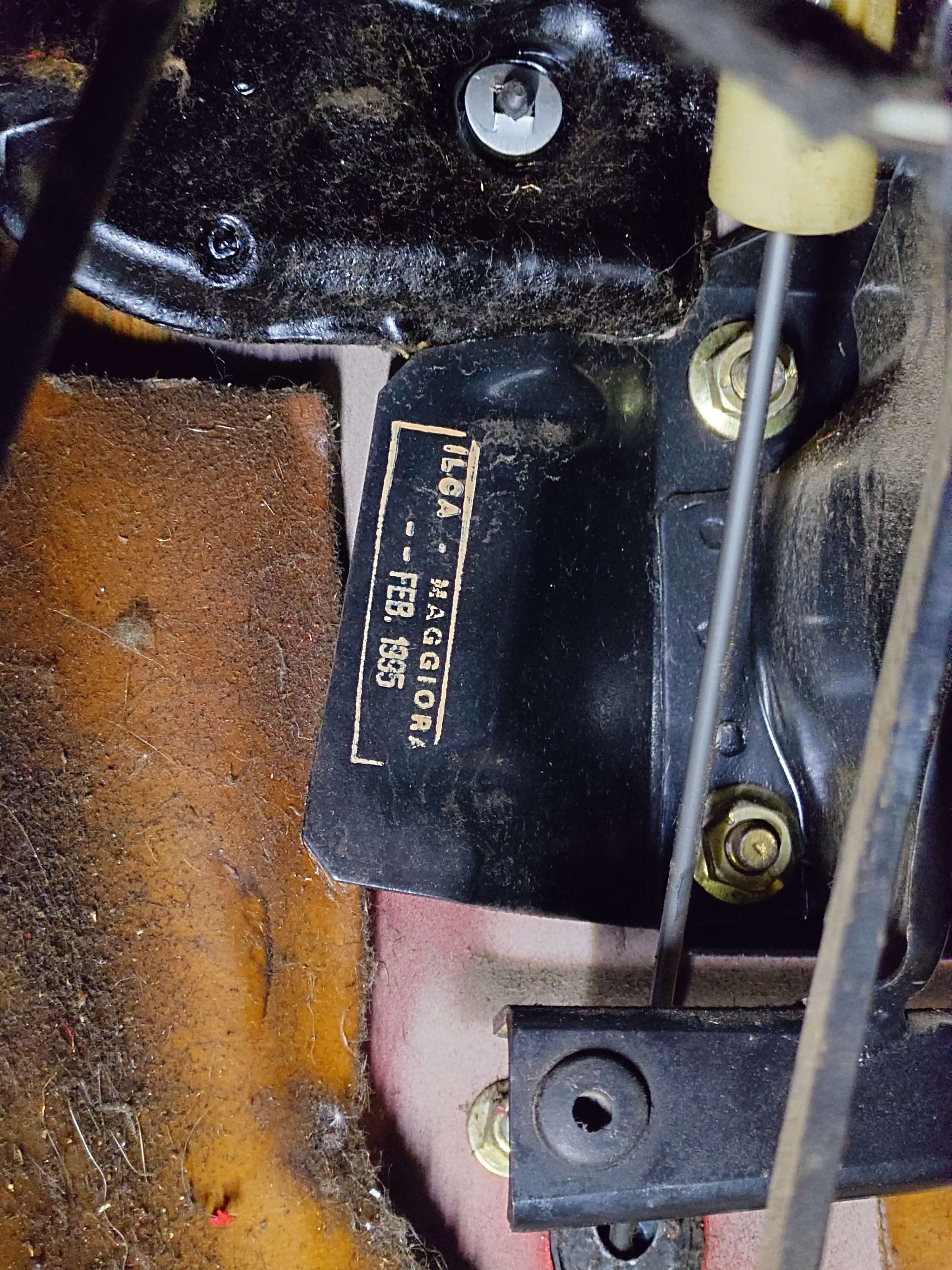

So that is what I got. A red, EU-registered, Aircon-equipped car, first registered on the 28th of April 1995 according to the RDW, so a rather early car, last plated as 25-LZ-VH, currently unregistered.

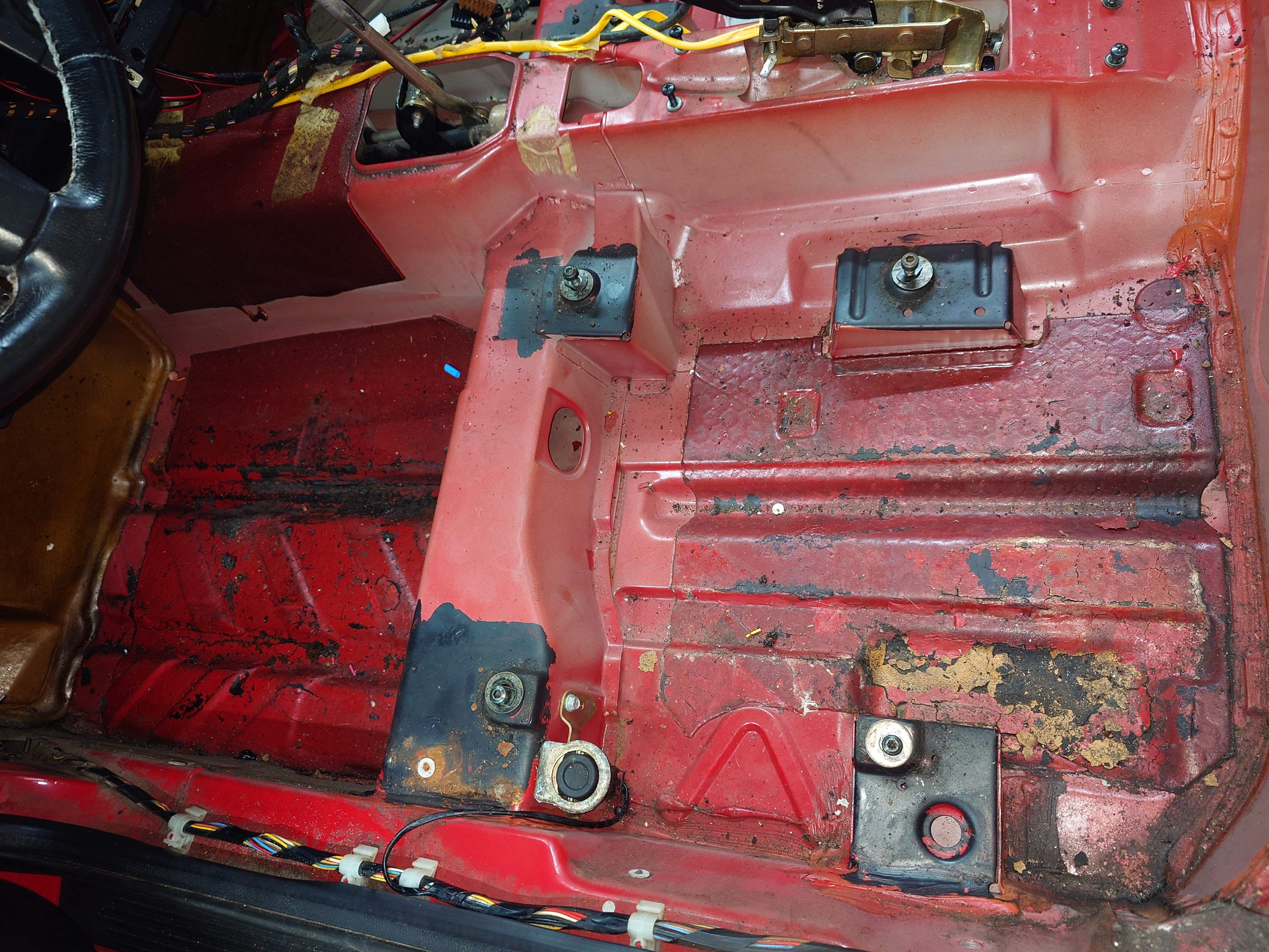

Rust holes in the floor
- I knew of these, they were supposed to be welded up by the "specialist garage" I bought the car from as the agreement we reached when I went to view the car about a month before buying it was "fix the rust holes and give it an APK".
They only fixed the outer sill, but left gaping holes on the underside and gave that car what I am convinced is a bent APK. I only saw this when I went to pick up the car, and the money had already exchanged hands as I was in a race against the clock to get the export papers done the same day. At that point however it would have been far more costly for me argue with them to fix it properly, cancel the ferry, rebook flights, time off, etc. to come pick it up another time so in the end I've taken the loss and fix it myself.

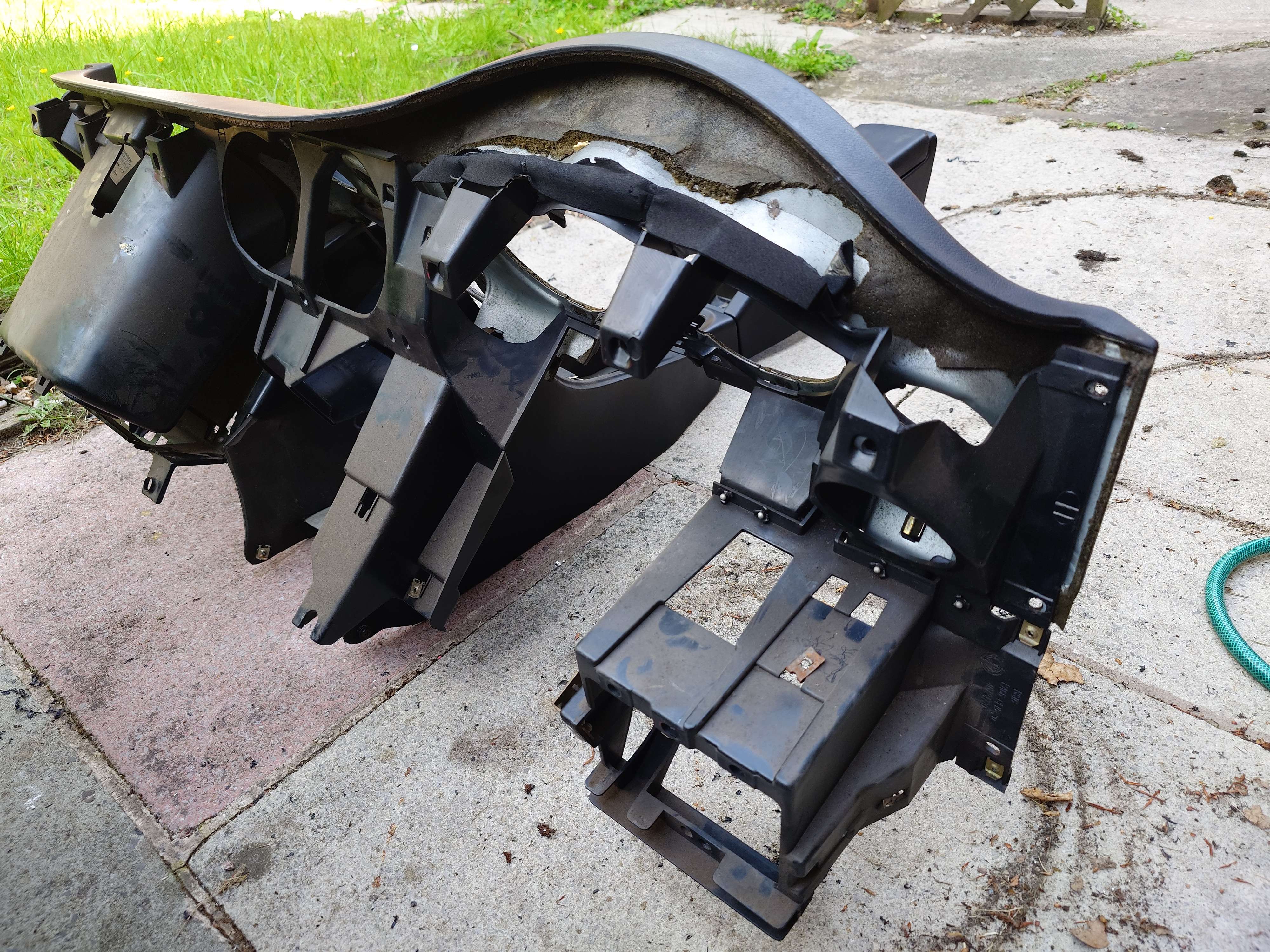

I've completely stripped the interior of the rubberised floor mat, and stripped the bitumen sound deadening, still need to take the dashboard out and get the wiring out of the way to prevent welding sparks from destroying anything. The fabrication work from what I can see is fairly straight forward, and should not take too long to do once everything is prepped.
Once welded, the entire interior floor will be stripped to bare metal, I will be drilling a few extra drainage holes, Bilt-Hamber Electrox anti-corrosion primer will be used as a base coat then the entire interior floor will be covered with a rubberised high-impact bedliner, most likely Raptor as that's a common readily available brand here in the UK and my off-roader friends constantly sing it's praises. I might get some aluminium kick-plates made for the floor so I can have a flat surface for my feet. Once everything is painted, bedlined, seam-sealed etc. it will be heavily Lanoguarded in all the cavities and underside as I've been quite happy with the results of that on my WRX.

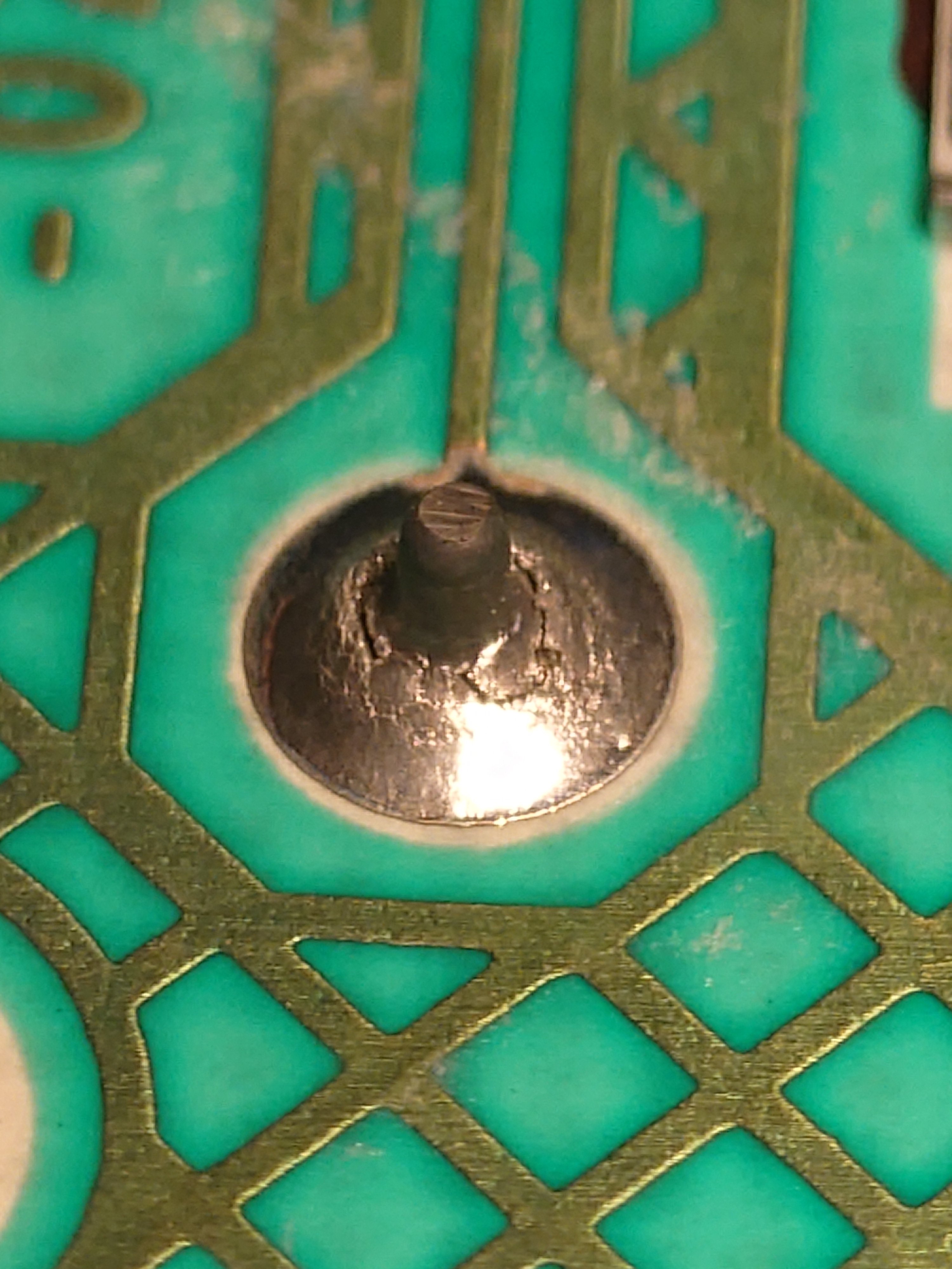

Odometer was broken - Noticed this while driving to Maastricht, after some advice from Brian Poole of the UK Barchetta club, the little peg was indeed jumped from it's position. I've reseated it now and it should work again, but can't test yet until the car is registered and legal to drive.
Speedometer is broken - Speedometer would go up to 80km/h and just sit there, and also the speed below 80 would not be accurate. Again on Brian's advice, I've found the solder on the back of PCB is cracked. These will be resoldered once I find someone with a steady enough hand to do it.
Thermostat is stuck fully open - Noticed it on the roadtrip back home, brand new thermostat and full silicone coolant hose kit waiting to be installed on the car.
Leaking Heater Core - New heater core acquired and waiting to be installed once the dashboard is out.

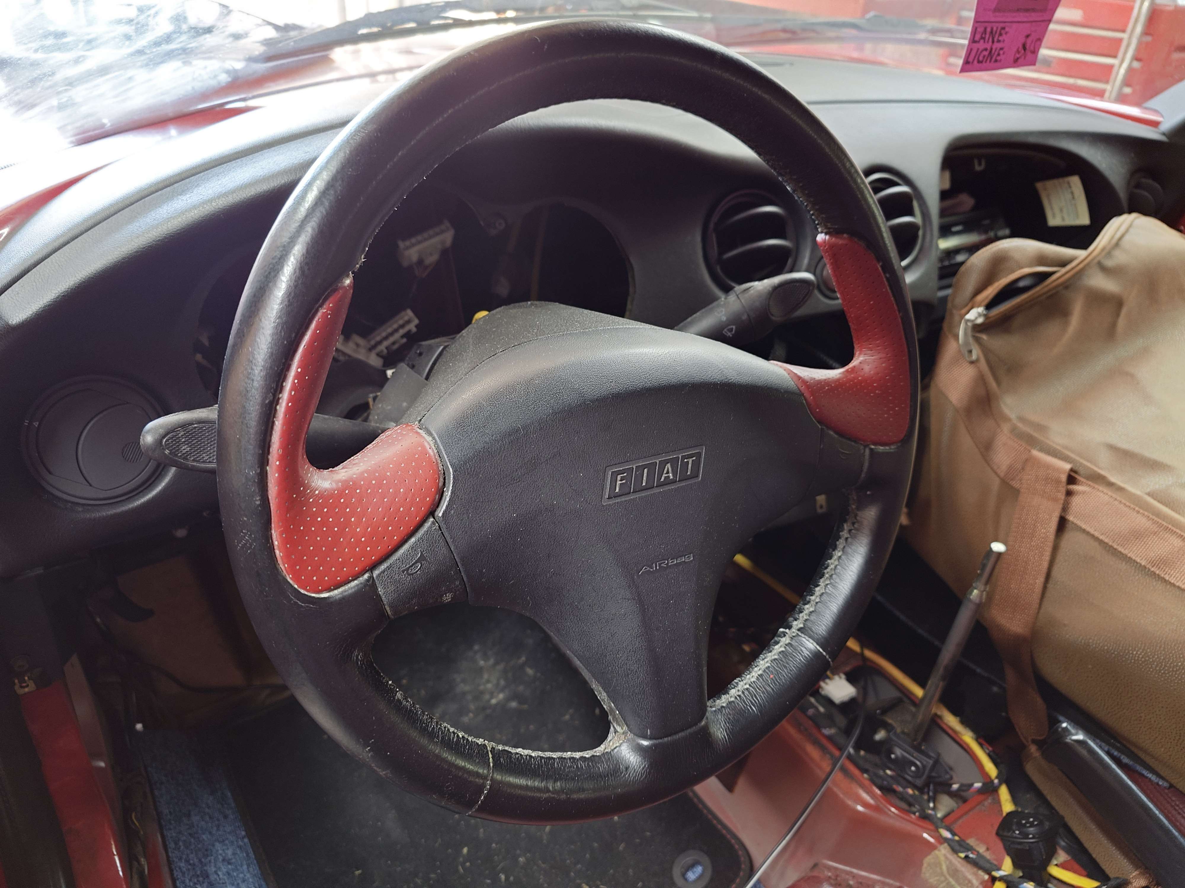

Airbag light comes on, sometimes. - Aware this is a common issue, airbag will not be a concern as planning on a Nardi steering wheel so the airbag is getting chucked into the (parts) bin, only to be reinstalled if needed for inspections.

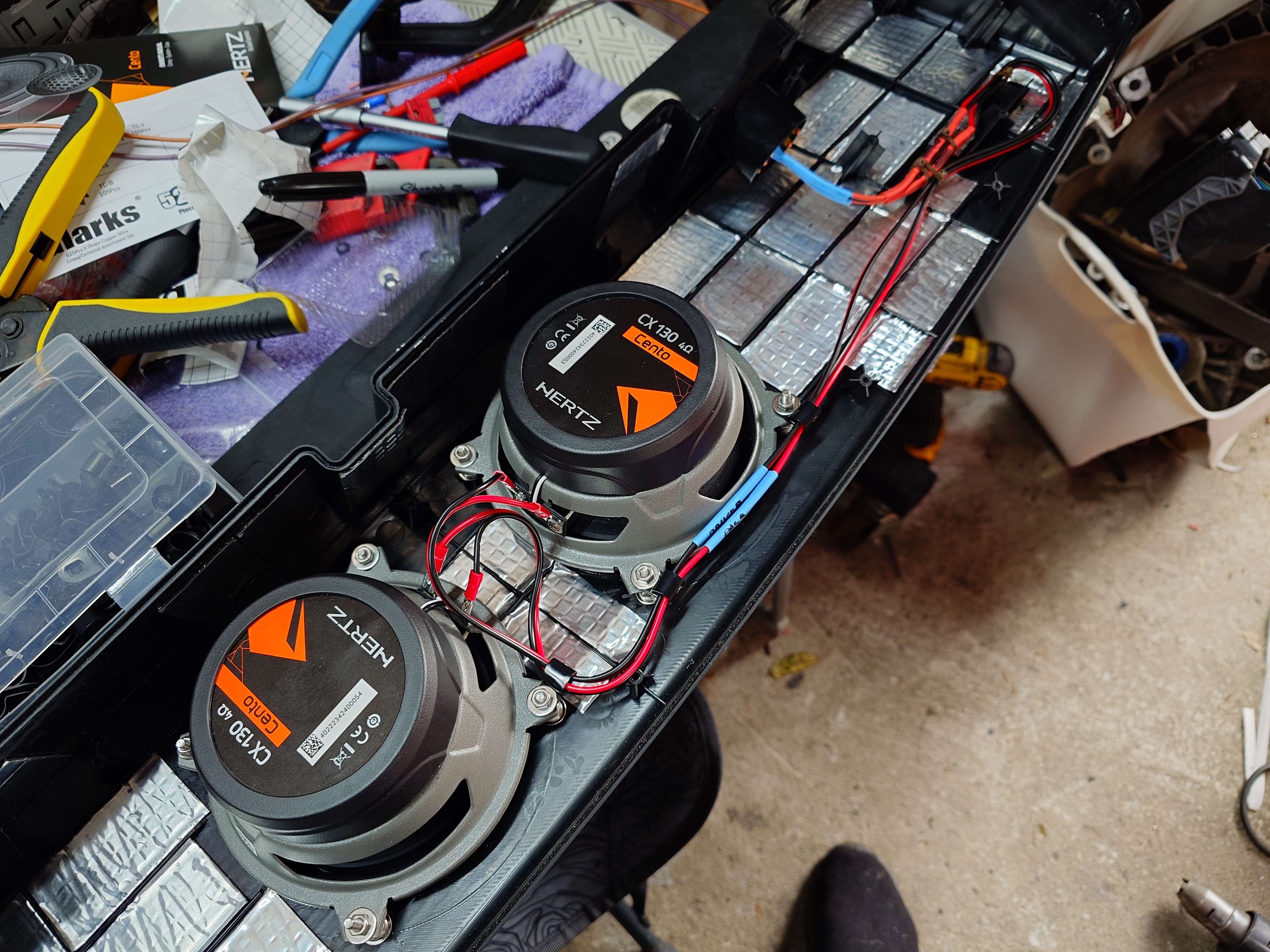

Radio wiring was an absolute mess - Whoever butchered it deserves a medal. I've spent a good amount of time un-butchering it. Decided rather than trying to get a switched live signal from the ignition, to instead just wire in a button to turn the radio on/off. Radio has also been relocated to the glovebox in order to allow me to hide it away and lock it to make it not as tempting for entrepreneurial individuals to help themselves to a five-fingered discount if I leave the top down while parked somewhere. I might re-relocate it to the armrest.

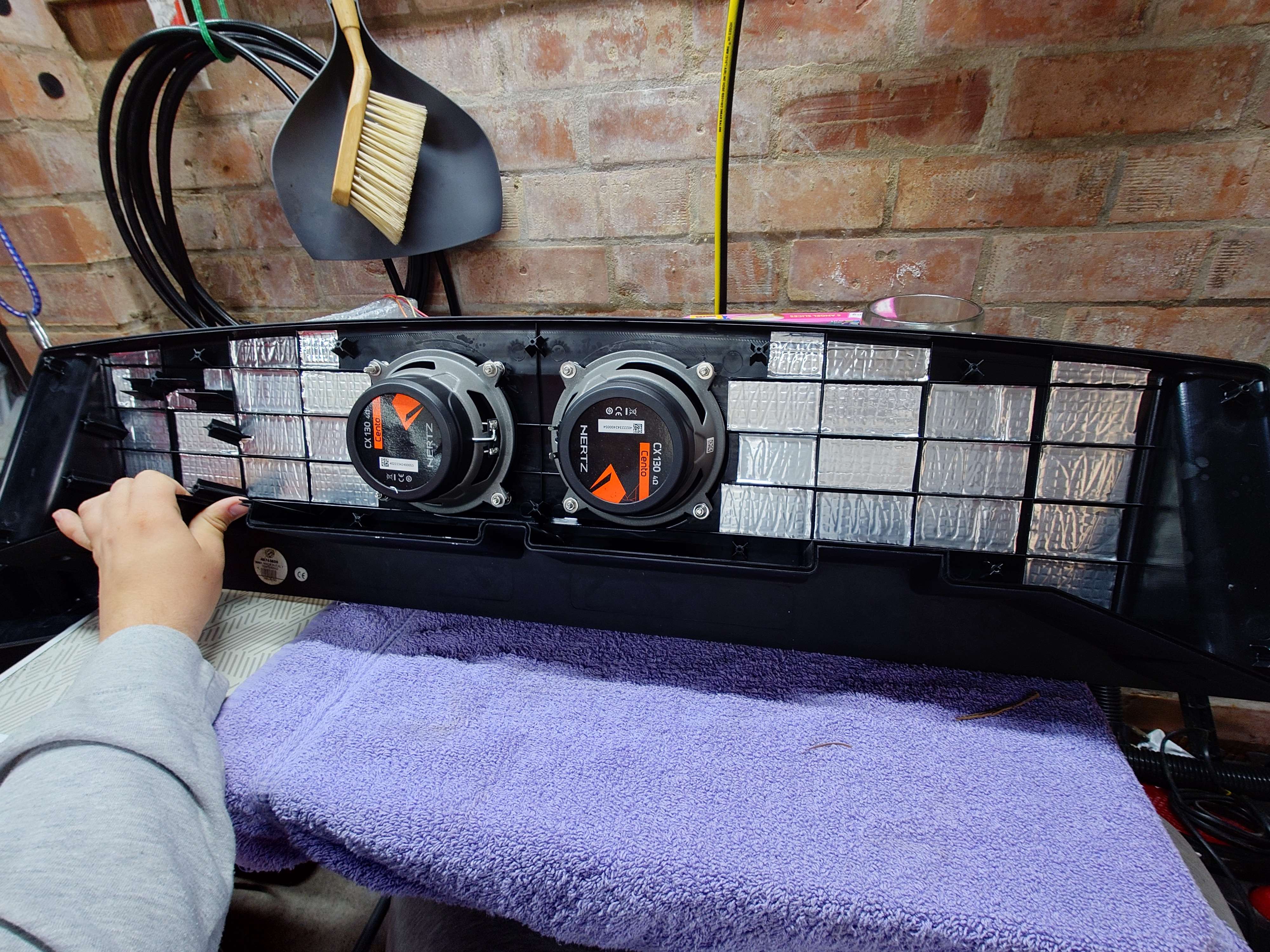

Speakers were absolutely shot - Replaced with Hertz Uno tweeters and mid-woofers mounted on custom 3D-printed adapter rings in the factory positions in the doors and footwell. When rewiring the radio I've also wired in provisions for an extra set of rear speakers in case I manage to get my hands on a factory subwoofer enclosure or end up making my own.

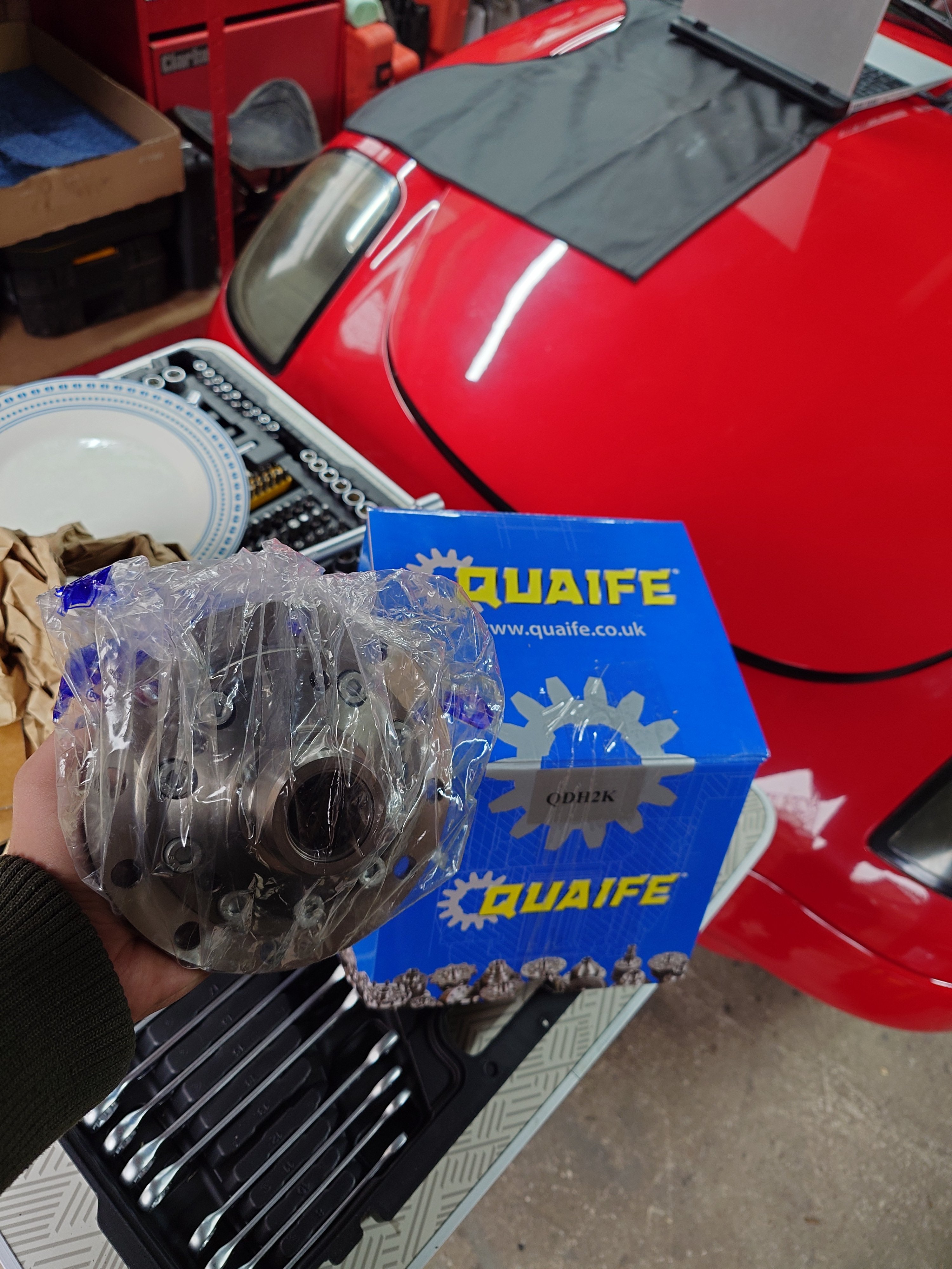

Quaife LSD
- Does it need it? At 130hp, no. Did I randomly see it while looking for LSDs for my WRX and immediately buy it? Yes.
I've also bought a 2nd gearbox that is much lower mileage than mine to strip, rebuild and put the LSD into.

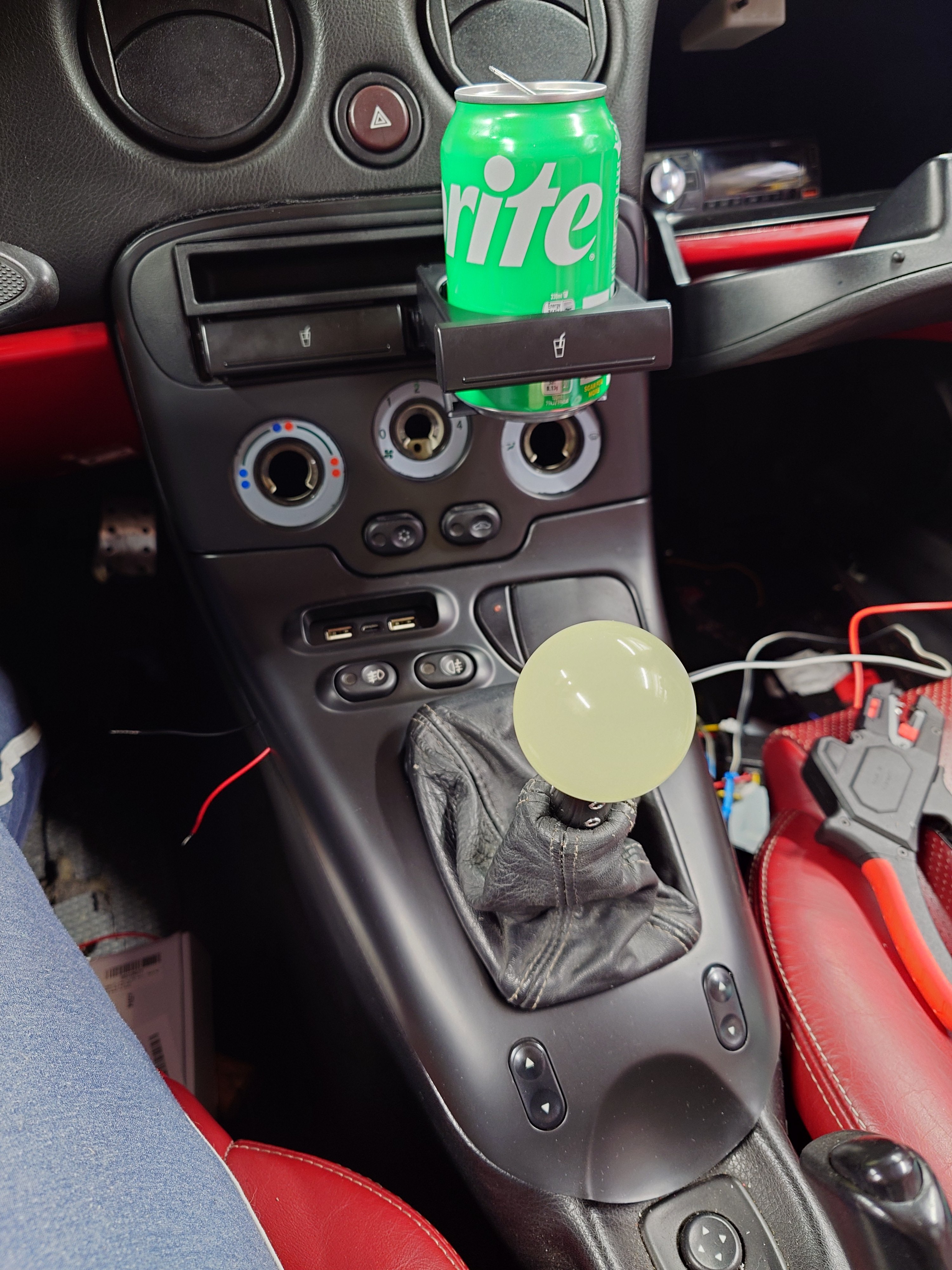

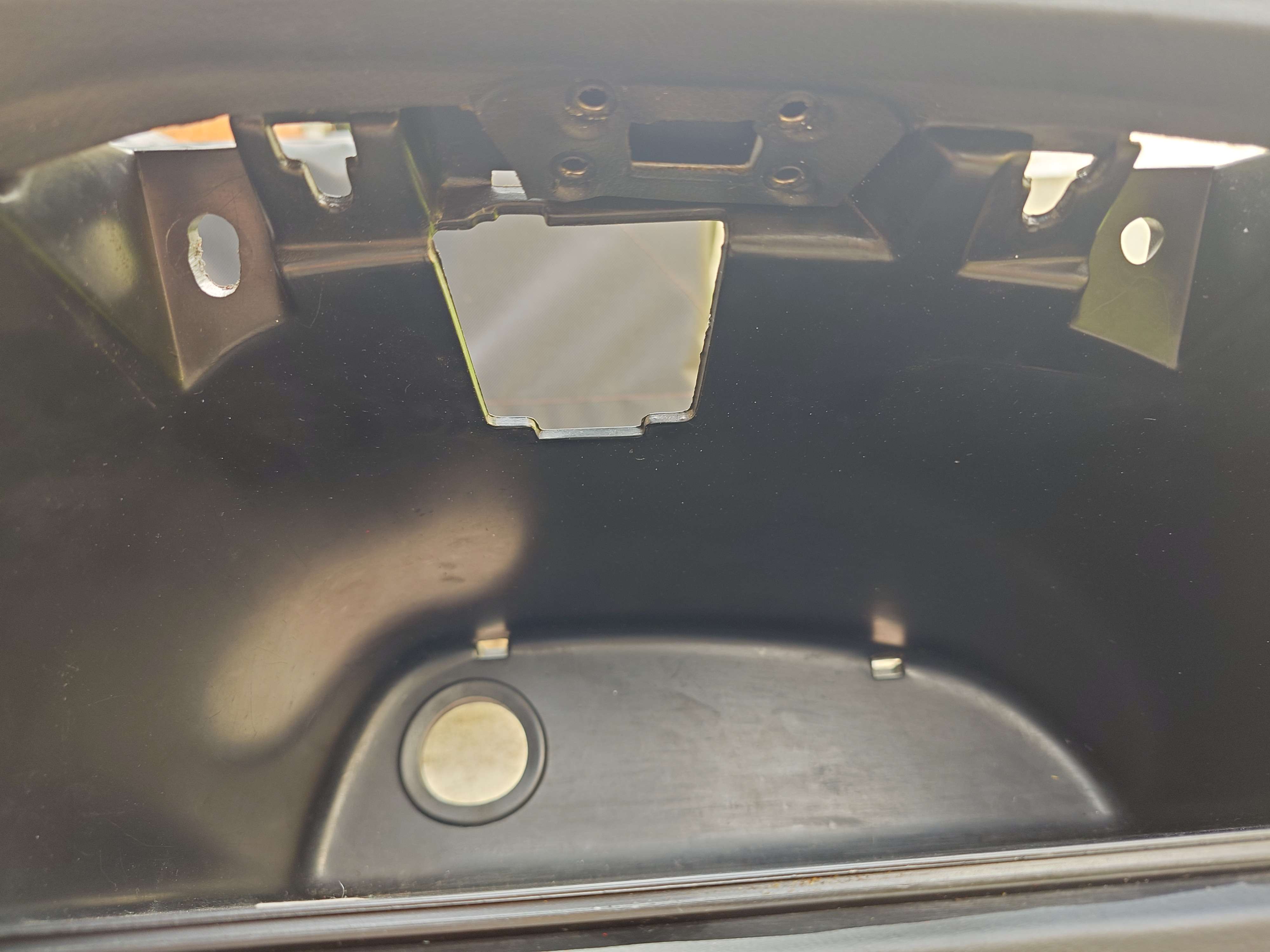

Cupholders - I have added cupholders. There is a picture. This is my greatest achievement. My biggest gripe with european cars of the era is the lack of cupholders, so I've modelled up a DIN-sized insert to 3D-print and stick into what was the radio hole, and use Audi A6 cupholders. I have since altered the design to have just a single cupholder and a 52mm gauge hole to mount a CANchecked MFD gauge for use with a standalone ECU to display various engine parameters like AFR, oil pressure, oil temp, water temp. I have yet to print this out.

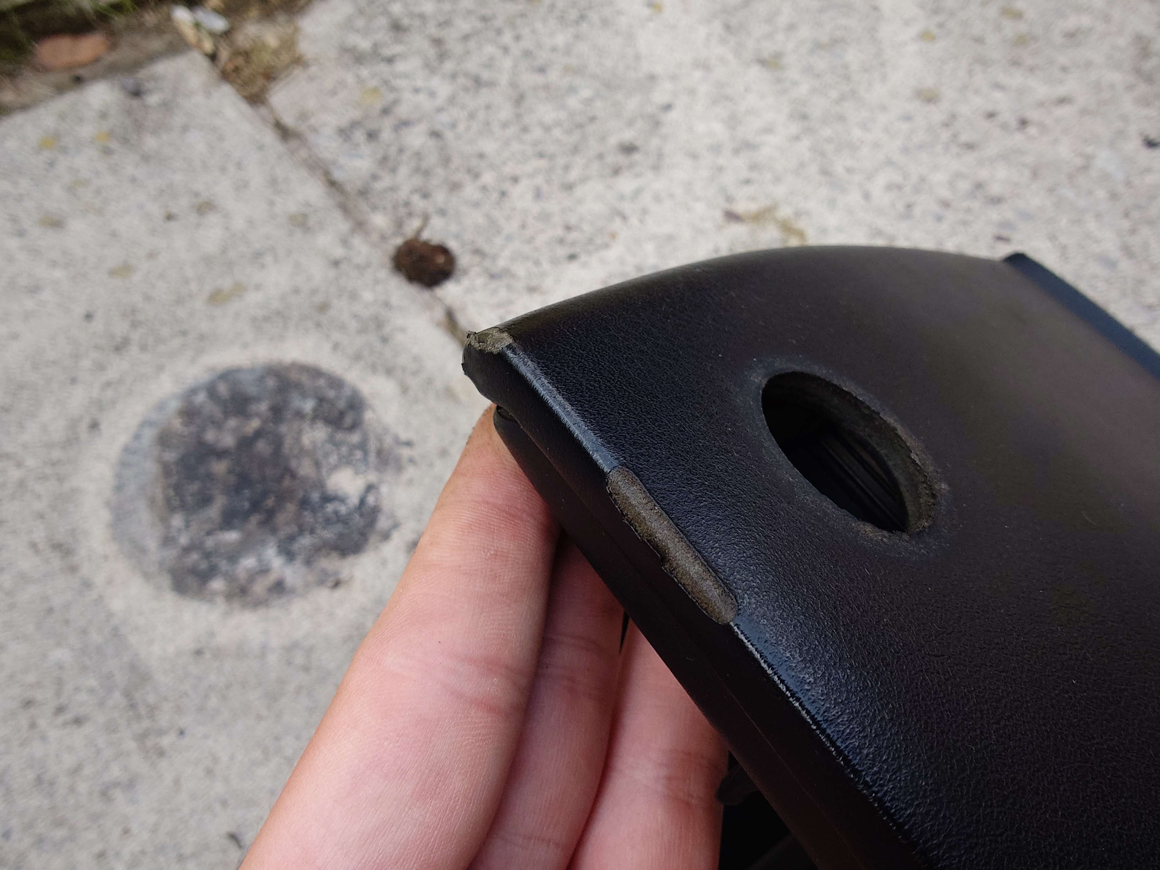

Since I bought the car the passenger door interior lock button never worked and was stuck in one position.
Today I had to take a bit more of the interior apart as I've sold the seats and am preparing those to be collected and decided to take the interior door handles and door cards off as well to list for sale and finally got a chance to see why the door lock button isn't working.
Plastic tab connecting to the mechanism was broken and someone decided to try and mend it using hot glue instead of getting a replacement. I suspected as much. Fortunately I do have a spare.

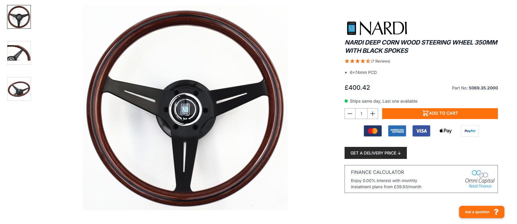

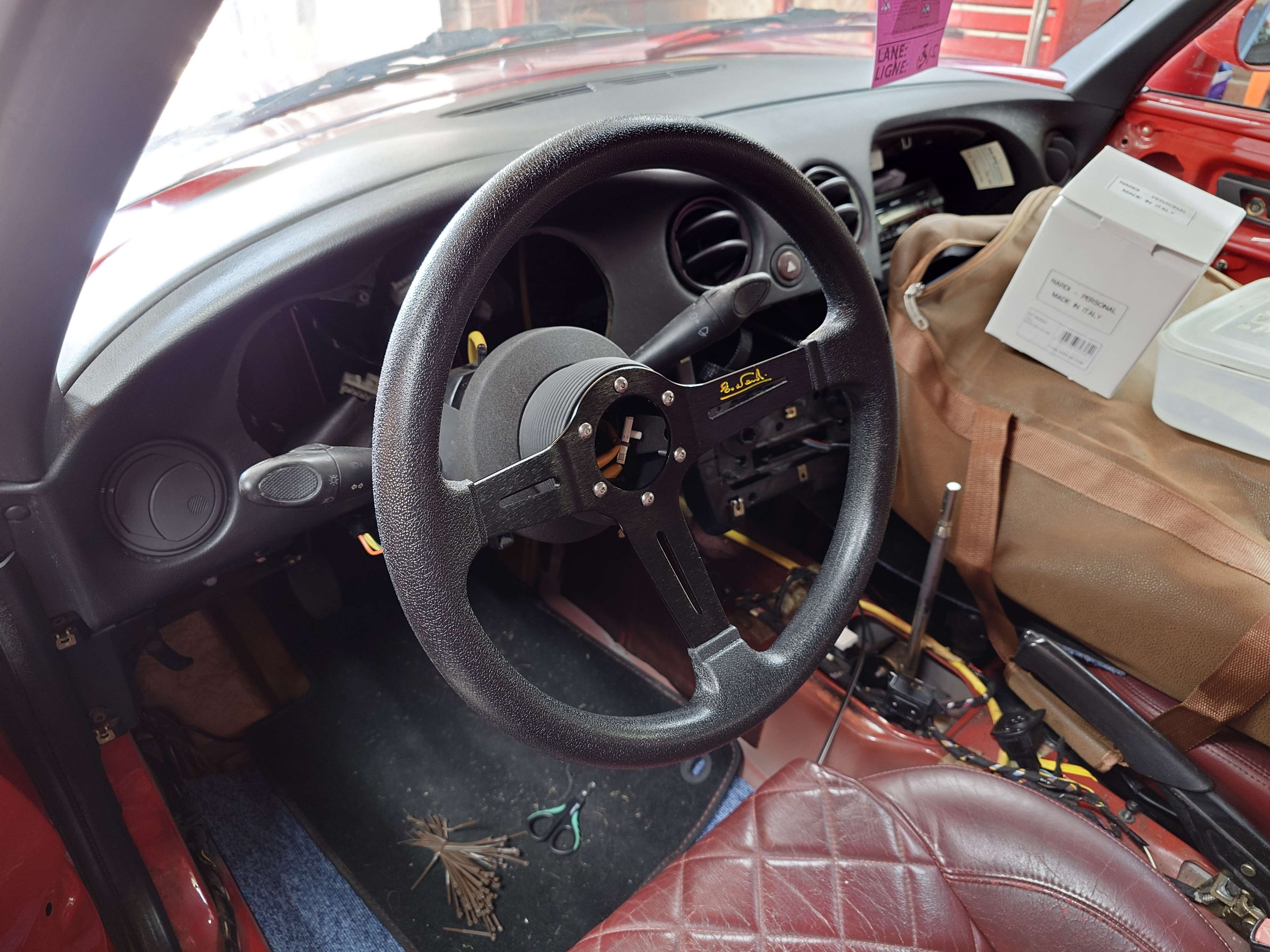

I'm on a bit of a shopping spree. Have decided to kit it out with Nardi goodies. Boss adapter kit and shifter knob have arrived, have yet to decide which steering wheel I want size-wise. Stock wheel seems to be about 350mm but feels too small to me, might upsize to a 360mm wheel, wood rimmed to match the knob and black center.

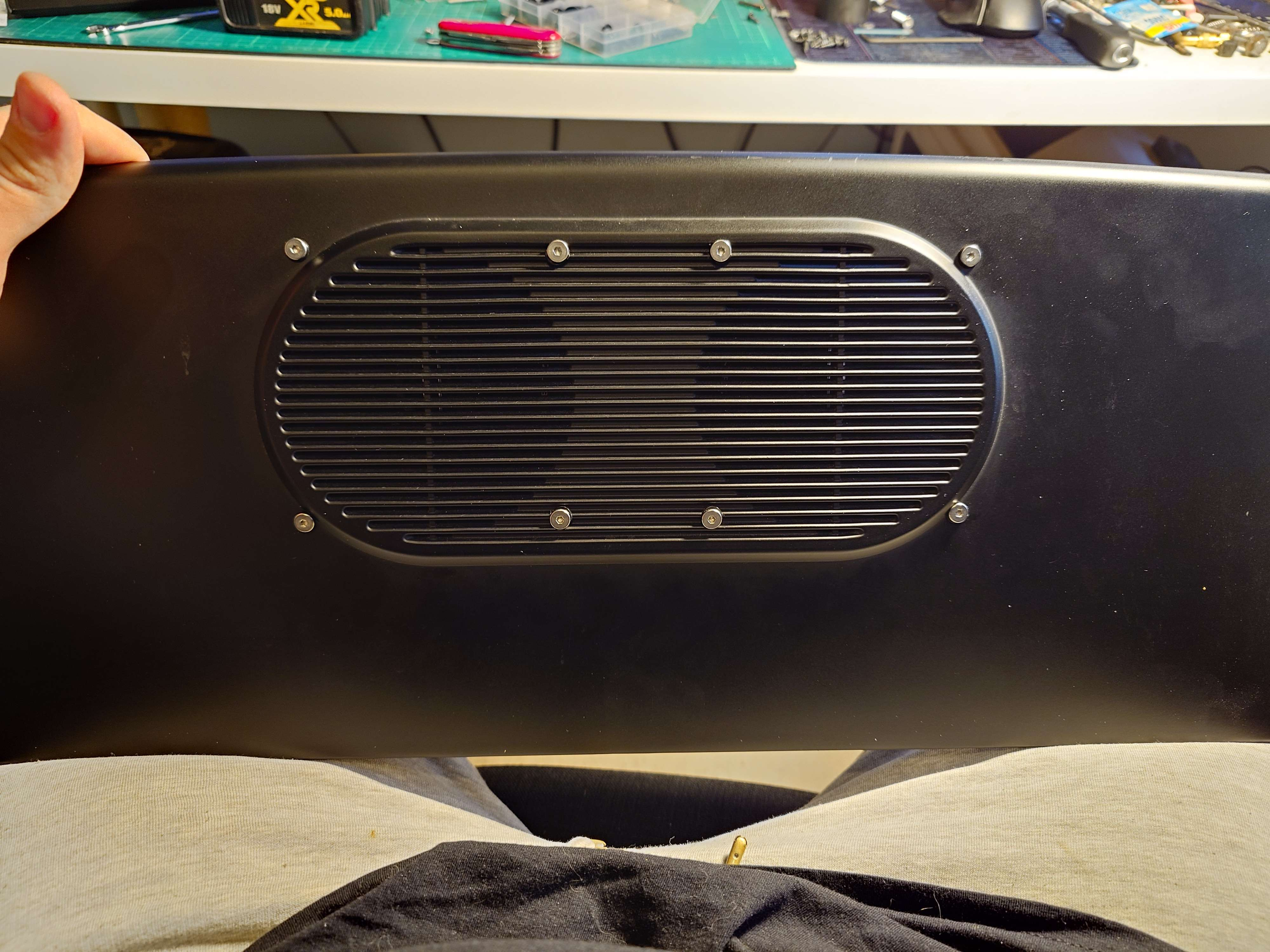

SUBWOOFER BOX!
I've managed to get my hands on a subwoofer box, and today I've taken it apart to check the condition of the wiring and speakers inside. Sadly I've found the mounting pegs for the speakers suffer from the same brittle plastic that a lot of other barchetta trims suffer from, and they were held in with what is at best one screw each as the rest had turned into dust and would have been a rattleing mess if I'd have just put it in the car as is. Good thing I checked before going through the effort of wiring it in.
Oh well, no biggie, improvise, adapt, overcome. I've decided I will be replacing the old subwoofers with some new coax midrange speakers from Hertz to match the footwell mids and tweeters I have, and while not ideal, I will have to drill some holes to be able to actually mount them in place. Reason being mainly the car did not have the subwoofer from factory, it's a very early car so does not even have the provisions for it, and as it only has the two front speakers, the radio outputs for rear speakers are unused and ready to be plugged into something.
I've taken down what was left of the mounting pegs, so that I have a flat-ish surface to work with, and when I have the new speakers I will be drilling holes to use a bolt and nylock nut combo to secure them in place, possibly with a few spacers and a bit of extra sound deadening on the inside of the casing.
Once I have the holes drilled, I'll be able to assess if there is enough material to go for some countersunk bolts so that the outer surface is all nice and flush. Will order both stainless and black anodised bolts to see what looks better.
Now. As for the original innards of the box. I don't know if they work or not, but if anyone in the UK wants them and is willing to come collect, they're free. I'm based south of Manchester just outside the M60, just message me if interested.
